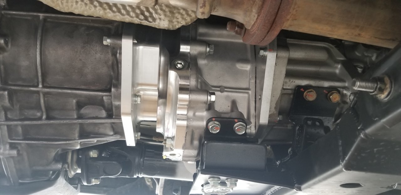

    That rear adapter is definitely an inchworm, their 2 piece clockable setup.

    Man I know that Inchworm plate is sweet for the clockablity but it seems like every one of them leaks. I remember back when NorcalPR or Hytenor on TTORA spent way too much time trying to chase down and understand what to block off and how to put the thing together without it leaking. Seems like it would have been much easier to just have a straight up option or a 10-15* option.

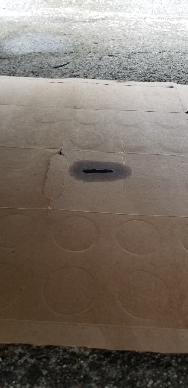

    Yep, it is a 2 piece. Just checked on it after a night and it did the same thing where it leaked just a bit then stopped. Wyatt told me it didnt leak while parked flat, so I'll take it for another run and park flat on the street later and see what happens. Best case scenario, it leaks a little bit a few times and stops, but I dont think it's likely. It's just weird how it stops after a while. I'll have to keep an eye on it. Here's the best pic of the unit I could get and the oil stain on cardboard. For reference, it's an unfolded soda box with the handle popped in the middle.

    "Didn't leak when parked flat", because all roads we take our trucks on are flat :rolleyes:. I'd be taking it back to that fellow to get re-sealed.

    That's likely going to happen. I scheduled a paintjob for my roof monday, so I wont be able to take it for about a week. I've got until then to run it around and try a few things.

    I’ve had tg complete duals with inchworm prerunner adapter (no longer made). Never had issues with leaks onto the ground using rtv or the black stuff. Now leaking between the transmission and transfer case into each other... another story. Just put a thick layer of sealant on both ends and don’t fill it for a day.
