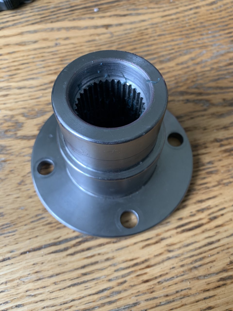

    Everything is wrapped up on the Atlas install other than getting the rear flange sorted out, the custom one still has play in it so AA is sending me a new triple drilled to see if that tightens everything up. If it does I’ll get a new flange on the drive shaft to match one of the patterns.

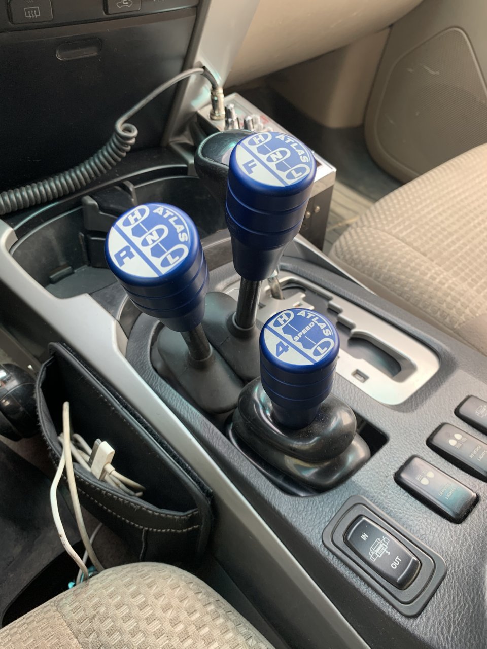

    Shifters came out great, I’ll do a custom boot eventually, but this setup isn’t too bad for now.

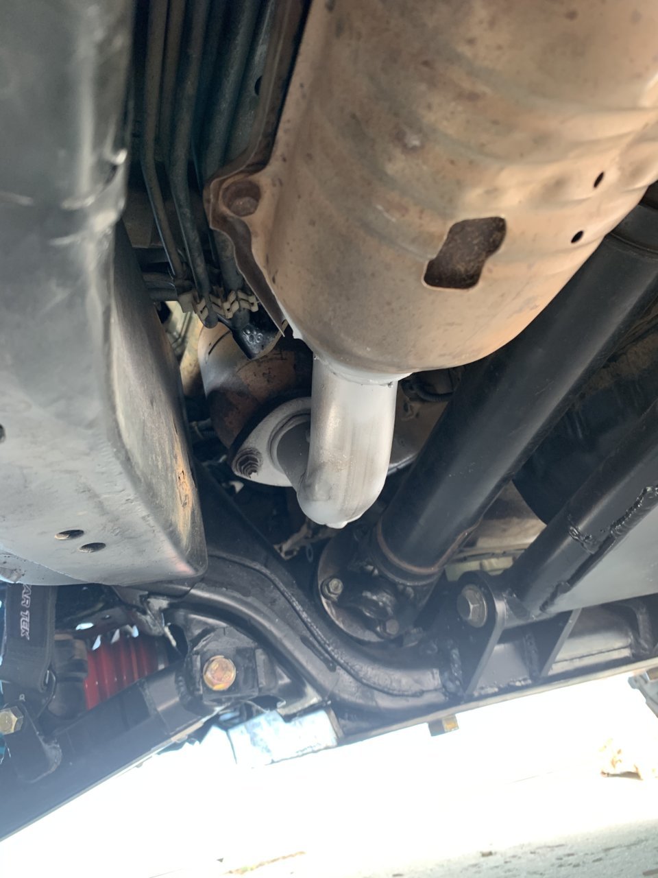

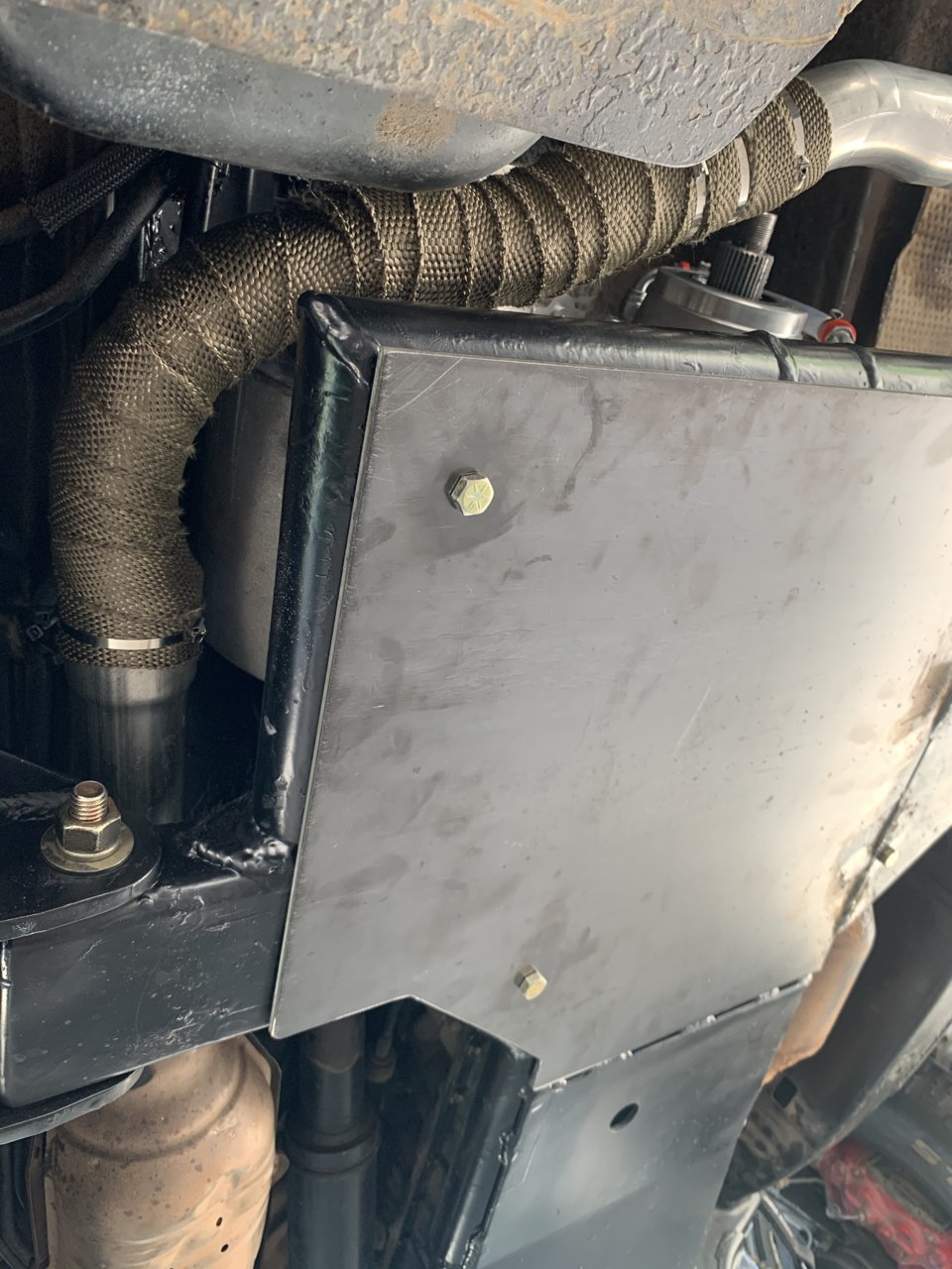

    Exhaust is done and I got the cat above the frame, now a fully flat belly to the gas tank.

    That looks awesome, great work! Looking forward to some trail pics

    The shift knobs are the best part!!

    Thanks, me too, haven't driven the damn thing since November, ready to :turtleride:
    I dig em too, you get 3% of your purchase back as "points" to use at AA so got those billet knobs for free with my points. A nice addition over the stock plastic ones.
