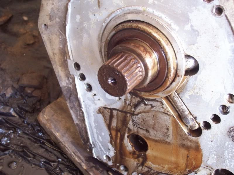

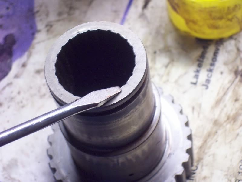

    I've only been loosely following this thread, but I had an Inchworm 2.28 setup with a stock chain case setup on an 02 Tundra (4.7 V8), and had two failures within a year. The first was the stock cause input getting stripped (fretting caused this as they say) which obviously caused the gear case output to strip and crack as well. 6 months after that was repaired/replaced, the low range gear in the gear drive case imploded. After these two events, I went back to just running a stock case and never looked back. This is why when I got my Tacoma and started building it, I went straight to Atlas.
    Though this was in a V8, I was never in the pedal all that much unless I really needed to be. The inside of the cases look disgusting, but that was from the "rust" from the fretting. The gear lube itself that was drained out was clean (aside from metal shavings).

    This is my biggest fear with the dual setups...the possibility of fretting and stripping does have me a little nervous as I did not use anti-seize. Found that little tidbit out after it was installed. If that lets go on the trail, you ain't go nowhere, fast. Needless to say I'm not too gung-ho about pulling it all out just to check.

    the fretting is more to do with machining tolerances than lack of anti seize on the splines. I’ve never heard of any fretting on a cv axle, side gear, differential flanges. Only cheaply made dual case adapters

    Same thing happened on my crawl box build back in 2008, I remember Allen wyatt and some other TTORA members figureing out what that happens. Turns out it happened on the early crawl boxes on mini trucks as well.
    I didnt feel so bad when I found out some jet engines have frettibg problem when I sat across from some engineers when I was working at an airline.
