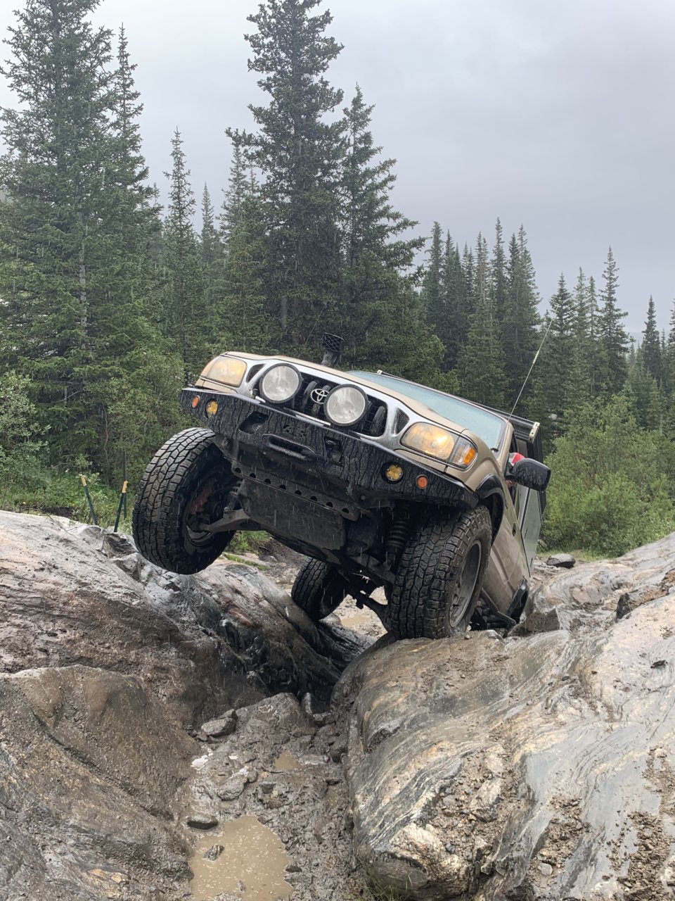

    Had a good example of how the crawl box can really help out running Wheeler Lake with @Squeaky Penguin this weekend, going up the notch obstacle in the rain. A bunch of jeeps were in front of us and we watched them spin the shit out it and bounce all over the place looking like idiots and thankfully not breaking anything to hold us up. I was next and threw er in double low and walked up it without slipping a tire hardly at all. Squeaky went next and made made it to the crux of the obstacle where just a bit more control is needed to keep from spinning a tire and slipping into the hole (he is also a manual), just a bit of spin slid him into the crack and needed to winch after anchoring his diff. Right after this wheelstand leveled out, passenger tire slid in.

    You're not wrong, and you really can't use jeepers as a gauge for anything, but it really did showcase how well low and slow works in adverse conditions.

    You made that obstacle look super easy. :cool:

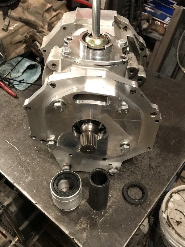

    You have an atlas in your 04?? Pls tell me more
