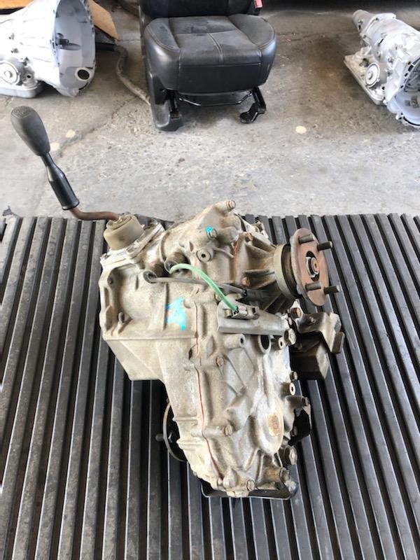

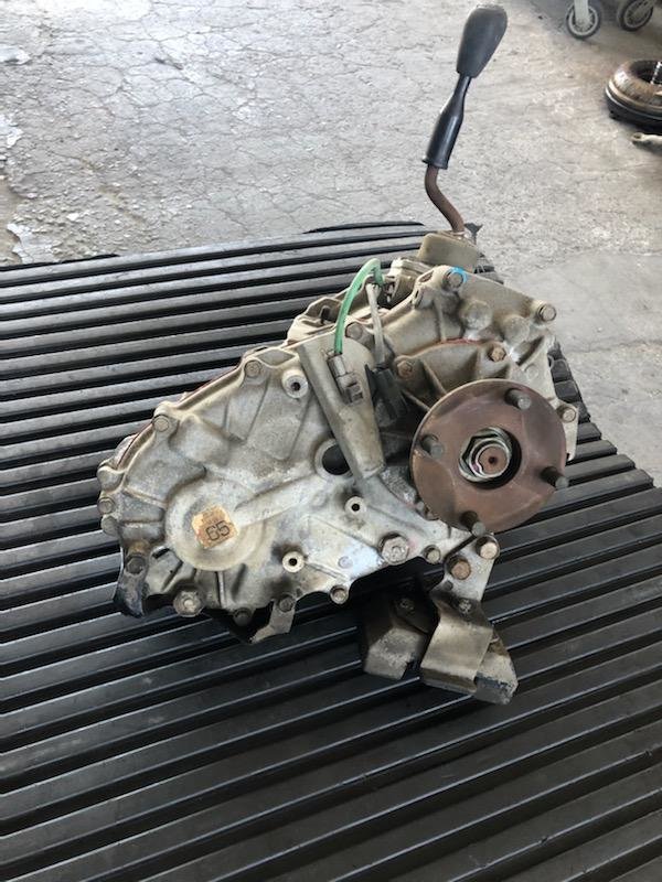

    Yea not much immediately local to me. I've been calling around to some of the places further away more down south. Found one $135 shipped about 4 hours away. Totally willing to pay anything under $200. Just gotta get some pics before I pull the trigger to make sure it's all there and the right case.
    Apparently they also had chain cases in that year range? I thought all the T-cases in that era were gear driven. One the places sent me a pic of the one they have in stock and it appears to be a chain case based on the MC t-case bible and there being only 5 bolts that hold the rear cover on.

    That's a Tacoma driver drop chain case. The best way I've found to search for them is a 1985 4Runner, MT. The only tcase to come in 85 MT 4Runners was a top shift.

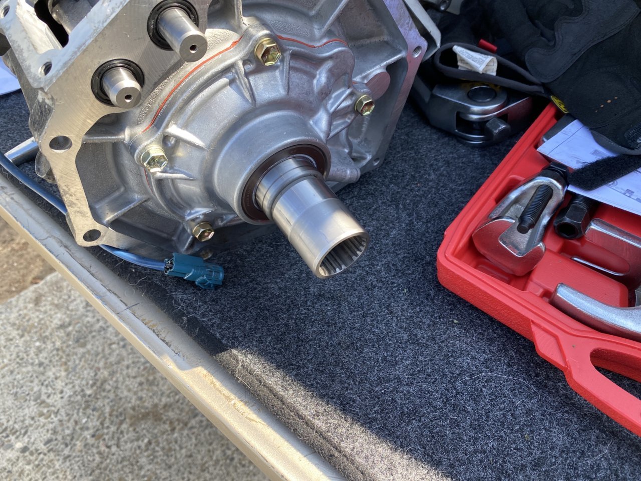

    Any tips on how to get the coupler off without welding stock to pull off? Haven’t set up my welder yet lol
