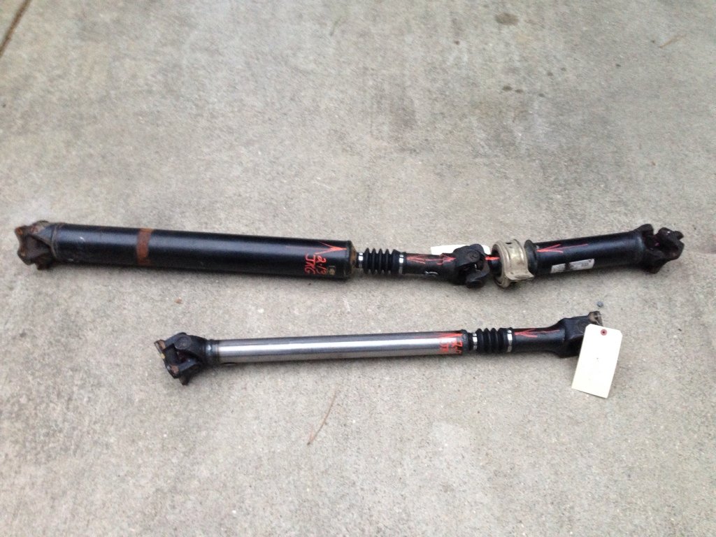

    $150 for the retube and balance with .083 wall, and $50 for the shaft from the junkyard.

    Fuck, it cost me 100$ just to repair my last driveshaft. What was the doner vehicle?

    Its different on a first gen, the gas tank hangs lower. I was going to get a 1 piece from High Angle Driveline after my crawler and jess talked me out of it for all the reasons i listed. I don't know how you guys are roasting through carrier bearings, i am on number 2 in 10yrs and i think i got a cheapass one in there now.

    87 IFS 4runner. But you can find them on any first gen pickup/4runner front.
    Gotcha. I haven't personally burned through a bearing but after I retubed my 2 piece for a spare driveshaft it makes all sorts of terrible noise when it runs unloaded. And I've seen other tacomas have issues with them so I opted to stick with the 1 piece
    I ran my two piece last year at big dogs offroad and smashed the bottom of it and have yet to get it retubed

    Yea my rear shaft on my two piece is bent to hell, the 80 axle with its offset and slightly lower pinion caused me to start smacking it into rocks that i never used to touch before the swap. Wheeled 6yrs with the only damage to the shaft is breaking off the grease zerk, in 3 runs with the 80 axle its now bent, tore the metal dust cover off and its slightly candy cained.

    Since my shackle flip and XJ shackle swap my ass is up high and a vibration started just after takeoff. I dealt with this on my last Tacoma that had a DB lift. I roasted 2 carrier bearings in under 3 years and I fear that im going to do the same with this build.
    Sure, ive thought about dropping the CB, but that just makes me stress when I get into difficult waterfall climbs and rock beds.

    Cut the leaf spring perches off and set your pinion angle properly and weld new ones back on.

    Ok, thats a lot if work but doable. Do you just take a measurement off the back of the trans and match that angle off the 3rd?

    The pinion should be parallel with the tcase with a 2 piece shaft

    Point the pinion at the flange at the carrier bearing. Its not too bad, its like an afternoon worth of work. Longest part will be dropping the rear axle and grinding the weld off the housing after you cut the perch off.
    This is how i setup the 80 axle and it had zero vibes until i dented the crap out of the shaft. Tom woods driveline has some good tech on this subject, read up there. Cutting and re welding is the best way to fix it, dropping carrier bearings and shims are just band aides

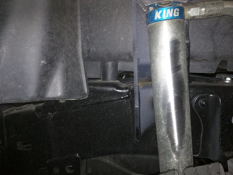

    What size shocks are those (2.5s 14" Travel?) are you going to have to cut the bedside for the towers to clear

    Dems be 12" 2.0s mang and this is my only minor issue
    Just a little polish at low psi and full stuffage
    Fuck spacers... Wont do it.
