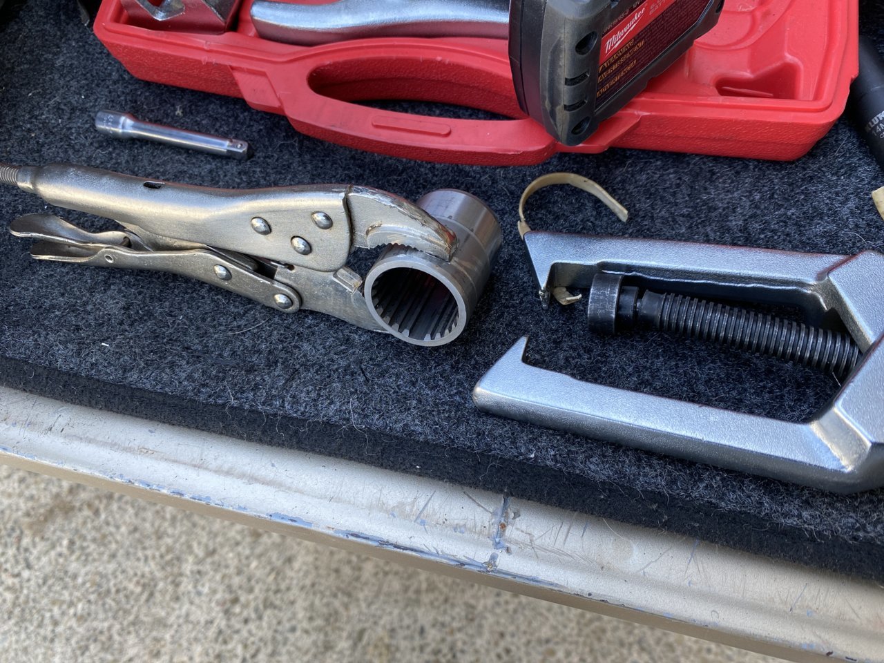

    I heated it up, grabbed it with a pair of channel locks then beat it off with a single jack.

    It varies. Some coupler comes off fairly easy without :muscleflexing: others are complex and difficult. Welding a rod or nut to the side will probably be easiest. If not, locking plier with a firm grip to the coupler than using a gear/claw puller. Or pull the input out and press it out.
    Endless possibilities.... just have to use your imagination. :drunk:

    Couldn’t get the grip to stay, so I cut a couple notches so it sat in there good and square and then pulled it off like cake :thumbsup:

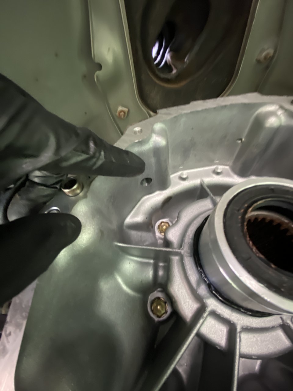

    The passenger side shift rail is empty and near the top of the case.. how big of a deal would it be to use that entrance for a breather vs the shifter base? Pictured below.

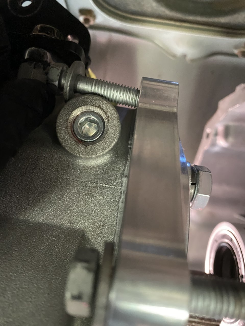

    Also, the picture below is me trying to get the stock hardware past the shift rail detent ball/spring hump on the crawl box. Wasn’t happening, so I put a stud in the tail housing and I’ll just use a nut.. anyone else have this issue?

    some of the hardware has to go on before the adapter plate is bolted to the reduction portion of the box, otherwise you’re stuck doing what u did

    Inchworm used Allen head bolts up there and those are a pain to get in. Not much room to get anything in there to turn bolts.

    Nvm.. I see a pass through to the tail housing via that empty shift rail hole, and the tail housing has a vent. Time to seal it up again. image.jpg image.jpg

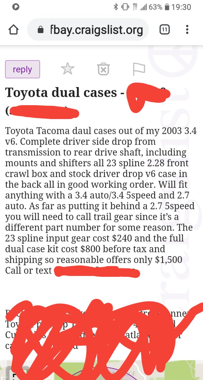

    Picking this up tomorrow. Good deal? No leaks. Im an auto
