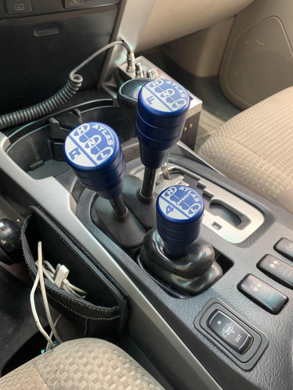

    What knobs are y'all running? I have triples going in and dont like the knobs it came with.

    Fernando[QUOTED] likes this.

    Good snag, sounds like your on the right track :thumbsup:

    They have unetched ones as well in variety of ano colors.
