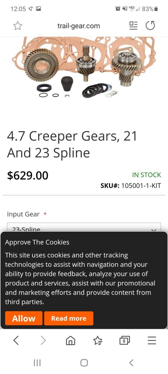

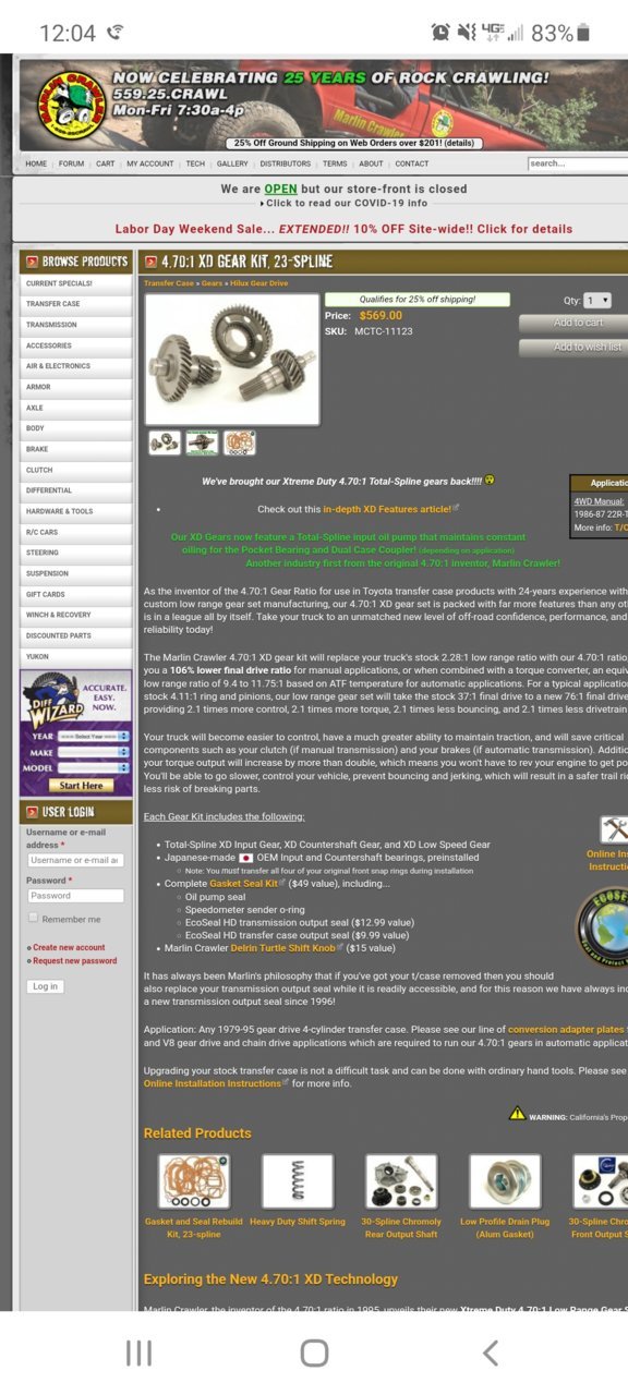

    My hole thing is availability. When I get the money, I want the stuff now. Not next year. Sure marlin may be superior but there’s plenty of guys (myself included) beating on tg gears with no issues. Run what’s available and forget about it. I’ve said it before and I’ll say it again. Way to many web wheelers who say you need xyz part to wheel but don’t even wheel themselves.

    No one say you'll need xyz parts to wheel. If the option is there, wouldn't you buy better parts? True, it's useless to buy better parts if it's not in stock. But the funny thing is TG 23s 4.7 cost $629 which is more then MC 23s 4.7 at $569. Both are in stock right now, why would anyone buy TG? Pay more for less quality parts?
