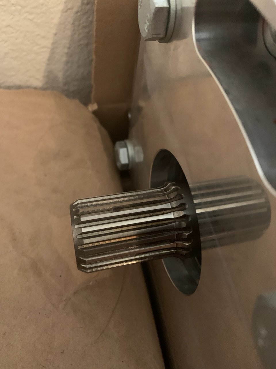

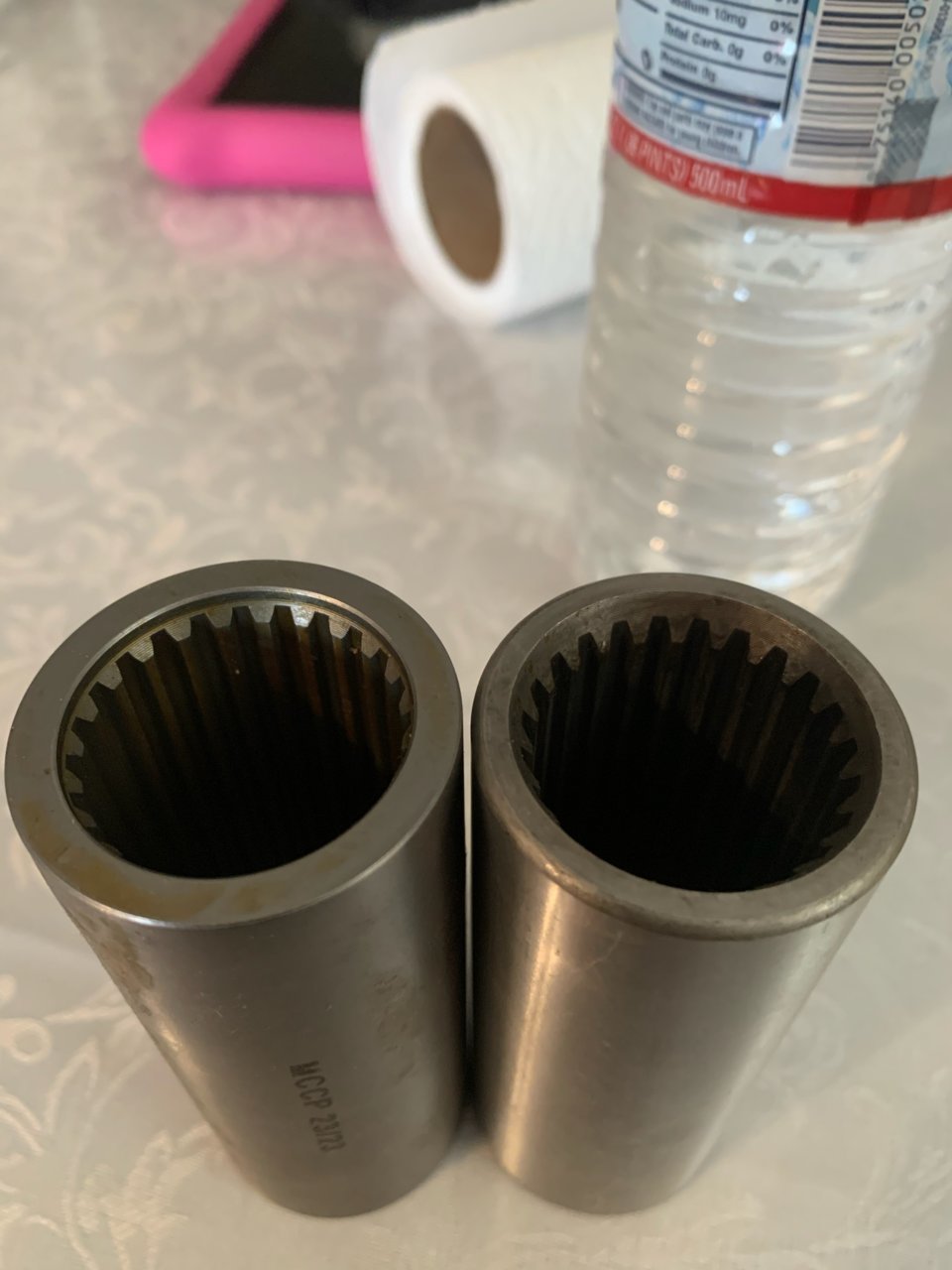

    Well damn. I guess I'm gonna be the test mule on this one.
    I'll definitely be reporting back here when I get my adapters in and I can test the fitment and see if there really is as much slop as you guys say there is. I just need to see it for myself at this point I guess.
    But tbh, i'll be surprised if it's as loose of a fitment as it's being made out to be since I talked to a pretty well known shop that sets up a good amount of duals each year with mix & matched marlin & TG stuff.
    Worst case if it's completely shit fitment, I'll try and see if marlin will sell me just the 26 - 23 spline coupler they make. If they won't, then maybe i'll look into getting one made.

    Marlin don't have 23/26. Your hands are tied with tg.
