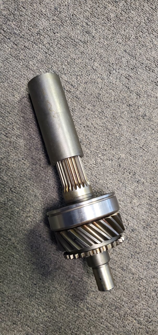

    So just got my TG adapter kit in.
    The 26 to 23 spline coupler is a fucking tight ass fit on the marlin gear spline.
    Will have to tap it on there with a mallet. But I really hope I never have to remove it.
    I know I'm mixing and matching gears and adapters, but generally speaking are the couplers supposed to be more of an interference fit? Or slip right on? @theesotericone

    Mine was the same. A few gentle taps with a mallet set it perfectly. Thanks for confirming that TG adapters work with Marlin input shafts.

    I wouldn't call mine gentle taps lol, but I got it on there all the way. Gear puller works great for getting it off.
    Unless the splines wear down or something, I don't see there being any slop.

    Nice to see TG must of updated their design. I purchased the MC 4.7s and the coupler from MC, Crawlbox assembly I purchased from LowRange came preloaded with TG 2.28s. Could not purchase with MC 4.7s. Test fitting the MC coupler on the 2.28s ended up in enough slop to rock back and forth when bottomed out on the 2.28 input. The coupler on the MC 4.7s was a nice tight fit with a small tap aka flick of the wrist with a rubber hammer, not alot.
