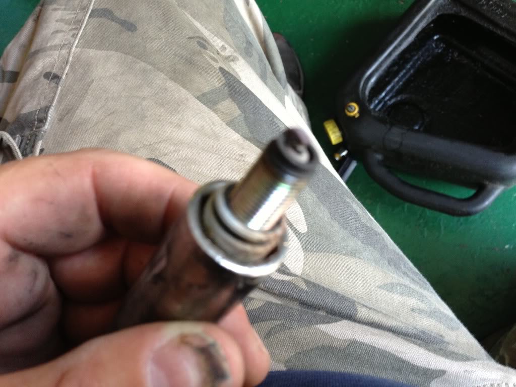

    any thought on seafoaMING MY DR650
    SHE STARTED RUNNING LIKE SHIT
    SO I CHECKED COMPRESSION WHEN WARM WITH THROTTLE WIDE OPEN AND GOT A READING OF 145PSI....
    AS FAR AS I KNOW not top end work has ever been done on her
    and im not sure what normal compression should be i thinking 120psi but am unsure...
    so that leads me to believe i have some carbon build up in cylinder.......
    i pulled the plugs and swapped in new ones and changed the fuel filter and she seems to run fine now...
    plugs looked in good condition...i will take pics later.....
    so i wanted to try some seafoam before i change the oil and check the valve clearances and such
    any thoughts 2002 dr650
    id say normal to carbon fouled if i had to guess....i will look better tonight

    Have you jetted the carb? Running any aftermarket exhaust or modified the intake box? The reason I ask is because on mine, I performed the above mentioned mods and she was running extremely well for a bit. It was a constant battle for about a month of adjusting the air/fuel screw to get a better mix.
    I had it running rich for a couple weeks and my plugs looked like your when I pulled them to check. I found for mine, a decent amount of popping on decel was right where it needed to be.
