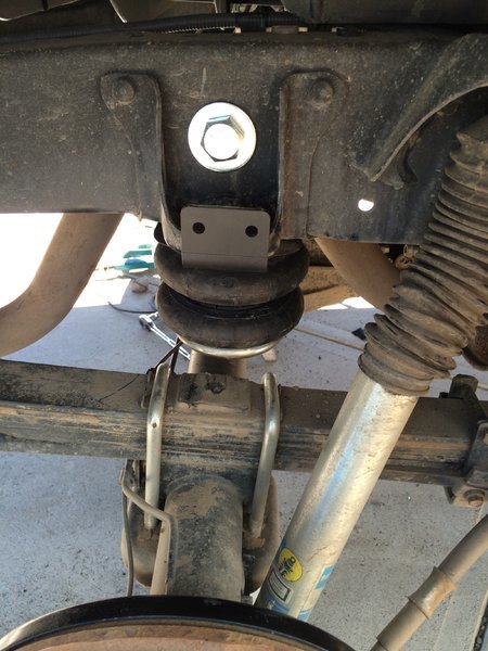

    Hoping someone can give me a quick answer on this. I'm putting airbags in right now, did you guys only use the heat shield on the passenger side? On the driver side I can't see why it is needed since there is no exhaust routed on that side and it looks like the shield would hit the brake lines with the wheel stuffed.

    This a serious question? I would automatically assume the heat shield would go on the exhaust side since that is the side the exhaust is on. Just saying.

    Yeah I know what ya mean but there are two supplied and instructions suggest to use both, which doesn't seem right to me.
    So yes a serious question

    I put both heat shields on the passengers side. Just turned(offset) them so they'd cover more of the bag.
    Probably overkill, but I had two shields, figured I might as well use them :thumbsup:

    I believe they provide 2 shields in case you have a dual exhaust!

    Not a bad idea since you got em.
    Thanks! Shouldn't be too bad. On a break now though :D

    You cut off your bumps? Could have just removed them.

    Yeah I cut them thinking I probably won't be needing them ever again and "thought" it would be faster. Turns out they are a bit of a PITA to cut off so probably would have been just as fast to just remove them anyway.

    Have you checked the fit of your bottom mounts? With that spring pak, it's pretty much a given that you'll have to extend the inner legs to meet the axles.

    Yep I new before starting that it wouldn't reach the axle. Arranged for the welding shop next to my work to weld an extension on Monday.
    Thanks for looking out :thumbsup:
