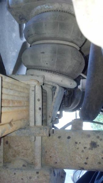

    So there's no confusion, that post quotes the installation post, which instructs on the modification of the longer leg. The picture is merely to inform of the consequences of not installing the longer leg. Pull up that quote for full instructions with pictures.
    Having made the install some time ago, I can report now that I run 8 lbs normally, and if loaded, pump it up to level the truck. I carry a Viair 70 for that purpose.
