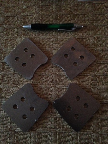

    Knocked out some brackets this morning.
    Took 15 mins to draw and about 30 minutes to make them.

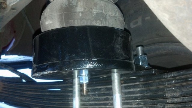

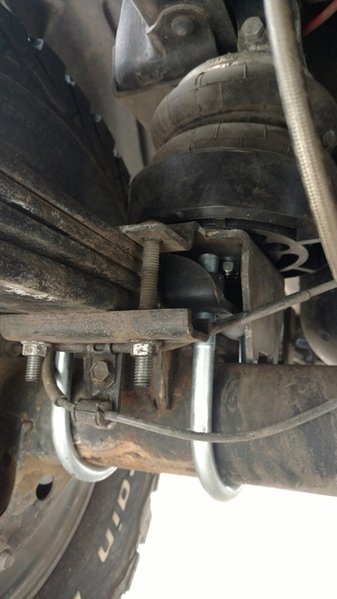

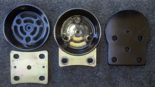

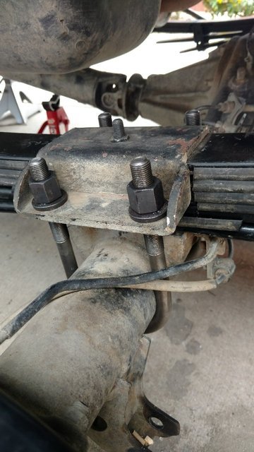

    There are a couple of recent comments in the thread about fitting the Ride-Rite's with a U-bolt flip. This one uses the "total chaos" bolt flip brackets, and Daystar cups with the air bags.
    Total Chaos saddle for spring clamp.jpg Clearance provided for air bag base.jpg

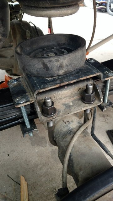

    For those not wishing to utilize the skinny brackets and associated hardware of the Firestone kit - here is a way to use some homemade plates and All-Pro U-bolts with the Daystar cups....
  15. Apr 30, 2017 at 7:39 PM

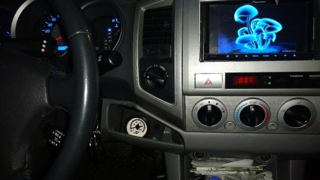

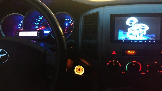

    ^ Those are slick. Are the u-bolt nuts inside the daystar? Is it tough to re-torque after 500 miles?
    I just added Dakars with 3rd leaf removed. Needed to extend the bracket bolts to accommodate the thicker springs. I also added the Air Ride gauge and compressor so can adjust in the cab. The automatic low pressure switch is nice. You can set it to whatever pressure you want.

    Burnout - I'm thinking that a U-bolt retorque will require a temporary removal of the Daystar cups. The base of the cup is 3/4 thick and on mine, I had to relieve the nylon base enough to clear and seat properly over the two inboard U-bolt nuts. I'm using the All-Pro flip kit with an extension disc laminated over it to carry the Daystar cups.
