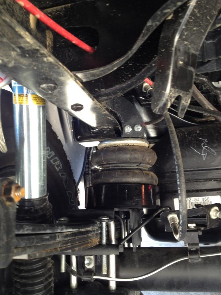

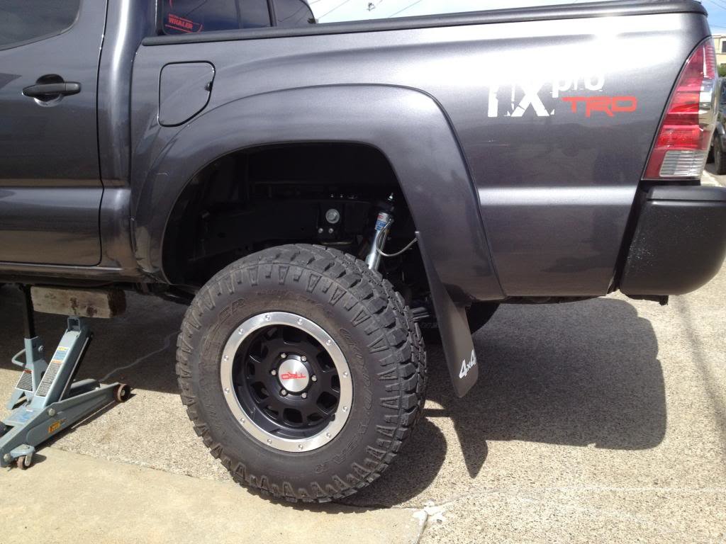

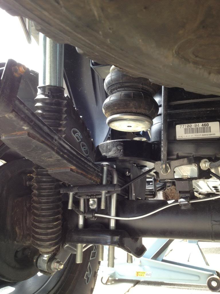

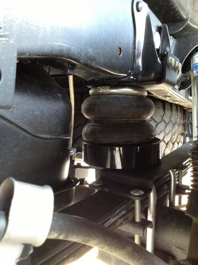

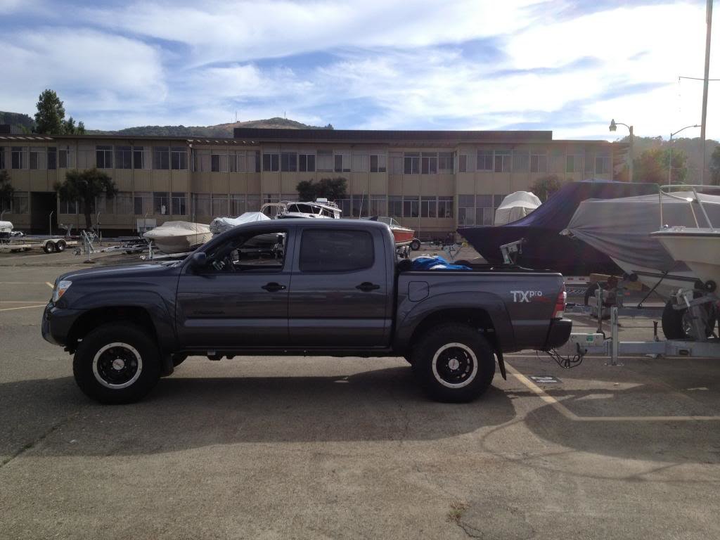

    Got the Daystar Airbag Cradles installed today. So far they are AWESOME. Removed the spacers completely, the cradles do rise up a bit.
    They only slight problem so far is that the cradle is not 100% centered so the bags are just touching the lip of the cradle. The material of the cradle is very smooth but I'm still worried about wear. I might try adding a strip of inner tube or figure another way to move the cradle a bit, not sure how I will do that though as the bottom of the cradle is vented (not ideal for drilling).
    At rest, no load, 5psi.
    Testing droop - 5psi
    Loaded boat - 0 psi
    Loaded boat 25 psi

    Before
    A_u94JDimm1rvh6Bh4bGS16JNbyhFn-g8tvoC7Bc_489f4d5361f9790b0c071bf68281e02a826b195d.jpg
    After

    I should also add that the rear suspension is MUCH smoother now that it's not bottoming itself out.

    What do you mean not bottoming out? Do you not keep the minimum 5 psi in them?
    Maybe the bracket that it is bolted to make the hole oval so you can get some side to side movement to center it under the bag?

    It bottomed out with the 2" spacer that was on previously. The spacer was too much and it didn't allow the suspension to compress.
    I don't think I can. The hole is countersunk to make the bolt that holds it in flush.
    Bolt goes to the bottom of the bag, in the center. You can see the mounting hole in the picture of the bag suspended.

    Thats right the hole in the bottom of the bag does not go through into the bag.
    No I was talking about the bottom original metal bracket that is on the axle/spring. Make that hole bigger (not anything on the new puck) or oval so you can move the puck around a little. Then use one of those washers that are huge in diameter but with a regular hole in the middle.
    I guess I still don't understand the bottoming out? If you keep the minimum 5 psi that they recommend in them it would be impossible to bottom it out unless the bags pop. And its bad to run 0 psi just for that reason. It will damage the bag itself.

    Ahh, I see what you mean. That might actually work, I'll have to take a look.
    Re: bottoming out. If you look at the original pic with the spacer and the truck at rest, look at the bag. It's already compressed and there is not much room for it to compress any more when the wheel travels up. That is what I mean by "bottoming out", there is just not any more room for the suspension to give.
    I could have removed the spacer and that would have eliminated that problem but then the bag would have been stretched more than it should have with the truck at rest because of the lift and I would have then lost 2 inches of droop.
    Because the bag is designed for stock suspension travel range, and even then some say it limits some articulation, it's not possible to get 100% travel when you increase your travel in any way, in my case travel increasing by 1.5 inches.
    Hope that makes sense.
