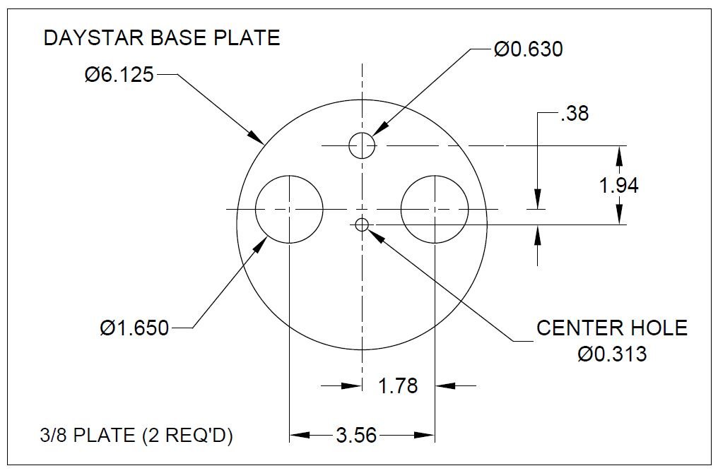

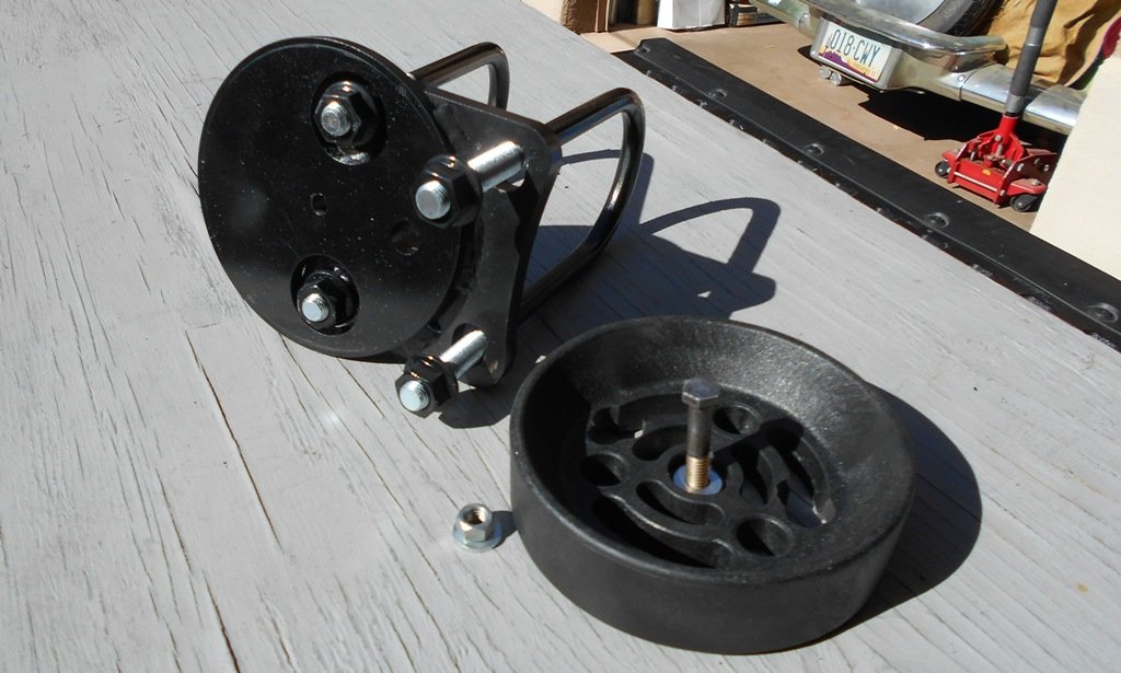

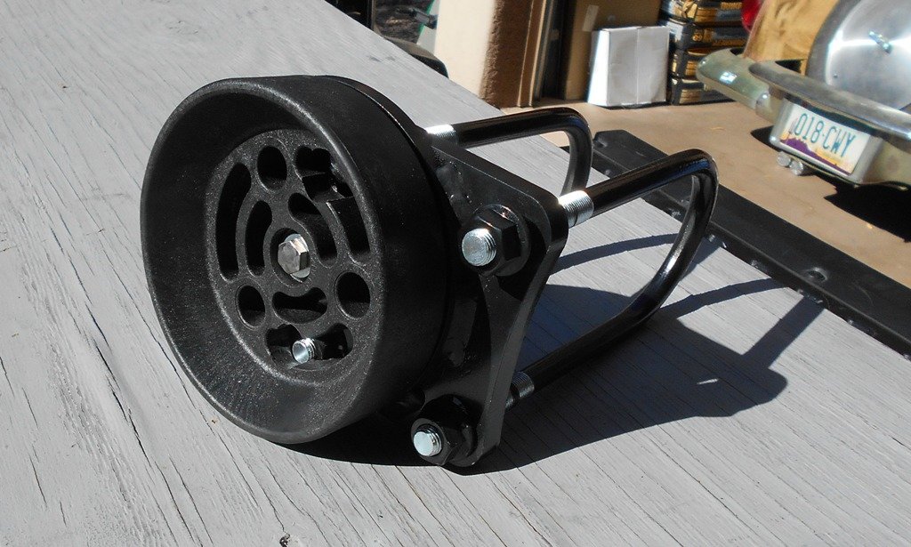

    Finally got mine installed - with an All-Pro U-bolt flip. Had to make some seats for the Daystars and weld them onto the base plates.DSCN0887.jpg
    Might have to offset them a bit more toward the center of the truck if I make another set. The Firestone upper brackets don't line up well with the lowers - which I used to design the mount. The lapped and welded 3/8 plate is plenty strong for this offset - doesn't need an extra leg to the housing tube. Rides nice at 10 - 15 psi.
