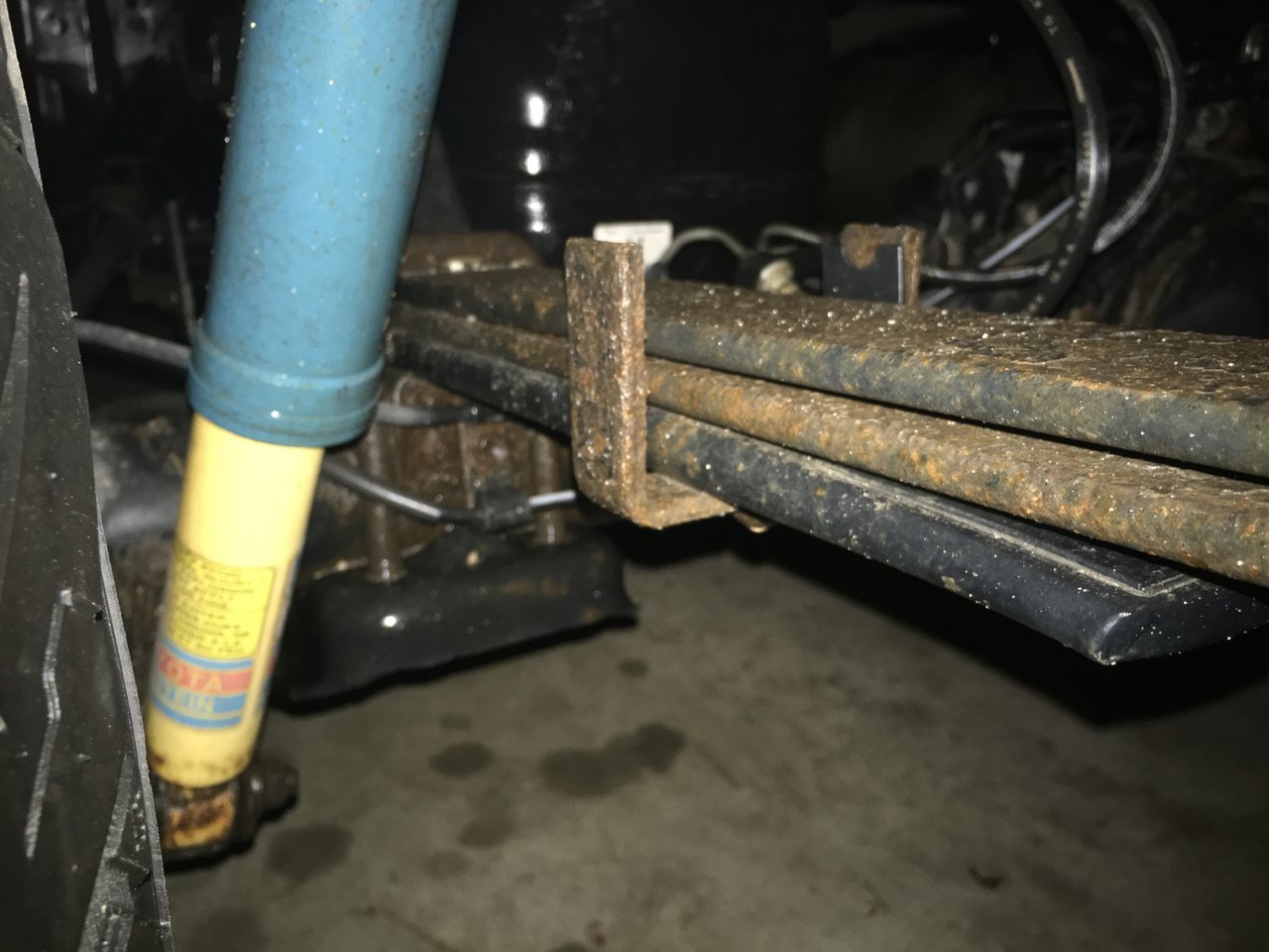

    Why do to need spacers?

    Your terminology... Spacers? If you mean the leg extenders to reach the axle for support, you can make those with hand tools. Zero tools? C'mon! Everyone gets a drill and a hacksaw on their 13th birthday.

    I just had a buddy weld a piece of metal to the existing bracket. The piece rests on the axle and then he laid a couple beads down the sides.

    Ben, two tips for you:
    One, don't install, only do a dry run to determine the length of the leg. Much easier to do the leg mod on your work bench before installation.

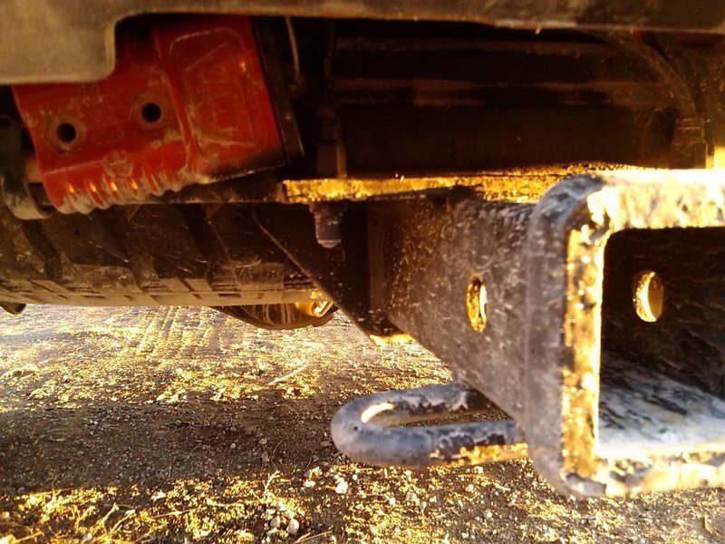

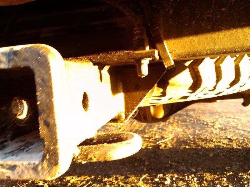

    I think I posted these earlier in the thread, but here's how I mounted my valves - on either side of the hitch receiver, pointed down.

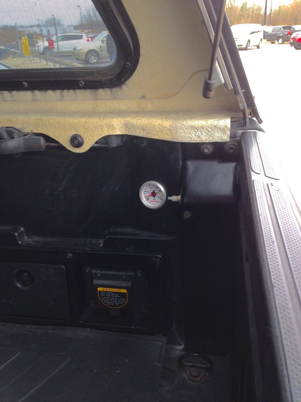

    i did this with the valves. One on each side and the gauges light up with the taillights.
