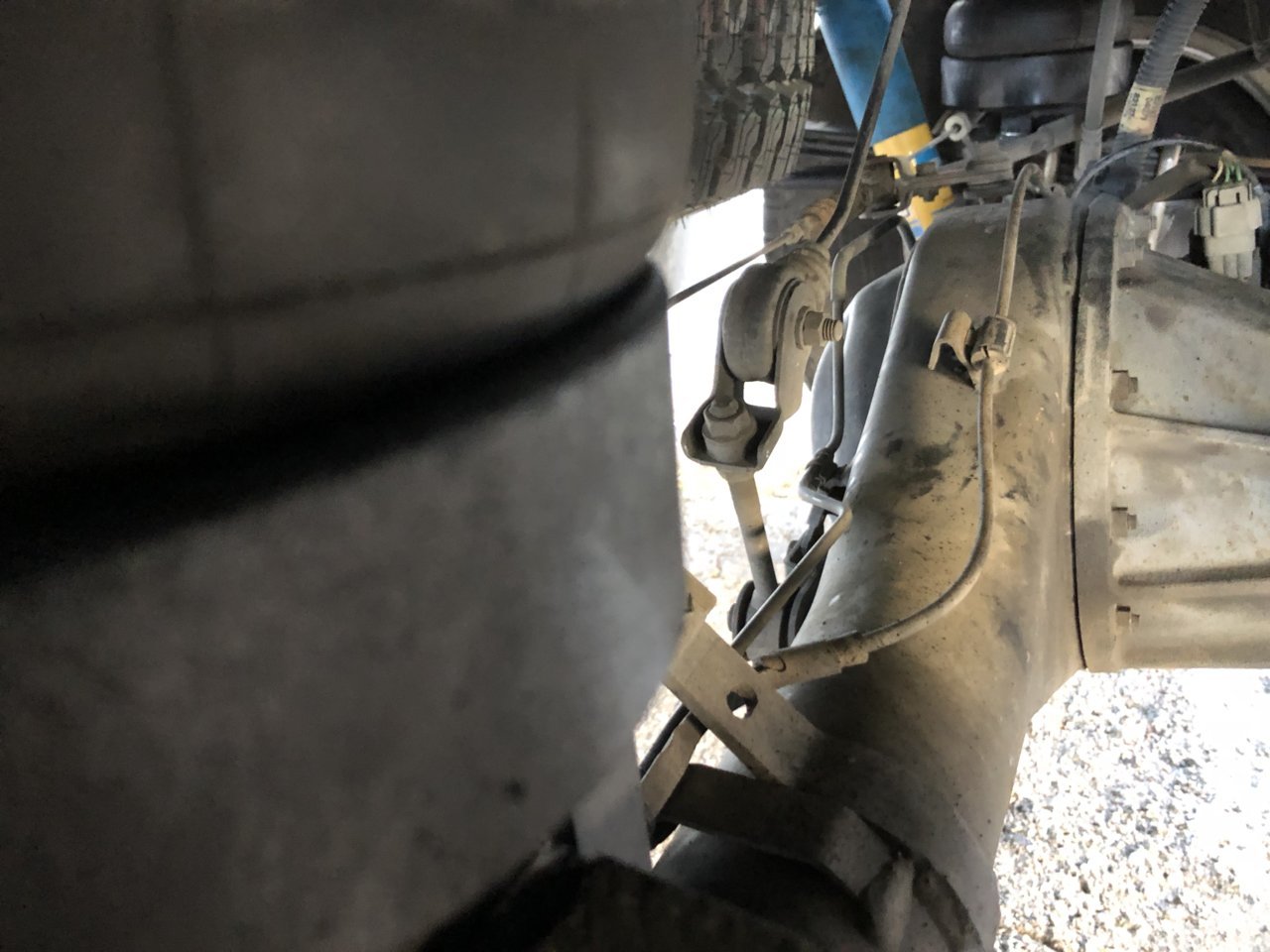

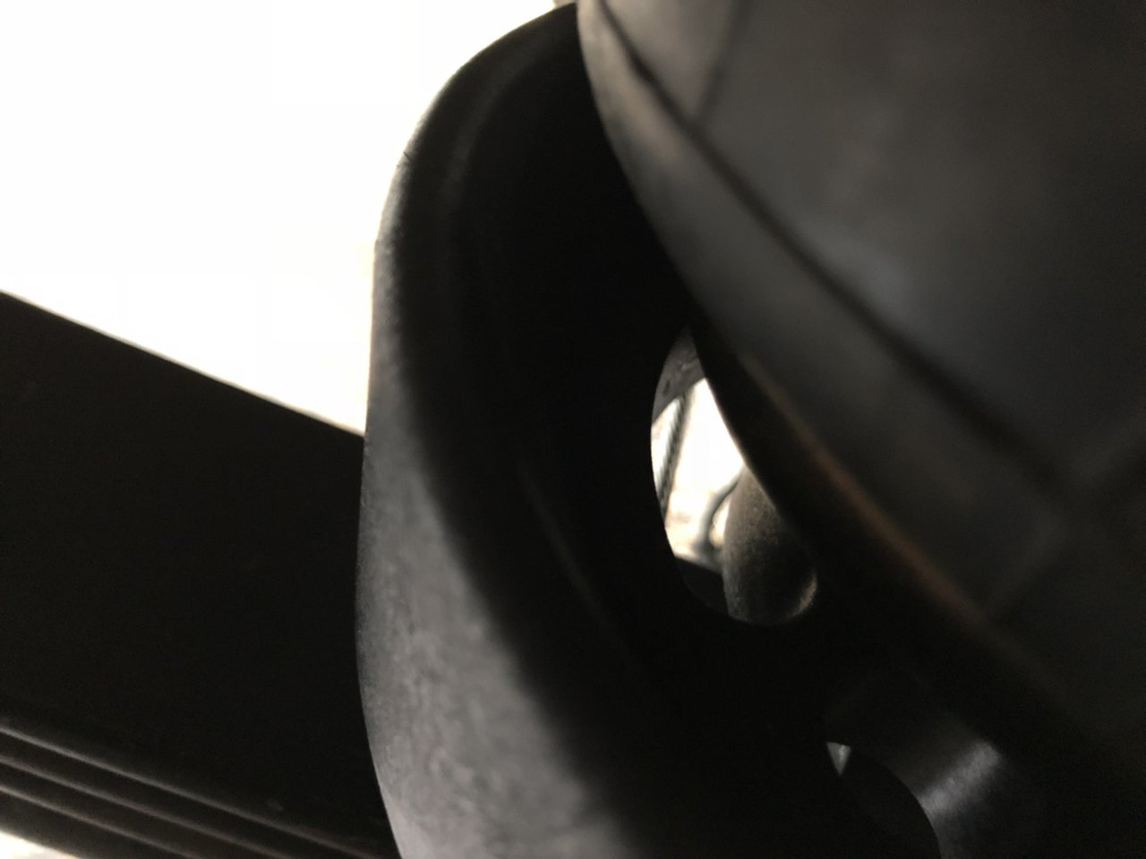

    I’ve got a first gen but the question is probably best answered here.
    I got the Daystar cradles and took off my 2” spacers which were way too much spacer for my stock TRD 4x4. When I put on the cradles one side is pretty well centered. One side is not perfectly centered. See the pics. Is this ok or do I need to drill new holes in the frame to move the upper bracket? The lower bracket can’t move any more to position it where the upper bracket is.

    Zacowacko
    Zacowacko Well-Known Member
    Oct 16, 2015
    #166800
    1,142
    Zack
    SW, OK
    2013 DCSB TE 4x4 6spd
    TRD Pro Susp., Icon AAL, Bags w/cradles, US OR Bumper w/Smitty, 2Lo Mod
    No problems. Your supposed to leave at least 5lbs in them for this reason. 5lbs doesnt sound like much, but it will stop it from happening. Still stiff as hell with 5lbs in them and no load. Just pulled a popup camper, with my bed fully loaded , 3 ice chests loaded/ton of other crap, and i didnt even need to add air past my normal 6lbs i ride around at. AAL i have may have helped a tiny bit, but i doubt it, since OL is out.
  14. Jul 12, 2018 at 6:48 AM
    #474
    Zacowacko
    Oct 16, 2015
    #166800
    1,142
    Zack
    SW, OK
    Mine aren't totally centered and ride on the cup some, its been fine.
