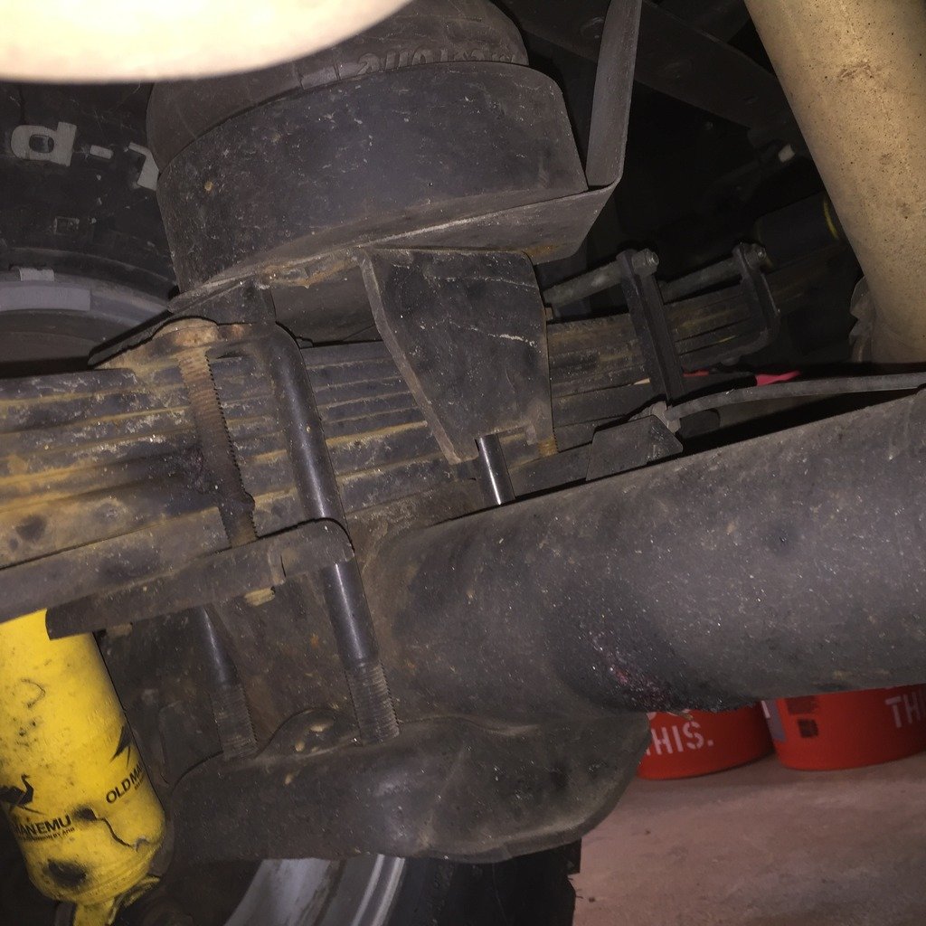

    Mine (014) has the stock springs and single overload. Un-pressurized the Daystars close the clearance by an additional 3/4 and you don't want to drive it that way! The standard Firestone bags DO NOT have internal bumpstops. I have a heavy tool box in mine and 5 psi won't do it either - and I'm just talking about the standard Tucson potholes. I methodically raised pressure until the truck wouldn't bottom in ordinary daily driver conditions - 15-20 psi worked.

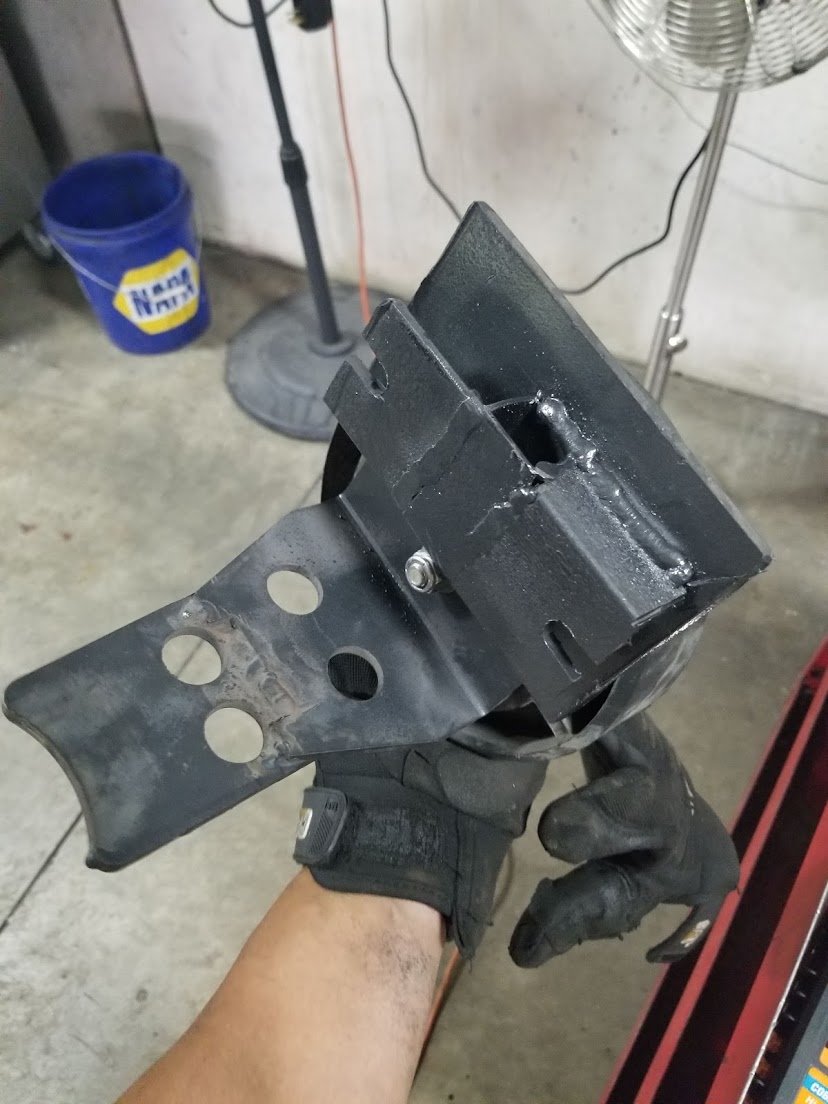

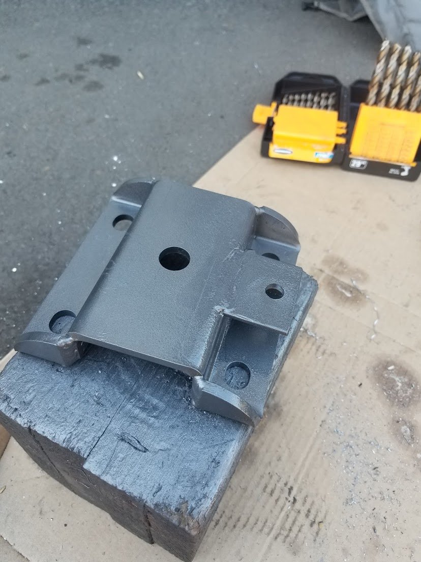

    i chopped up my brackets and freed myself of the extra bolts and brackets.

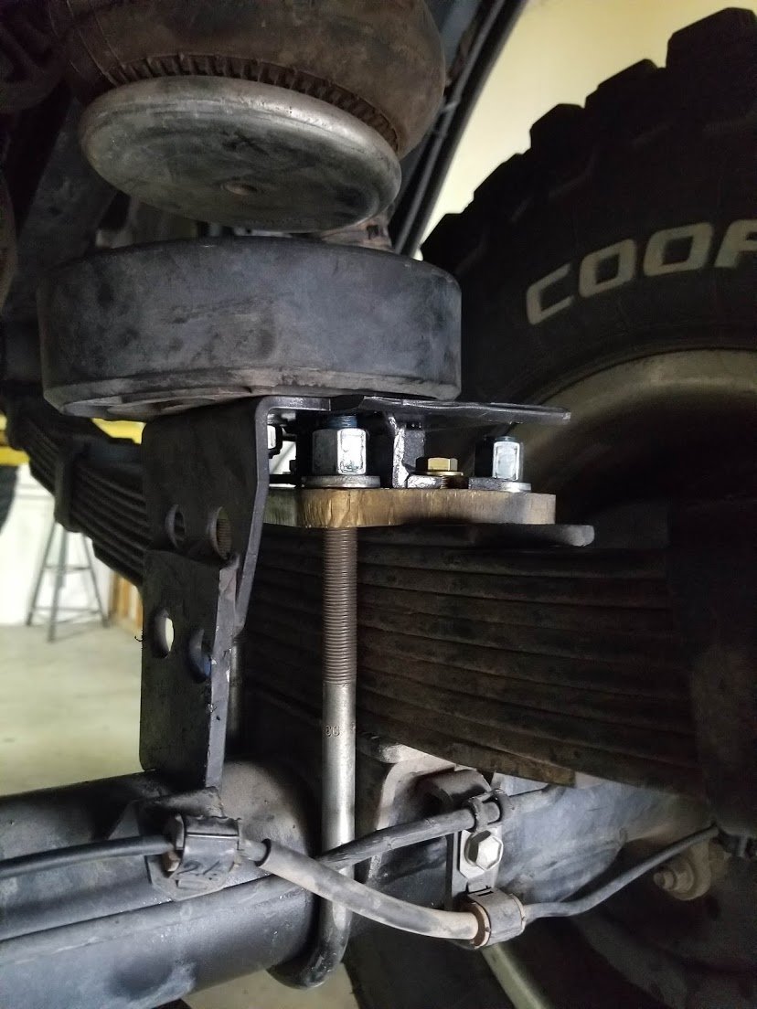

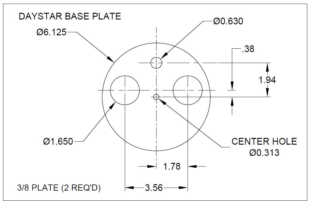

    This method works good with the All-Pro u-bolt flip:

    interesting, its that a retail product or custom? @Fox2011PM
    ive tried similar things with the tc plate but didnt have so much luck

    We cut it on the water jet where I work so...... dunno what the charge would be for a commercial product.
    The laminated 3/8 and AllPro 1/2 plates are strong enuff so far........

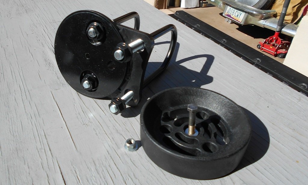

    @inesshell I like it, but my question is, do you have to remove the ubolts and ubolt plate in order to remove the cradle? I like our setup because you just unbolt the 2 bolts from the ubolt flip plate and the entire cradle can be removed if you ever needed to (like I have had to do several times to check my leaking bag). I simply air down my bag and jack the truck up under my hitch and it puts enough separation to remove the cradle easily. I do however like how the above setup seems all integrated and therefore probably pretty stout. I'll stick with the way I have it for now, looking to put my focus into changing up my bed setup, as you know

    On the single 3/8 plate support I made, I also made some matching holes in the Daystar cups so there was clearance over the U-bolt threads. The thread length was cut back to only be (1) thread over the flanged nut. So you have room for 3/8 +3/4 total of nut and thread sticking out of the All-Pro base plate. When the truck is jacked up, the bag rises up out of the cup - and a single center nut releases the cup for removal - then you can retorque the U-bolts.
    The combined strength of the 3/8 and 1/2 inch plates welded together are sufficient to not require the "downleg" to the axle tube. If there was anything I would most like to change - the center of the Daystar cup and the bag mount above are not centered. I used the same center offset as the Firestone bracket - and it isn't quite far enough toward the centerline of the truck. Second-most item I'd like to change - the stupid "push-on" plumbing arrangement - its just too prone to leaks and incidental damage.

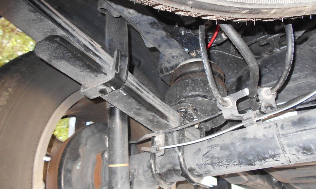

    Its one of those moronic "cover your ass" corporate statements. To go along with that - for ages, they "forgot" to tell users that the inside down leg brace to the axle would not (in many cases, even stock) touch the axle tube. ooops
