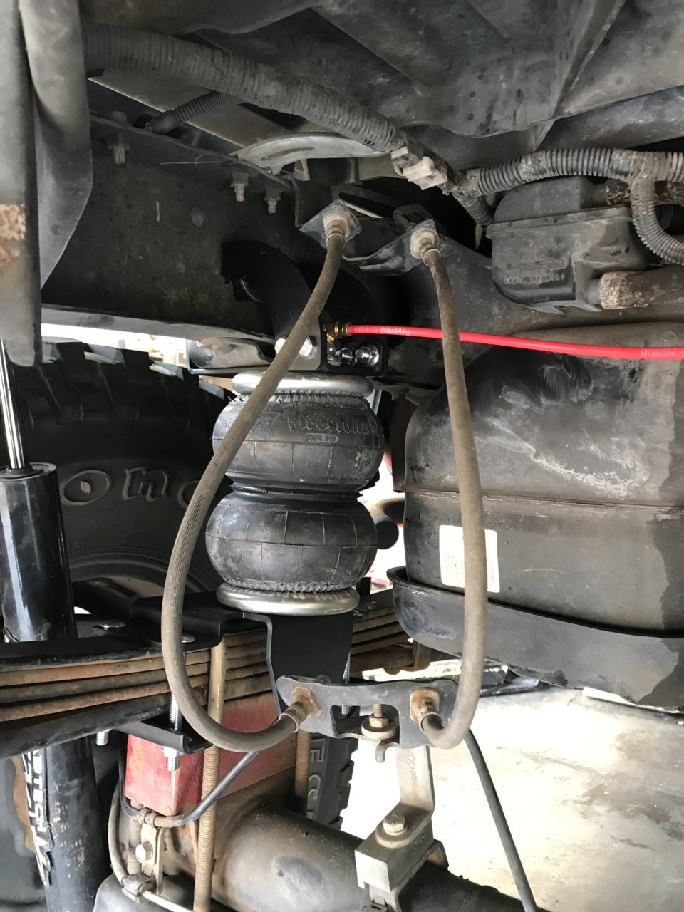

    Just got my setup done yesterday. Gotta admit, it took me some time as I made custom mounts for the Daystar cradles on top of the u-bolt flip kit.
    My set-up is:
    -2014 DCLB 4x4
    -OME MD Dakars
    -Nitrocharger shocsk
    -Low-Range U-bolt flip kit
    -Firestone 2407 Air Bags
    -Daystar cradles with custom mounts
    You can't see it here, but I trimmed the inner u-bolts so the custom cradle bracket could sit flushly and bolt to the u-bolt flip bracket. The outside u-bolts don't interfere with anything, so for lots of reasons, I left them stock length:
    And here's the only shots I have of the brackets before install. The wire feed on my 19 year old Lincoln SP-135P was really acting up providing a super inconsistent feed speed. It's been acting up for years, but it really pissed me off that day. As a result, welds aren't great but hope they're burly enough to do the job. Either way, once I recover from the credit card shock from this build, it's time for a new welder.
    So far, I'm pleased. Driver side bag doesn't appear to be holding air overnight so I've gotta figure out what gives there, but once the bugs are worked out, I feel this will be a really versatile setup.

    PS-I'm not 100% certain I'm in love with the push-to-seal air line connectors. I was really careful to cut square with the hose cutter pictured below but have a leak somewhere in my driver-side system. The right angle elbow fittings are as tight as I feel brass should be so I don't think it's there. Either way, how would you guys go about bullet-proofing this set-up as I've never really played with air fittings and the push-to-seal just doesn't seem right to me?

    I'm with you on that concern. I also had a leak, but discovered that one of the push-to-seal connections wasn't pushed all the way in. No leaks since then. Water lines to refrigerators, even house plumbing now can be had with the same sort of connections. Must be I'm getting old and don't trust these newfangled things.

    Try removing your valve cores and cleaning or replacing them. I had a bum one that slow leaked.

    That's a good tip. I tried that on my leaky driver side. The valve core remover I have has a little valve core tap. It threaded out a few small brass shavings. I also removed the line there and re-cut it and inserted with a little grease. It helped. System holds 30psi for about 2 days now instead of going flat in an hour.
    I used the soapy water spray method and couldn't detect a leak. I plan on re-cutting the bag side today and adding some Teflon tape to the fitting.

    I still have a pretty slow leak. Few lbs a week. Pretty sure it was those fittings too, with their already applied sealant. I didnt use anymore, as i thought i should have. Then the angle i had to stop turning them, to allow line to mount, left them slightly loose. I suspect slow leak for me is there. I should remove an add some tape or dope, as well. One day, lol

    I just ran out before work and Teflon taped the driver's fitting. I had some extra hose, too, and just replaced the driver's side length of it.
