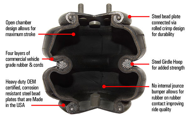

    Hi all. I created a thread regarding my ride rites and the rough ride they give https://www.tacomaworld.com/threads/air-bag-rough-ride.511877/ I'm not lifted, but hopefully someone can help me out here. Suspension is all stock except for the air bags and 1/4" spacers on front. Truck has a little extra weight all the time-winch and sliders-and sometimes a lot more-RTT and gear. I guestimate 400 lbs in the bed on our trips. Regardless of the load or PSI, the rear end bucks hard when both wheels hitbump at the same time, like a speedbump. It does pretty well with one wheel at a time. I took some video of the rear driving and hitting potholes at 12PSI with no load. Everything seems to be moving fine. Can anyone confirm if there is an internal bumpstop in these bags? The only thing I can think of is that if there is, the suspension is bottoming out and it's just a really hard bump stop. If not, it must be the shock or axle housing bottoming out. Anyone have any ideas? I used to be able to take things like speedbumps much faster. I realize the airbags will increase the effective spring rate, but they hit very hard at the top of travel. Thanks for any help!

    How good are your rear shock's? Even with an empty bed & 10 to 15 psi mine rides great, I usually run about 8 psi but have done test drives to see what higher pressures are like, No issues, just more ride height.

    Stock OR shocks with 20k miles. Do you hit many huge potholes, or really bad seams in the roadway? They are a fact of life in SE PA. The travel through the strok of the suspension feels fine, maybe a little stiffer than stock as I would expect. It's just at the top of the stroke where it gets very harsh very fast. I know I bottomed the stock suspension out a lot and it never felt as harsh as this does.

    The Firestone bags don't have an internal integral bumpstop....
    Yes - if you don't have enough shock or enough spring-rate or both..... she will be hitting hard on the axle if you blast through the speed bumps! On my own outfit, the height of the bag (collapsed) and the Daystar seat I put under it, ate up the allowable travel and made the truck bottom out more easily (crummy Toyota stocker springs are still in there). For everyday use (not jumping the speed bumps) as a daily driver - it took about 12 psi to eliminate the bottoming. I figure its going to take some different spring packs and a better shock to lower the pressure.
