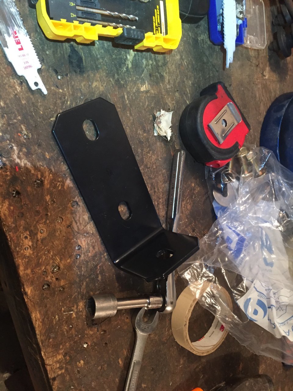

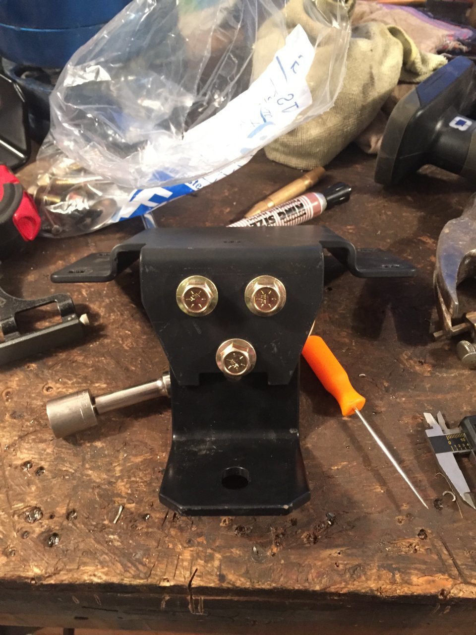

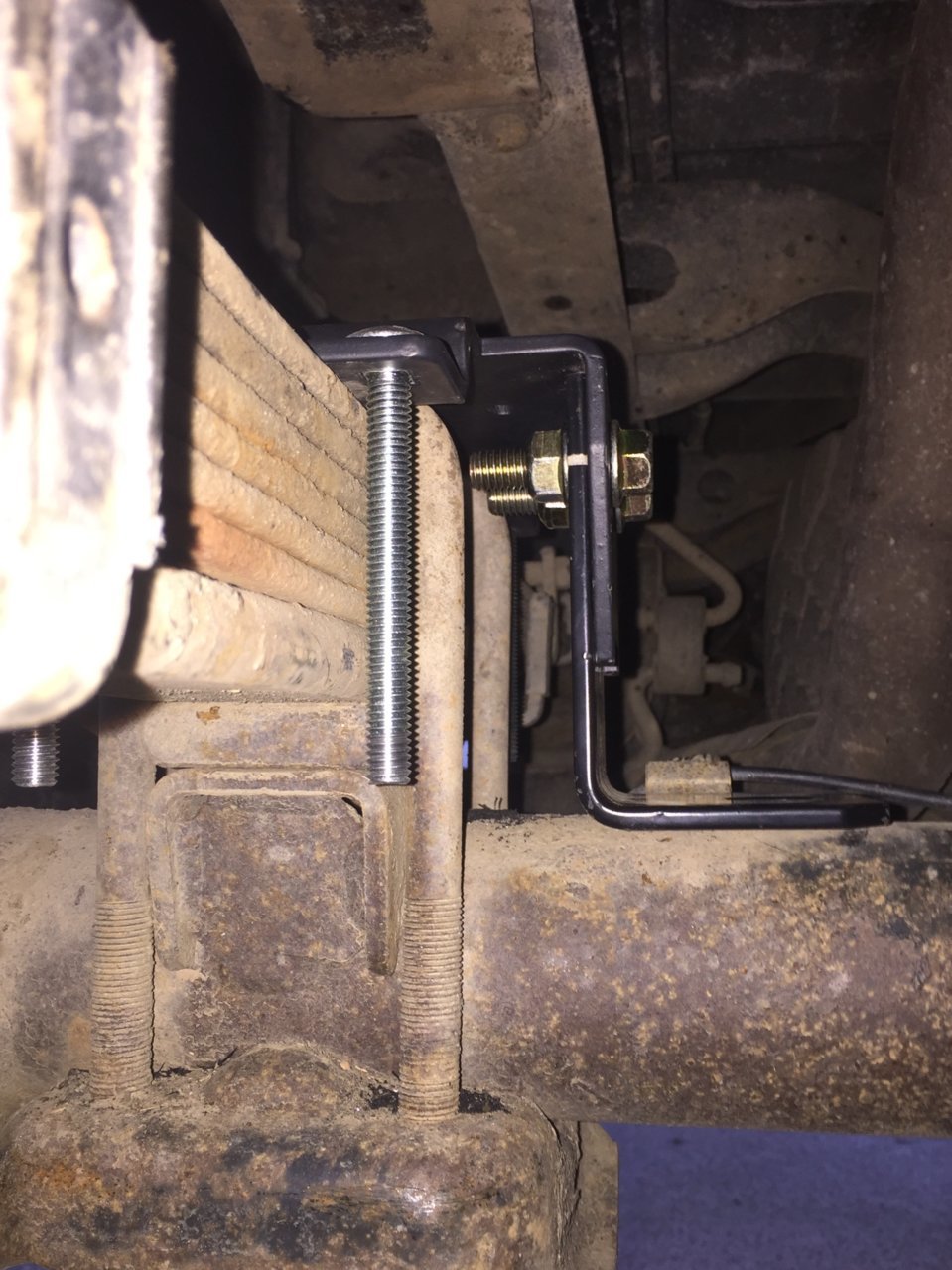

    I explored the option of buying the “extensions” for the bottom mounts since I’m running TSB springs with a 3 leaf add a leaf and 1/2” blocks.
    Came up with this for about 1/3rd of the price. 3/16” L brackets from the local hardware store cut to fit + 3/8” grade 8 flange bolts.
    Little more surface area than just flat stock.
    I’ve seen people mount the heat shield on both the top and bottom brackets, which is correct? I feel like mounting it to the top bracket so it hangs down doesn’t give you a spot for dirt/shit to collect and sit.

    The heat shield is mounted between the airbag & the exhaust pipe.

    Thats an interesting solution. Seems like it will work fine. I just cut off some scrap steel i had and welded it on, lol. 10 mins extra maybe, lol
