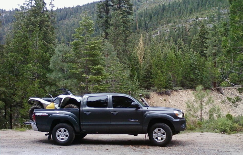

    full_f4b2509253e8210fb434da383ba02fc8c8b1d99c.jpg[​IMG]
    so im debating if i really need the air bags. This is my truck, fully loaded with extra fuel tanks. its low but not sagging that much.
    Do you recommend air bags? is it not sagging as much since its still new?
  3. Jun 21, 2013 at 10:37 AM
    #43
    littleblue81
    littleblue81 [OP] Well-Known Member
    Dec 25, 2010
    #48196
    576
    It's definitely sagging. But only you can make the call. If it drives fine and the amount of sagging isn't bothering you than you probably don't need them.

    You would be surprised how much more stable they make the truck.
    If it ever drives boaty then maybe they could be good for you.
