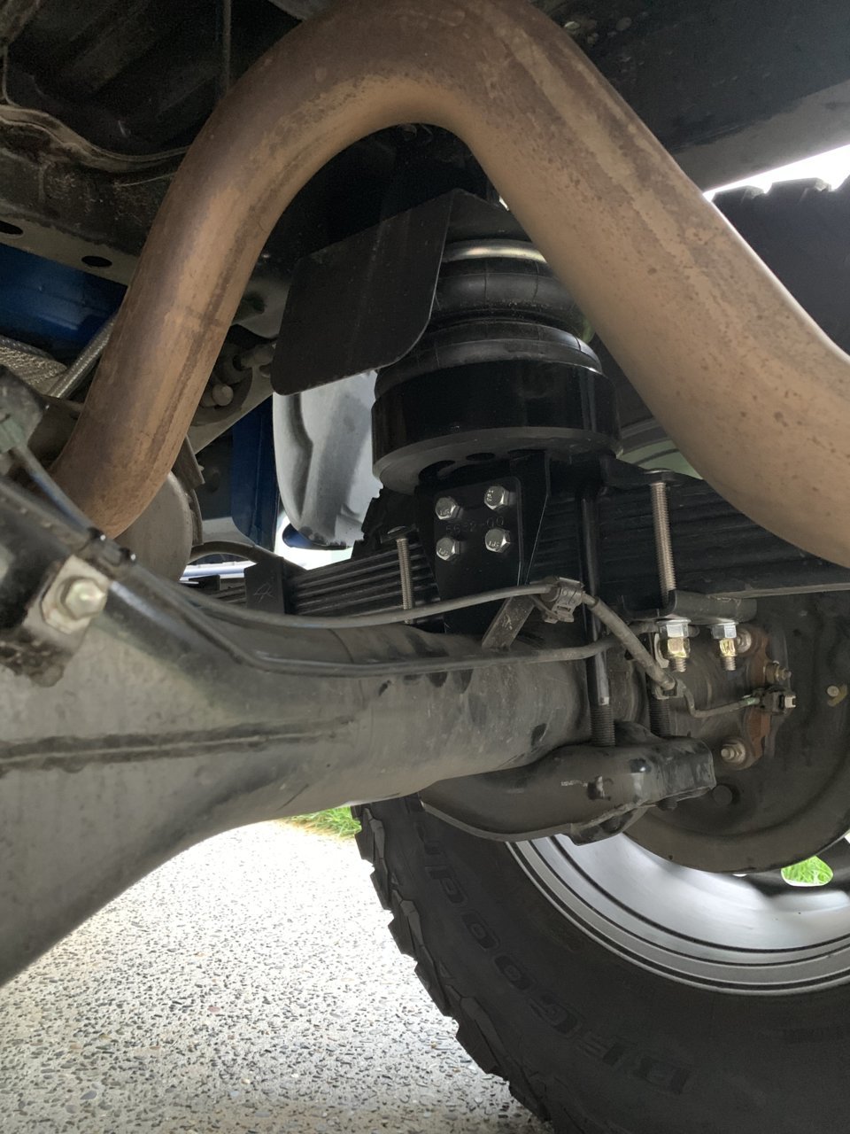

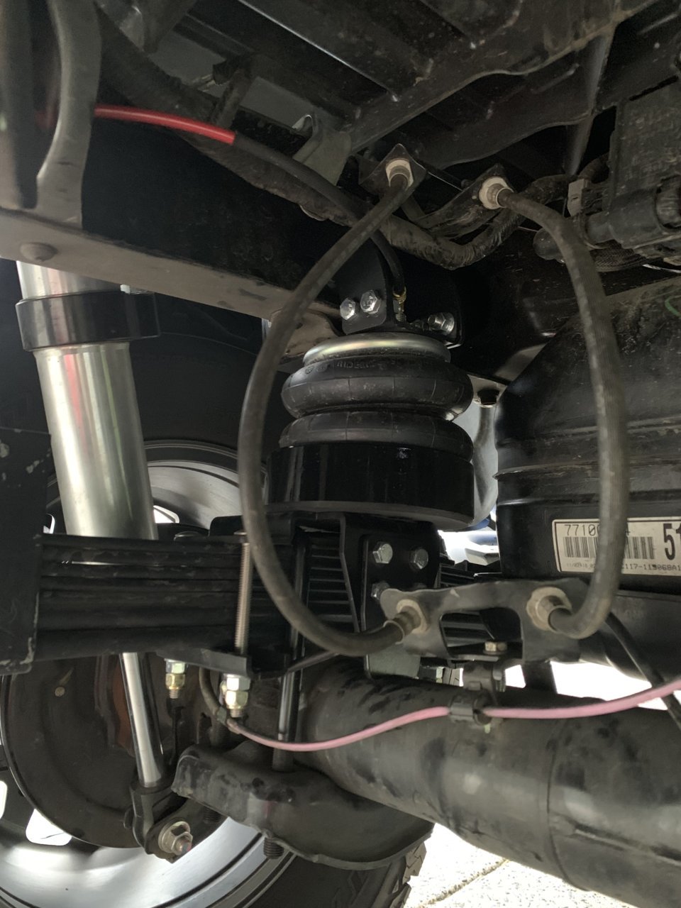

    Man, this install kind of sucked being by myself with just hand tools. Those lock nuts and either long bolts or little room with nobody to hold backup was a bit frustrating. I did have to weld up some extensions since I have the leaf spring TSB. The gap was slight, but it was there. For peace of mind I went ahead and welded up the extensions. I didn't try to contour them to the rear end, just straight across.
    Had leaks on both side but I think I tracked it down to the schrader valves.
    I have 15 psi in them now since that's as low as my pressure gauge goes, but they'll go down to 5-10 once my new pressure gauge gets delivered tomorrow.

    Good job on the install, I can’t imagine doing it without power!
    If you are planning on any offroad adventures, look into the trailer plug relocation brackets. Best insurance I’ve bought in a while.
