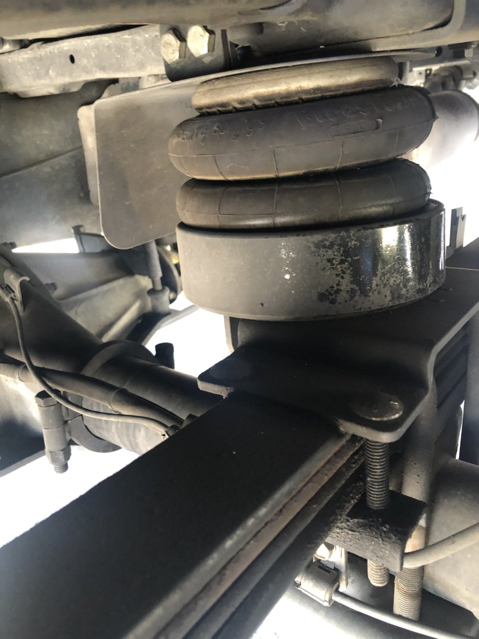

    I ended up not using my bracket kit.
    Mounted the bags directly to the bump stop pads on the frame, then bolted the daystar cradles to my Timbren mounting pads. 5E59F0B5-8231-4688-A5E7-8DD216AD237F.jpg

    Nice! Is that a daystar cradle or a custom cradle too? I thought about this too especially when I realized that Firestone offsets the bag for seemingly no reason...i thought it could go right onto the factory bumpstop bracket just like that. I'd do it like that if I had the time and energy to do the custom job...i bought the full kit instead of just the bags hoping for a truly bolt on kit to avoid down time on the truck, but alas I'll be doing some welding :/

    That’s where I was. OME Dakar pack required a solution for spacers.
    I had already flipped my timbrens for water/muck, so the holes were already in the pads. Just opened them up a bit to allow for the offset inlet/mounting of the bag. I liked the idea of a straight load directly to the frame from spring, rather than the cantilever of the bracket kit.
    Standard daystar cradles.
    The mount is the lower Timbren mounting pad. Would be super easy to reproduce if you have the welder out.
