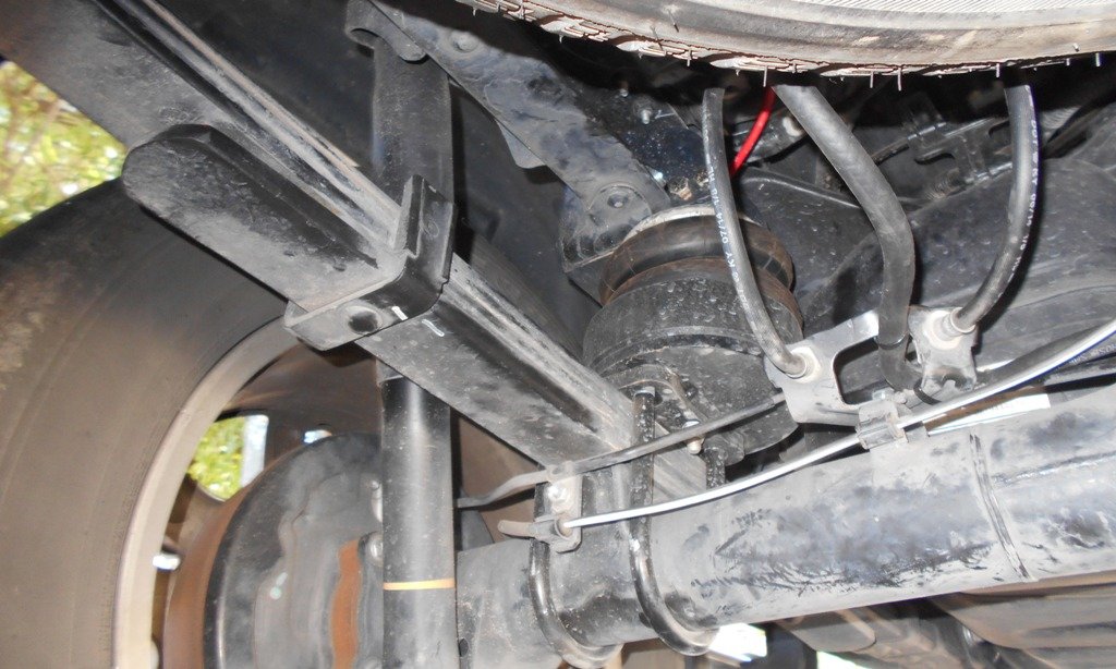

    In your pics you can see that the cradle and bag are offset to the centerline of the truck an equal amount. This offset is what I was talking about.
    Mine have the cradle and bag aligned to be centered on the leaf and bump stop pad. Just a different alignment.

    FWIW, not sure that it matters, but your "bracket strap" located under the leaf springs is upside down compared to the instruction diagram on page 2 here. :notsure:

    I put them on in a way that seemed logical. I never would have thought they would be installed 180. Good catch.

    I installed mine that way on purpose. i get more thread protrusion with less bolt length. Yes, pressure on the bracket and lowest spring is reduced due to increased surface area by about 1/3, but I'm OK with that.

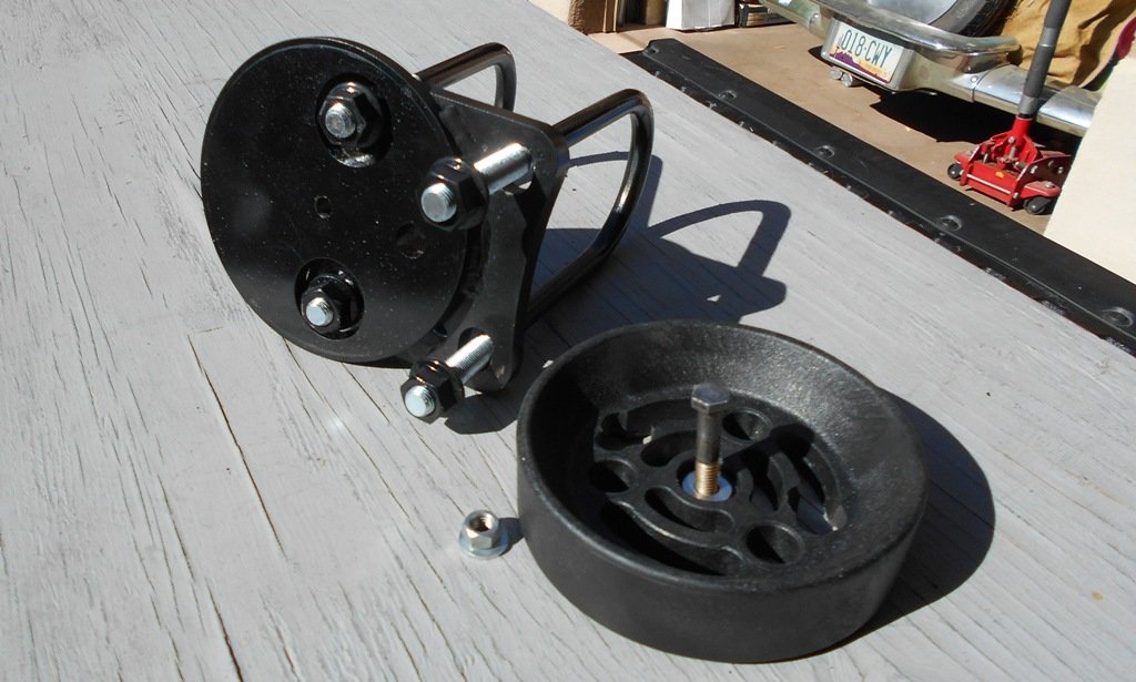

    What ubolt flip do you have?

    Hey how did you mount this with the u bolt flip

    This is one way to do it -

    Interesting, was that a custom job? Not worried about the mount bending without having a leg come down to pick up the axle tube? Earlier posts show the Firestone brackets bending if they're not supported at the axle.

    Support plate for the Daystar is 3/8 thick and the flip plate is 1/2 inch.
    At the point where the little Firestone brackets bend - these supports are about 6 inches wide and 3/8 thick. A centered load that would bend this would crush the axle.
