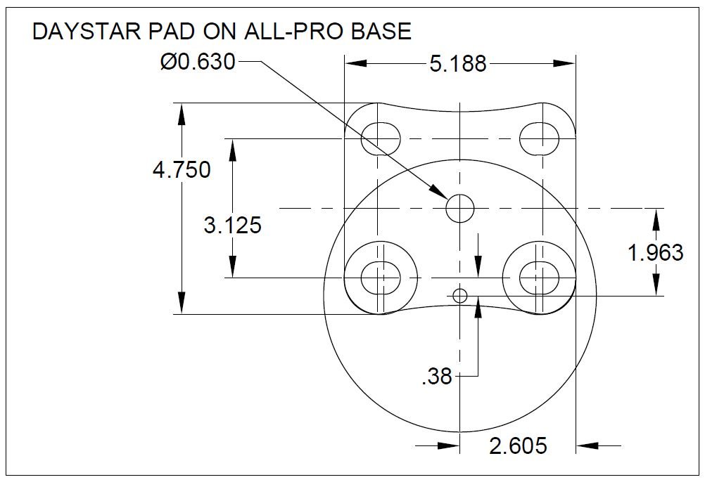

    Did you have a local shop make those or did you make them yourself? If you made them, would you be willing to make a second set? If not, mind if I or anyone else used the drawings to have a set made?

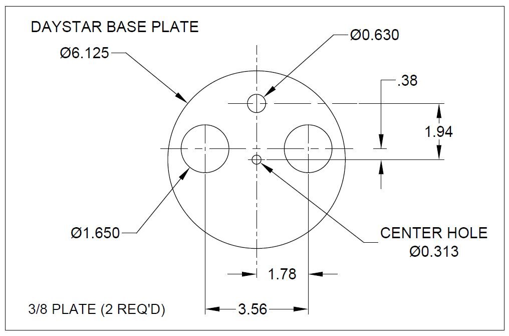

    Skierd - I used an All-Pro flip kit for the base, then had the round Daystar seats cut by the water jet guys at the shop where I work. Use the drawing as you please - I don't have any plans to make more of them. When the two plates are stacked and welded together, the base is plenty strong for the purpose so don't worry over that.
    Between the springs in my truck being flattened a bit and the combined thickness of the bracket and Daystar cup - a lot of travel space gets used up. To avoid bottoming the bags you will have to run about 10-15 psi in them with this arrangement.

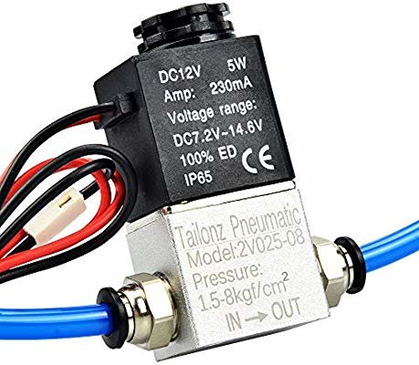

    How about making a bridge line between the two bags, but install a pneumatic switch like one of these that could be switched from inside the cab? :notsure: On demand articulation when you need it... Although, I see there is a direction of airflow. Will it not let air flow from side to side?

    That was my original plan, but my trip was coming soon.

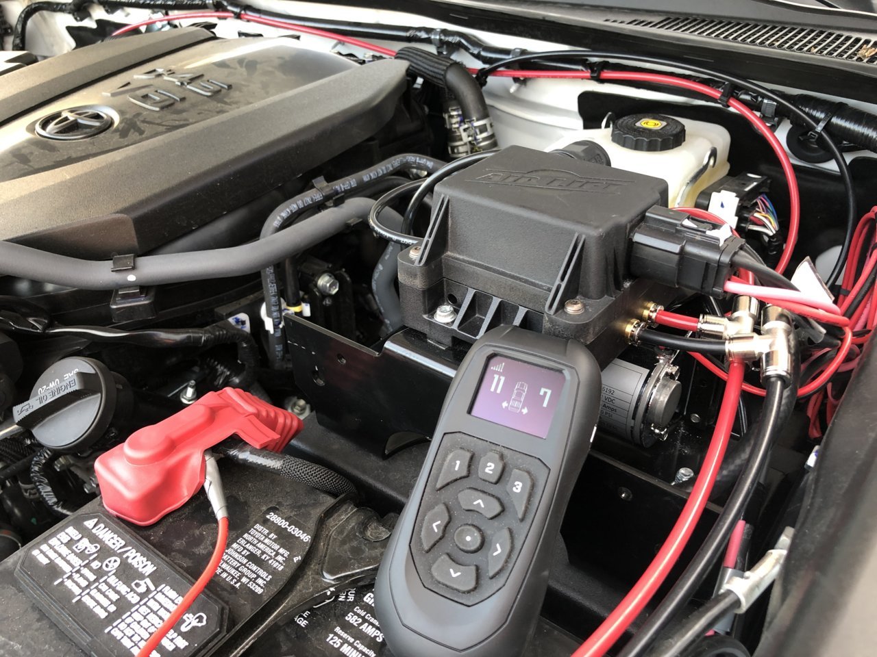

    I put this in today to air up and down my bags. It works great so far but think I made a mistake because I want to be able to air up a tire if I need to.
    I assumed it would but the web site says.
    Will WirelessAIR work with an air tank?
    Answer
    No.
    by the way my bags are ride rite

    Just found this on etrailer
    I am looking to run the same setup i had on my previous truck wireless air 72000 and load lifter ultimate 88200 but i want the auxillary air chuck ability something like the quik shot provides. Is there a way to add this to the wireless one or do a different set up? It needs to have dual leveling, wireless control. Or do i need to plan to run a completely separate system for the auxillary air? I will need to fill flat tires, trailer tires, etc. nothing like full off-road Jeep tires. Thank you
    asked by: Trevor
    Expert Reply:
    I do have a solution for you but I spoke with my contact at Air Lift and he said that a system like the One Shot cannot be added to the wireless air compressor system # AL72000. There is no way to regulate the air pressure in the tank with the wireless set up and the compressor is not rated high enough to air up tires.
    What you can do is like you said you could mount a whole separate system just for filling tires and other things and not integrate it into your existing wireless system.
