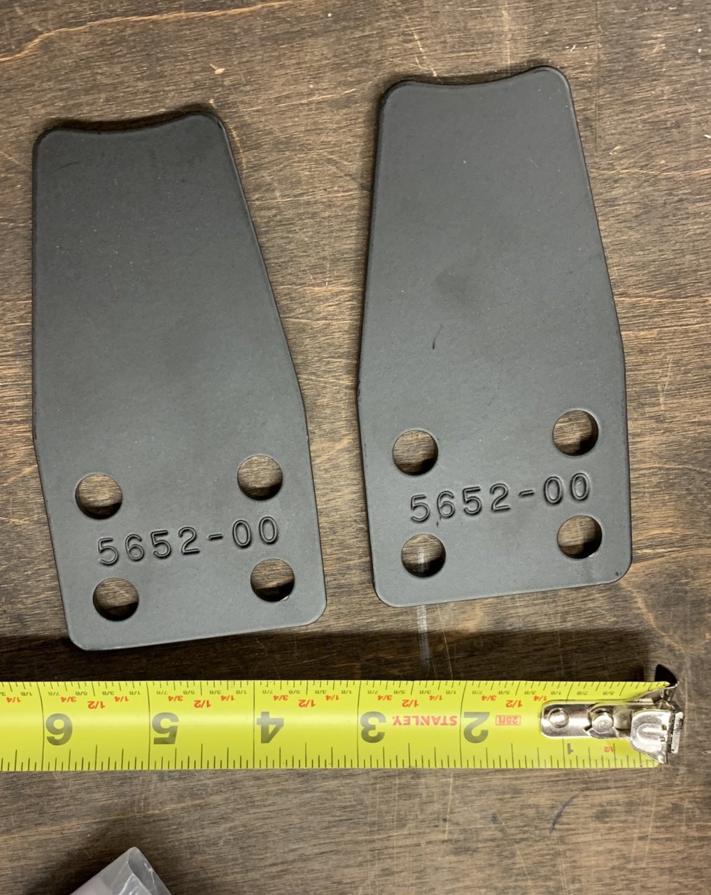

    Dialed her in with the 3” extension bracket after the initial install... Feeing confidant in everything now. Took the chop / 3 hole route on the extensions. Stoked!

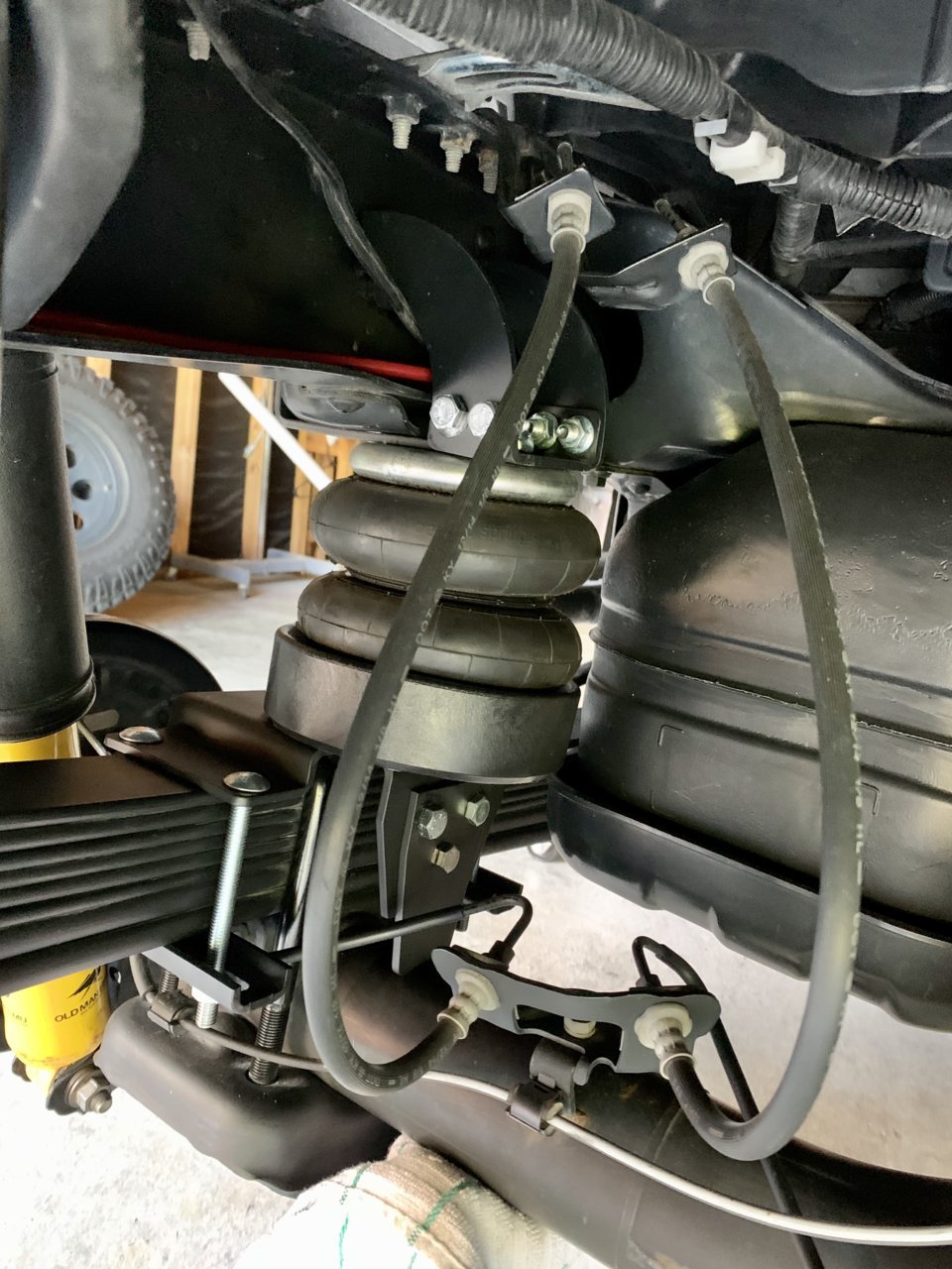

    lnstalled my Firestone Ride Rite airbags today with the Daystar cradles. Took me all day with no air tools, no lift, and a bad bolt from the kit. 68 years old and rolling on the garage floor was not that great. Instead of lifting from under the axles, works a lot better with a frame lift. Gives you a lot more room to fit the assembles in. Had to weld brackets to the bottom bracket the take up the 3/8 inch that it was short of touching the axle. Once assembled, works just as advertised. Routed my air lines to the fill valves that I mounted in the bottom holes of my license plate. Barely noticable. Overall, very happy with my airbags. A little more work than I thought, but worth it. Getting my 19 foot travel trailer in a few days and can't wait.
