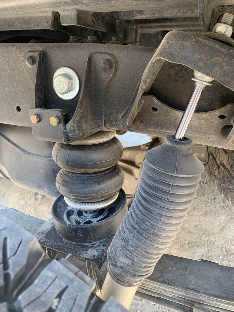

    I have the Firestone Airbags with Cradles. Has anyone found a way to suck the air out of the bags when not in use. My thought it that I would like to have them out of the way tucked up to the frame.

    You mean deflate it? Tire deflator? You’ll want them in since the bump stops are gone. these are at 7psi and floating above the cradle.
