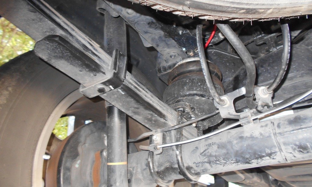

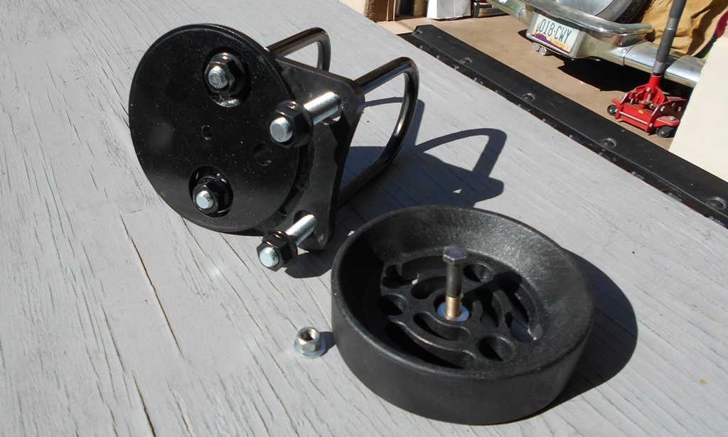

    This is one way -
    Daystar base (cut from 3/8 plate) welded onto AllPro flip plate.
    There are other ways........................

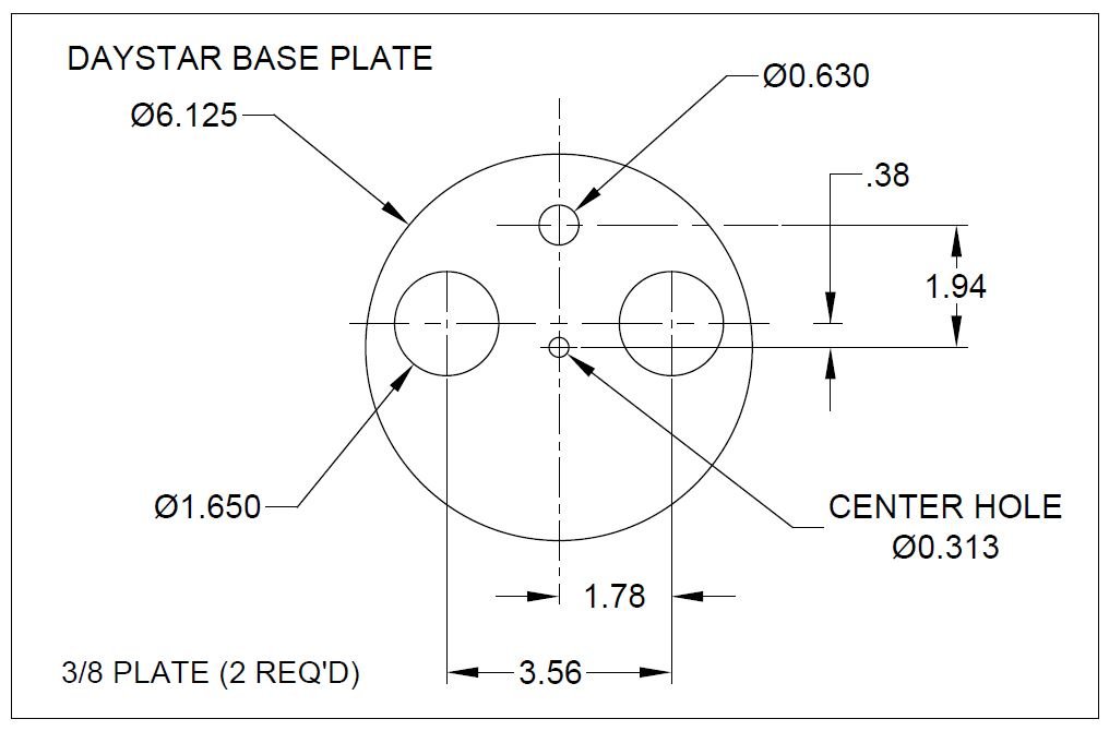

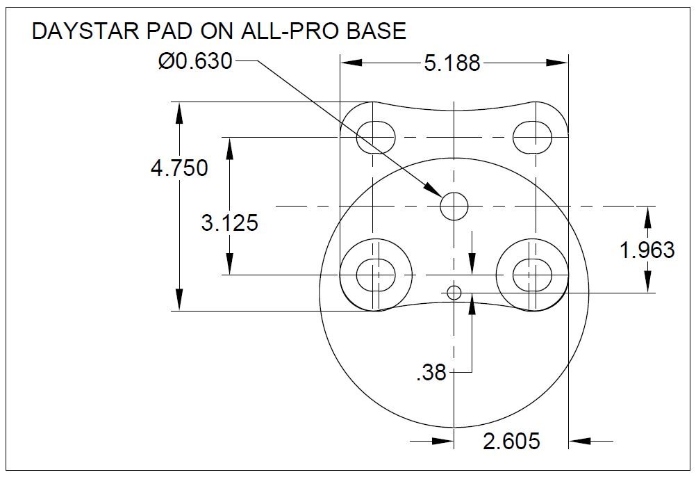

  5. Aug 20, 2021 at 7:22 AM
    #845
    GREENBIRD56
    GREENBIRD56 Well-Known Member
    Aug 19, 2014
    #136508
    751
    Steve
    Casper / Tucson
    014 Taco 4Dr 4wd
    Here are the prints I used to get my bases made - you are welcome to use them if interested. I had simplicity in mind - and our shop water jetted the Daystar discs out of scrap A-36 plate. Bought the All-Pro flip off a fellow who bought it but didn't use it. Use at your own risk - but it is way stronger than the Firestone parts (7/8 thick where their bracket bends)....... U-bolts shortened on the bag side of the bracket and Daystar cup relieved a bit.

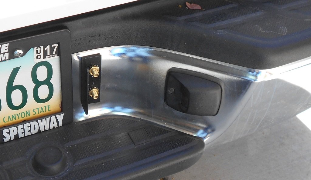

    I plumbed them to separate Schrader valves on the bumper. They've been on there awhile.
