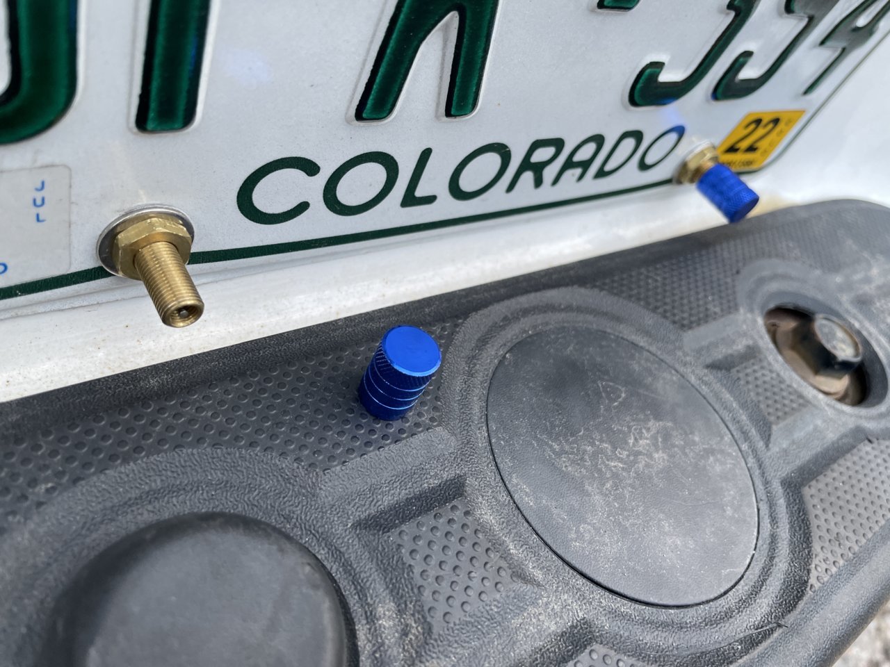

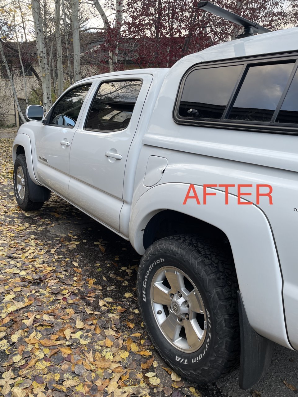

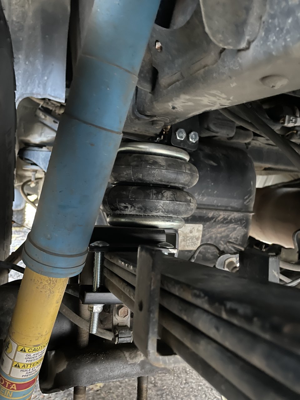

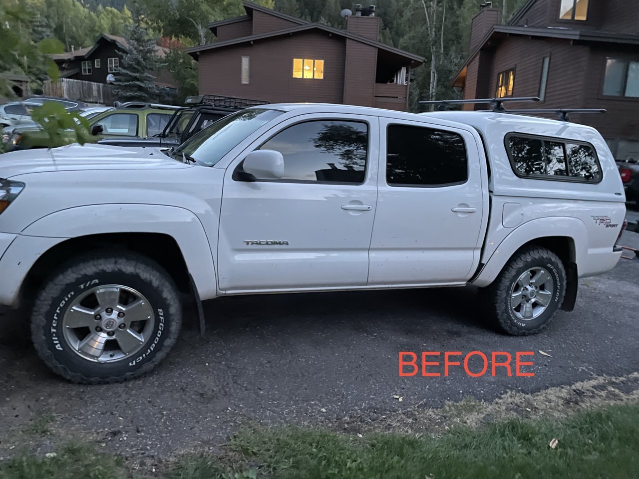

    After about a year of dealing with frame hitting bump stops and looking at a saggy rear end I decided to put on the Firestone Airbags on my 2011 DCSB TRDSport. I had considered new leafs and upgraded suspension but it all got very expensive and I didn't like the idea of getting too far from stock. Also I had just recently put on these leafs and shocks from a 2018 TRDOF take-off. I'm actually very happy with how they turned out. Riding with about 15 PSI in each side now with the weight of the Snug-top topper and tools in the bed etc and its actually way more plush of a ride then it was before. I mounted the valves under the license plate which I think looks pretty clean and keeps the hosing tucked behind there and out of the way. I got about 1.5" of lift and the ride it much better with less roll. It's nice to see the leaf springs actually curved upwards for once! :) Questions for other people that have the firestone airbags on a stock 2nd gen:
    - I have the Daystar cradles, but waiting to see if I need to use them or not first. Upside is obviously more downward travel and reduced risk for when a a mechanic puts it on a lift the axle will be able to more easily drop. But I'm worried that they will add lift and that when the bags comes off and makes contact it will make noise etc... It seems like most ppl using cradles are using them because of lifts etc. I don't do crazy wheeling but I do live in Vail CO and goto Moab/frequently and drive on FSR's and a decent amount of off-road riding. Curious about what people experience is with stock rigs.
    - How much PSI do most ppl keep in these bags all the time? Any issues with ice/snow/cold reducing pressure etc?

    Mine is lifted a tad but I also have a snug top with some tools back there and keep about 15 psi. I initially had 2 valves but put a T and connected them b/c the air pressure will balance. I didn't notice any more sway / ride difference, and it's nice to not wonder if the pressure is the same on both sides. I also don't notice the cradles on DD and mild off-roading. You will hear it clap when you're articulated and compress at speed -- for me this is 20mph+ driving down the beach which is rare. Overall these bags have been great for me -- it's been great to load up the bed and inflate as necessary for long trips down to the coast or just generally carrying heavy loads or towing.

    I had a leaky bag, turned out to be a very slow leak at the inlet adapter On the bad where hose goes in. About a turn and a half and haven’t leaked since. I say check all the threaded portions of your system and around the push-to-fit connectors.
    I ditched the elbows and went with straight in fittings, but my bags are inverted so the hose comes down from the top.
    @jrlockman
    I like your valve location, same idea I had for mine, but I used the top plate holes.
    I’m modded a bit, but do the FS road thing and some trails/crawling. With a load and air in the bags, I seldom hear a clap on the daystars. When running empty my springs carry the weight without bags so they are 0-5psi... honestly never check them. I’ll get clapping if unload the rear suspension.
    Since you run with air all the time, it’s likely you’d only hear clapping if you hop that rear end a ton.
    I have a cross valve between my right and left bags. I can feel the difference in cross winds and/or curves with the valve open. I can also feel the difference when articulating the axle and the valve is closed. We sometimes use it to fine tune the leveling of the truck in camp. With that I’ve got steel bumper and rear swing out, and a million pounds of camping gear in the bed, and the Hab shits a bunch of weight up high.
    As for pressure, I don’t go by psi, I inflate with a small bicycle pump mounted in the bed till the springs/height look right.
