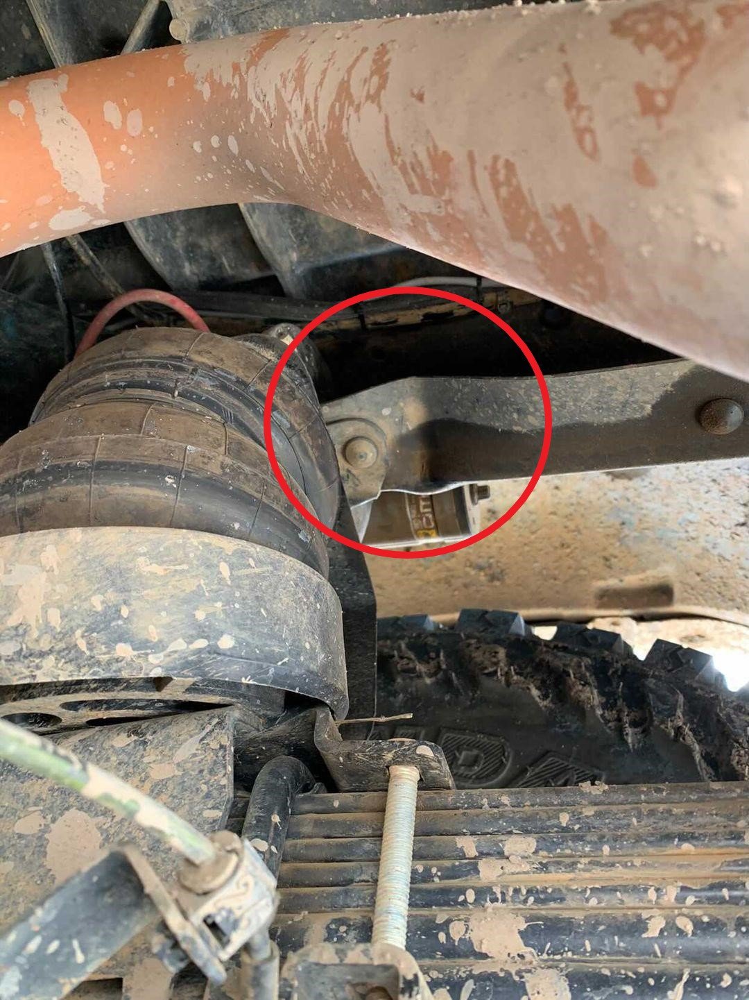

    I've had similar thoughts. The reason it is somewhat offset under frame rail is the air port in the top of bag. The offset is greater on the leaf springs because the springs are partially outboard from the frame.
    The cross beam idea is good, but the exhaust would have to be chopped, and you also have brake hard lines inboard of the springs.

    The damage I see in post #934 looks like a serious case of gross overload. The admittedly stupid, overly thin Firestone bag supports are crushed - despite the serious amount of spring leaves (7?) in the picture as well. This is not a one ton truck like my old mine service vehicle. And my opinion as a mechanical engineer is that the damaged truck frame was not only overloaded - but deliberately (or carelessly) driven over rough terrain at speed. The bag was not fully pressurized when that hit occurred - physical contact of hard parts was involved - and a common rubber bumpstop wouldn't be the answer.
    I've had the bags on my truck - and others before it - for years, and never missed the factory bumpstops because I put them on rugged mounts and the bags were aired up to suit the loading. And the loading wasn't double or triple the truck's rating while buzzing down a rutted forest service road.

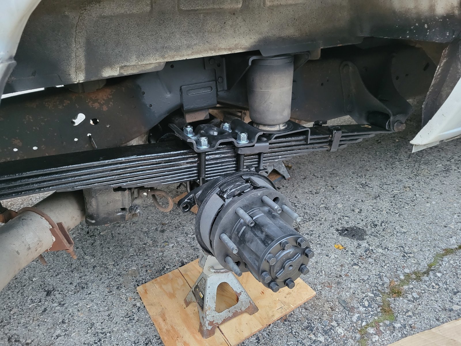

    You related how your setup (with your Daystar cradle wisely placed lower than most people) required 12 psi to eliminate bottoming:
    "On my own outfit, the height of the bag (collapsed) and the Daystar seat I put under it, ate up the allowable travel and made the truck bottom out more easily (crummy Toyota stocker springs are still in there). For everyday use (not jumping the speed bumps) as a daily driver - it took about 12 psi to eliminate the bottoming. I figure its going to take some different spring packs and a better shock to lower the pressure."
    Yes, you're correct, the instance was an off road use, but if you're not designing for that or even big on-road hits, then you allow a scenario where your frame will bend. Stuff happens on the road as well
    The leaf in the instance was not a very heavy OME Dakar, they have thin leaves.
    My Post #934 well illustrates how NOT having enough leaf spring AND NOT having a chassis bump stop lead to bent frames
    Owners who don't have air bags, but who have much more weight than the example I showed do not bend their frames off road. The facts are there
    With thousands of customers, we have data coming in to us, and I am only sharing what I have learned.
    My only personal experience with Firestone airbags was a very good one, they came installed on a 2002 Ford E-350 extended work van. BUT the chassis bumpstop remained in the setup, and would hit before the bags collapsed. This is where I gained experience that air bags can't compensate fully for a proper leaf upgrade.
    This pic was talken after replacing the stock pack with box truck springs (1 leaf removed) it actually road better with the beefy spring pack, and needed way less air to remain stable.

    What no one tells you is that due to the drastic loss of bump travel that results from this air bag kit, it means you must run around 12psi to keep it from bottoming out just around town, which forces lift.
    Fact: the stock unloaded Tacoma rear suspension has about 3.5"-4" of bump travel in rear if you include 1" of bumpstop compression, and there's exactly 5.31" (edit: verified) from top leaf up to bump bracket at stock ride height.
    The Firestone kit steals ~4" of that available 5.31" at stock rear height, leaving you only 1.31" of suspension travel!
    It's not a kit where you get to keep your cake and eat it to. (Air bag and upper mounting plate are 3" thick fully deflated, lower mounting bracket is 1" tall above main leaf, both total 4").
    Consider our Add-a-leaf, it's a good affordable solution, but it may lift depending on load.
