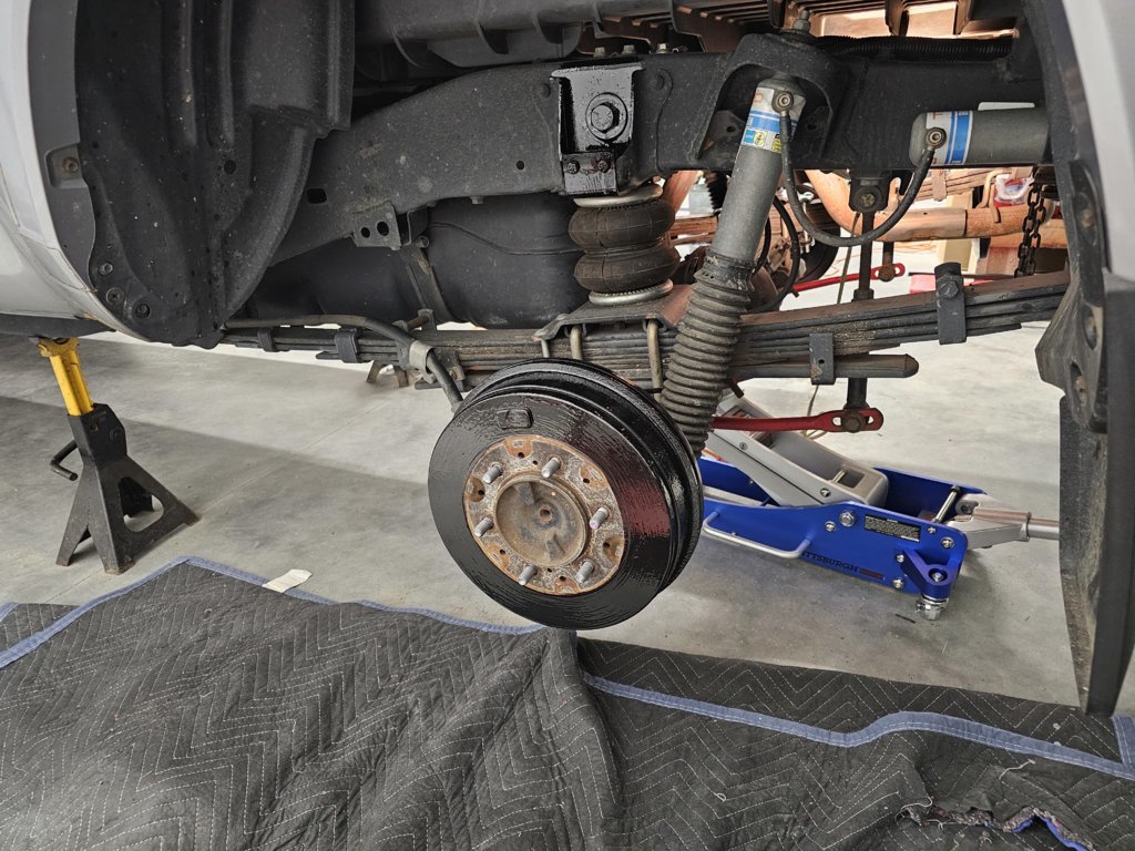

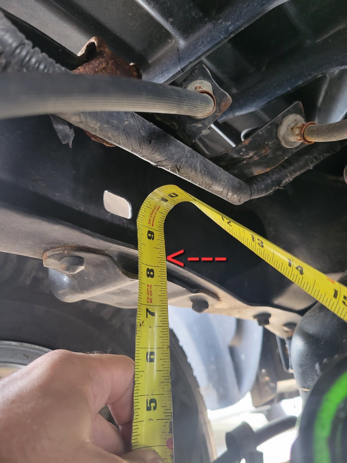

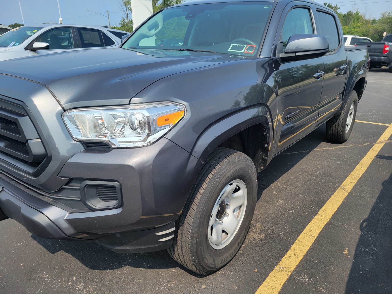

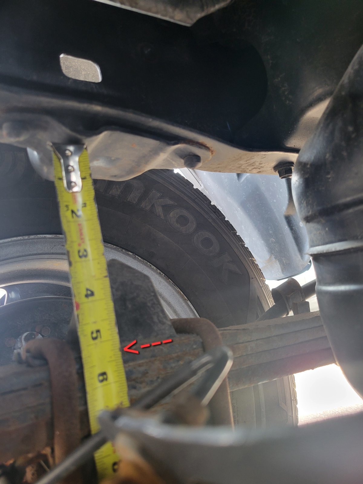

    Since someone deleted my post with actual measurements in it, trying to answer a direct question, Here are the measurements so anyone reading can understand and make educated decisions before purchasing this air bag kit.
    Measurements:
    Stock 6-lug rear lift height measures 8.25" from top of axle tube up to bottom of frame rail, I measured and confirmed on dozens of stock 2nd and 3rd gens at this height.
    At this stock height, there is exactly 5.31" from top of main leaf to the lowest point of bumpstop frame bracket, where Firestone kit mounts up to.
    Available space at stock height: 5.31"
    Firestone upper mounting plate thickness: .19"
    Firestone 6766 bag fully compressed: 2.8"
    Firestone lower mounting bracket height: 1"
    Daystar cradle thickness (if used): .75"
    Total Firestone kit height fully compressed: 3.99"
    Total Firestone Kit + cradle fully comp: 4.74"
    Therefore, if you desire to keep rear at stock height, you will be using up 3.99" of the available 5.31" space, leaving you with 1.32" of actual bump travel at true stock height.
    3rd gen DC at dealer with low miles on it
    Stock lift height measures 8.25" top of axle to bottom of frame rail
    Available space at stock height 5.31"
