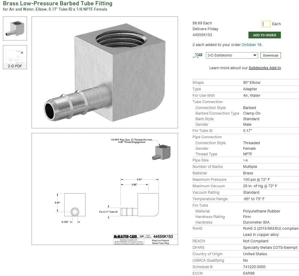

  12. Nov 1, 2024 at 12:34 PM
    #992
    shmn
    shmn Well-Known Member
    Aug 2, 2022
    #402702
    198
    Pacific NW
    2007 Tacoma 2.7L 5sp

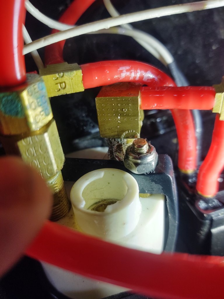

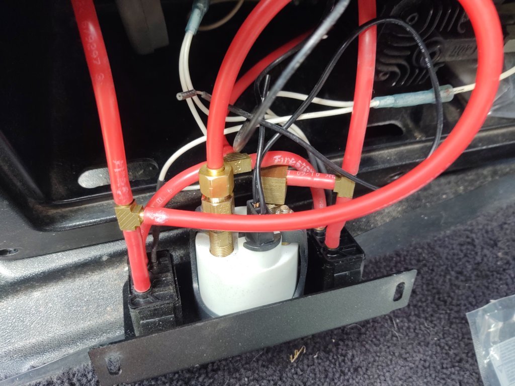

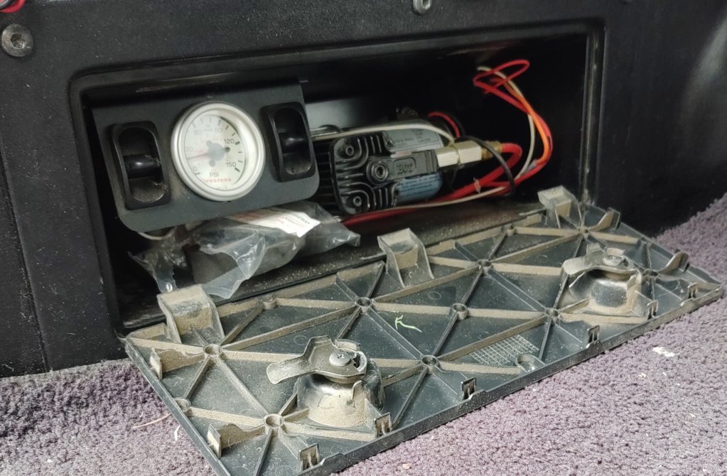

    Developed a leak on my driver's side airbag and after spraying the air bag and hoses couldn't find the leak. Then sprayed down the hoses and connections on the back of the panel and sure enough the brass 1/8" female npt to 90° 1/4" tubing nipple adapter on the back of the gauge had a crack in it (I wire wheeled it and then used a Dremel to bevel the crack as I thought I might try to braze or silver solder the crack...probably won't work but I'll try it when I have some spare time):

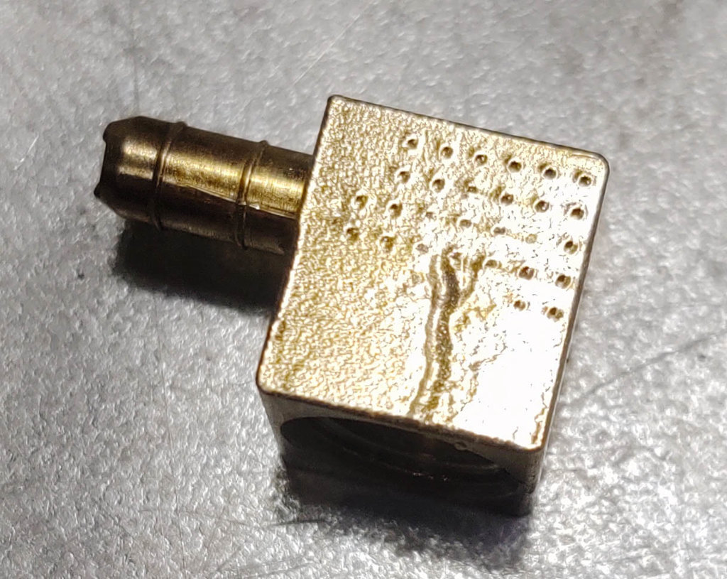

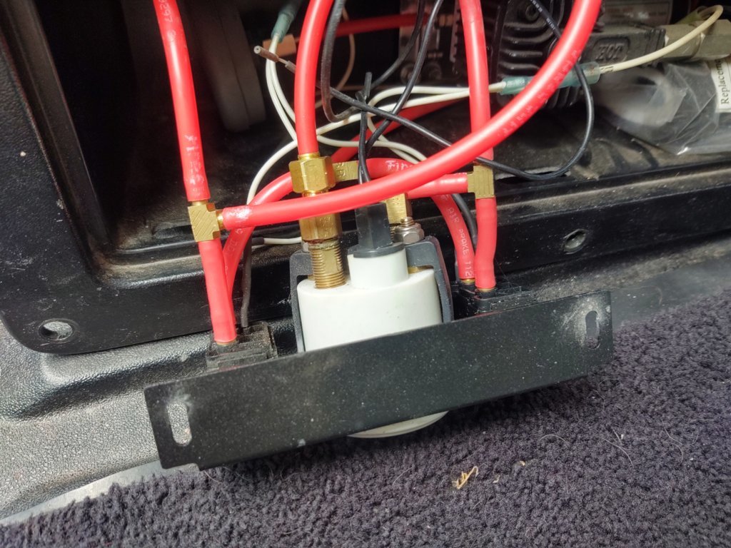

    Funny thing is I have the same type of air bag system (an older version) on my 85 F250 and had the same exact crack in the same fitting about 10 years ago. I guess the brass is very thin due to the design and maybe Firestone over-tightens these at the factory leading to the crack.

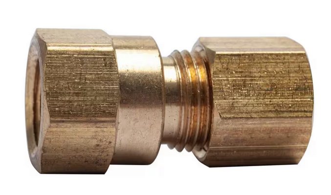

    Only place that seems to carry them that I could find is McMaster but shipping is $12 so I found an 1/8" female npt to 1/4" compression fitting in my spares kit and used it.
    Air bag panel fitting brass 44555K153 McMaster.png brass fitting air bags replacement.png
    It's straight and not 90° but with a large bend in the tubing it works out plus these fittings are easy to find compared to the internal barb counterpart. And I replaced the brass ferrule with a plastic one and used an insert in the tube to prevent collapse. And it works fine.
    Anyone else have issue with these fittings cracking?

    I switched to the same brass compression fittings with nylon ferrules and brass tube inserts and no leaks since. I was using ptc’s before but got tired of chasing leaks from finicky cuts.

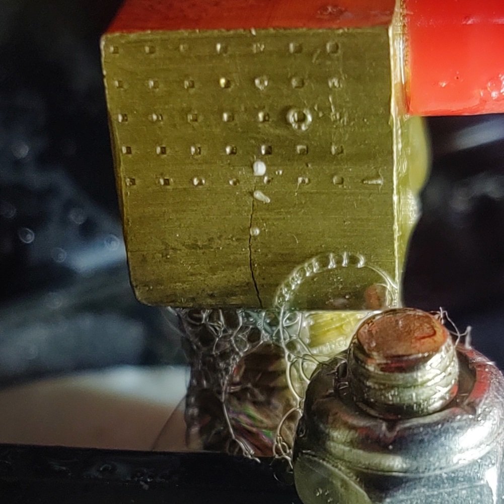

    Well, 3 months later the same problem just happened on the passenger side fitting. That's 3 fittings out of 4 (on two control panels on two different trucks) that have cracked on me. Sure looks like a poor design (walls too thin on brass fitting). I don't think they were over-tightened because they removed easily and looking at them, it appears to be more of a design problem then torque problem.
  18. Mar 5, 2025 at 12:08 PM

    sorry that happened, how did you notice the leak? did you notice a significant jarring ride due to the low pressure?
  19. Mar 5, 2025 at 1:08 PM
    #999
    bagleboy
    bagleboy Well-Known Member
    Aug 5, 2017
    #226018
    7,264
    Scott
    Norcal, Santa Rosa
    2014 5-lug AC 2.7L VVTI
    Snug top Rebel, Thule tracks, ditch tracks, Bagged rear suspension, F/R anytime camera, intermittent wiper switch...
    I use solenoid air switches to isolate each air bag individually from the fill setup. That way any leaks up stream can only be in play while actually filling. Once the pressure gauge hits my desired point I close the solenoids and kill the supply. I Only need to be concerned with 2 fittings on each bag, the one at the solenoid and the one at the bag. Since I’ve switched to brass compression fittings with inserts and nylon ferrules it doesn’t leak at all.
  20. Mar 6, 2025 at 10:52 AM
    #1000
    shmn
    Aug 2, 2022
    #402702
    198
    Pacific NW
    I could see the rear of the truck leaning to the passenger side.
