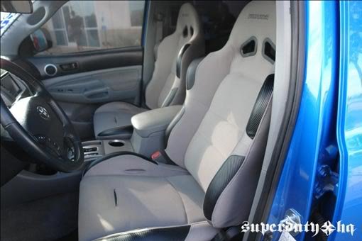

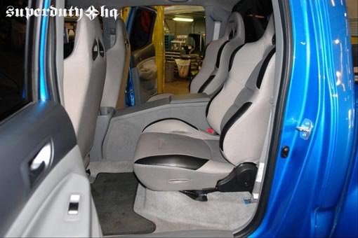

    If you want more info, call SDHQ. this is one of their projects done on an 05+ that looks pretty sick. its got front and rear with a custom center console in the rear.
