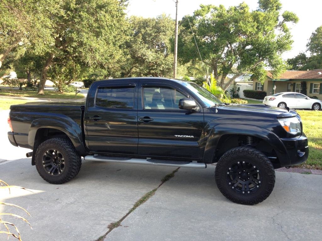

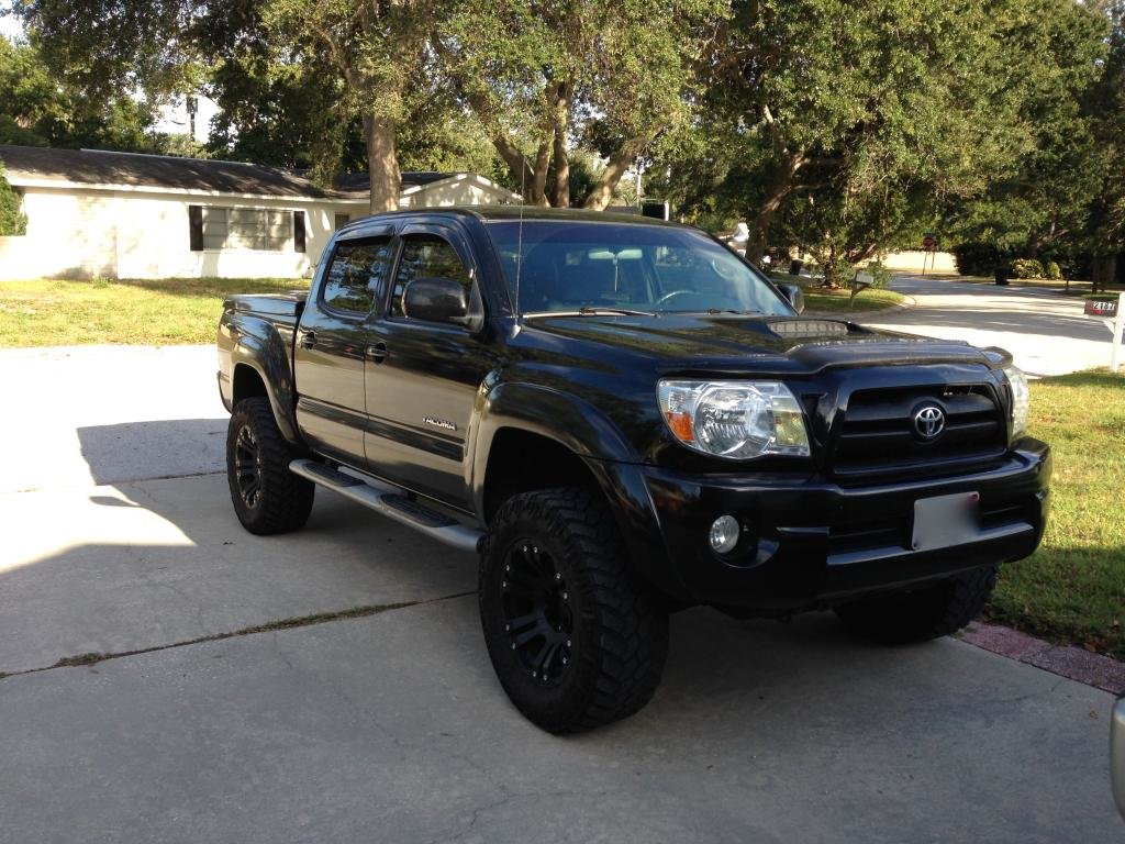

    Hello Forum,
    RIDE HEIGHT ORIGINALLY:
    with stock suspension
    & 265/70r16:
    LF 34.00 RF 34.25
    LR 35.25 RR 35.50
    RIDE HEIGHT NOW:
    with Billstiens @.85,
    '12 OEM 3/1 leafs,
    Wheelers 3 leaf AAL,
    OEM overload leaf,
    & 265/75r16 BFG A/T's:
    LF 36.00 / RF 36.00
    LR 39.00 / RR 39.00
    RIDE HEIGHT (hub to fender)
    LF 21.25 / RF 21.25
    LR 24.25 / RR 24.25
    OEM STEEL WHEEL:
    Dimensions:: 16" x 7" with chrome wheel skins.
    FYI, I replaced my original 2/1 pack with these 3/1 leafs. It came off a 2012 with 5K miles on them. It took 2 days of rough driving for them to settle and they have been at this height ever since. Very slight shudder between 12 & 22 but it's been like that for a while and no issues.
    Thanks

    UPDATE:
    I lifted the front Billie's to 1.75 from .85. It still has rake which I want. I don't want it level or nose high.
    RIDE HEIGHT NOW:
    with Billstiens @1.75,
    '12 OEM 3/1 leafs,
    OEM overload leaf,
    LF 37.00 / RF 37.00
    LR 39.00 / RR 39.00
    LF 22.25 / RF 22.25
    LR 24.25 / RR 24.25
