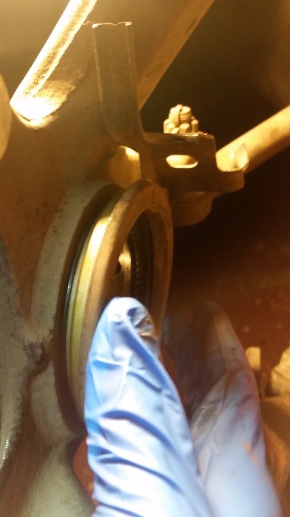

    tpp4

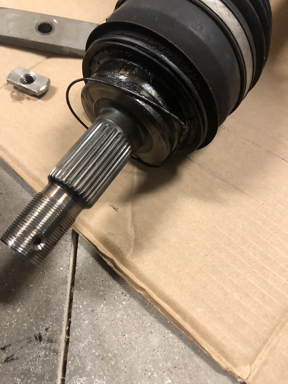

    Anyone know where this O-Ring could possibly be from? Didn’t think there was one on this side of the spindle.
    Doing the ECGS bearing install and this came out when I pulled the axle out.

    I dont remember seeing an o ring like that on any of the ones I have swapped. However it looks like it would sit in the groove left of the flange.

    Interesting. I’ll see if it fits back up there. I’m trying to avoid taking off the hub assembly to see if the O-Ring from there somehow weaseled it’s way out.

    There is also a dust seal that goes into the hub area I forgot about but it has a oring or gasket to prevent dust from going into the bearing...

    Upon further inspection - it’s actually a metal spring o-ring, and not rubber . Does that change anything?

    That came out of the seal, they don't cost too much and are fairly easy to install

    Thanks, man. Any way you can show me exactly where I’m looking to install it? Is it on the CV axle itself or the seal on the spindle?
    I’m not great at this stuff, so any help is greatly appreciated.
