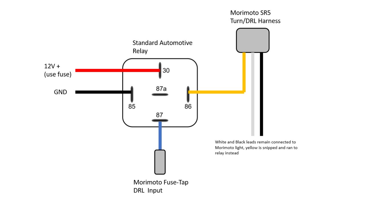

    I took some time today to figure out how to use no fuse tap on the Gen 2 Morimotos for my SR5. Although I can't verify whether this result will function the same on the TRD, I did find a simple way to make it work on my rig by using an automotive relay.
    I want to note that in my original post, I mentioned that on the Morimoto turn/DRL harness, the white wire was DRL and the yellow wire was turn. This should be REVERSED. I will be making an edit to that after posting this. Nothing would have gone catastrophically wrong if it was done like that, but the functions of the lines would have been reversed. I do apologize for this confusion for I wrote the post quite a while after I was fiddling with the unit.
    To have the white band DRL on the SR5 without using the fuse tap, see the wiring diagram below. The new start sequence also works with this wiring when you turn the headlight stalk from the OFF to DRL position which is incredibly nice. I did try this without a relay, and like TRS said, it draws too much amperage, so the DRL will flicker and/or cutout. I'm still not sure on why the orange band works fine without one. Please use best practices if you perform this job such as soldering iron & heat shrink (not crimp connectors), unplugging the battery before touching wires, and making a plan BEFORE cutting. Good luck!
    Here is a side-by-side between the standard Morimoto wiring without using the fuse-tap & the new relay circuit. The video takes place right after I switch the headlight stalk from OFF to DRL position (the DRL sequence is shortened because I had to run in front of the truck after I switched it on so half of it was missed).
    I won't be running the white-band DRL because I prefer the orange, so this experiment was done using temporary spliced connections. I will not be able to post any more pictures or videos unfortunately. In the future, I would prefer Morimoto add one of these <$5 relays to their units and scrap the fuse tap entirely because hooking up a PWR and GND doesn't seem any harder than a fuse tap IMO. It's well worth it for the proper functionality and less headaches.

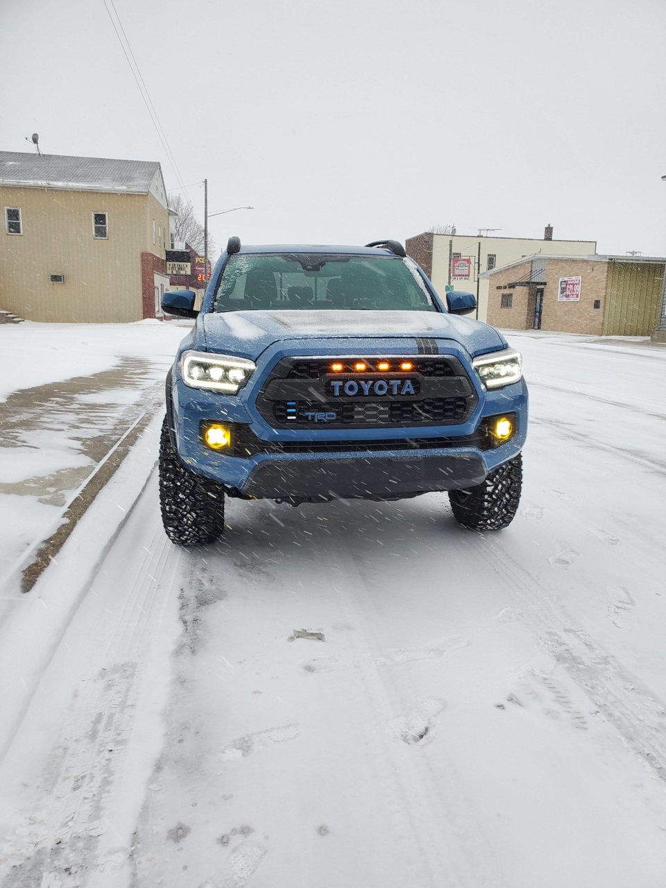

    My SR i believe is the same as SR5 wiring and aesthetics... Mine worked fine, running, DRLs (Amber),H/L low and high, the only thing I needed the "DRL Tap/splitter for is the Dual Bright White DRLs...to use that I turn my lights to DRL Auto/Off then with the Tap ruining off of the EFI circuit, they power on and off automatically during the day for D/B DRL and I manuelly have to turn H/L on
    Im very content on just running them on Auto and then I can turn them OFF when I want to blind someone with the Dual Bright
