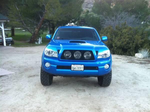

    looks awesome! ive been wanting to put 4 hellas behind my grille

    Just put mine on!

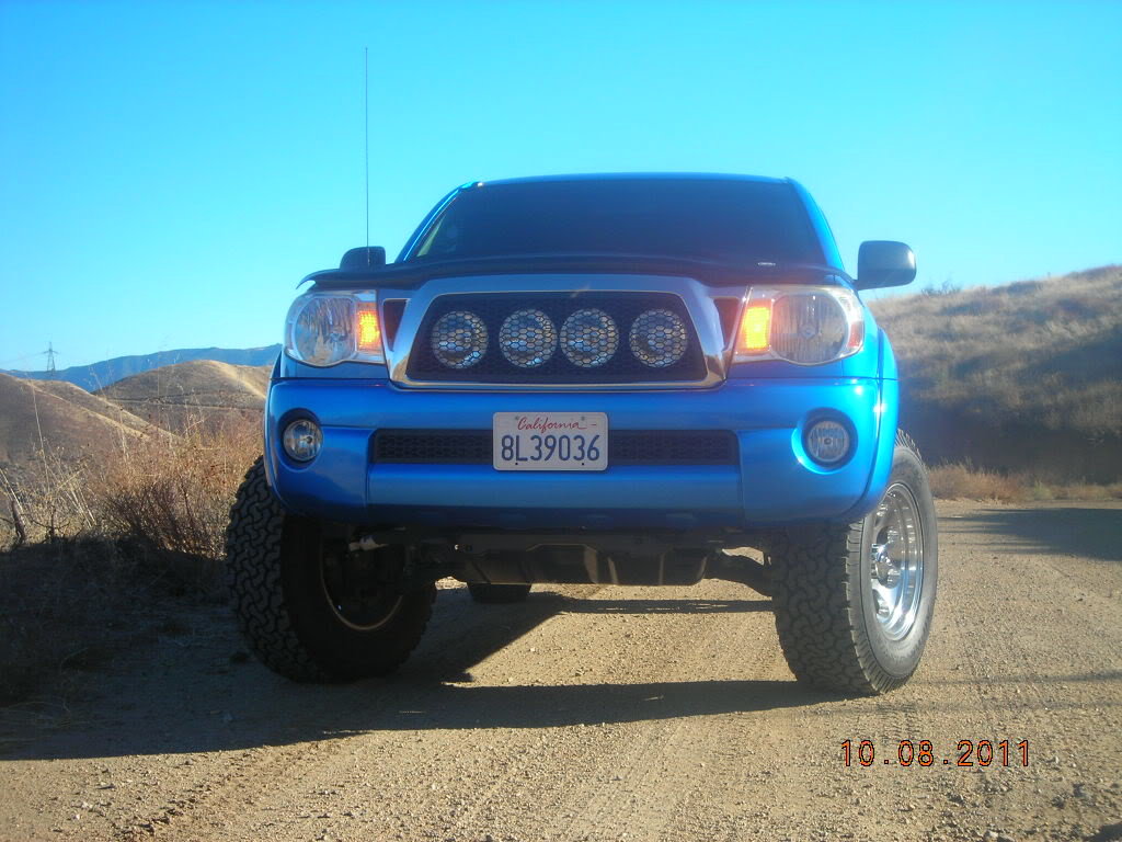

    Looks familiar.
    4 hella lights are ok. Going with led bar instead. But the light bar behind the grill is the way to go.

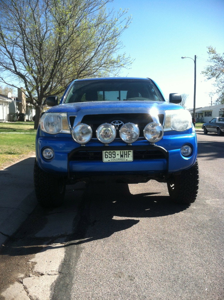

    Jimminy Christmas, your truck looks like my trucks twin even down to the rims. It also looks like you off roading in the mountains of San Diego, which is my old stomping grounds.
    What Hella lights did you get?

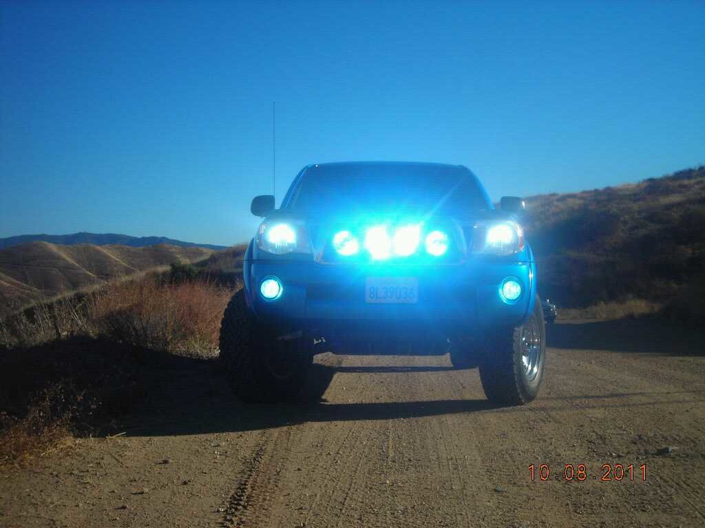

    Great minds think alike. Or so they say. They are just cheap hella 500's converted with some cheap hids. I have 4 Lightforce 170's still sitting in a box I was going to use but probably going to go led.
    Not San Diego. I wish I was down there again. That is a fire road between palmdale and santa clarita. Rowher flats to be exact. I like the bar out front too. Friend has that setup as well.

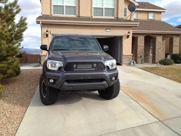

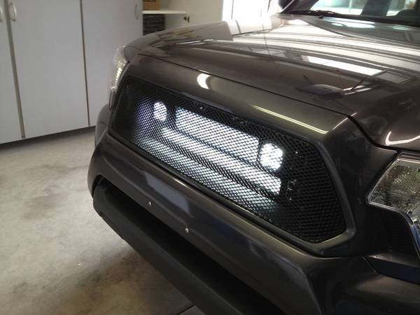

    11,360 lumens!:eek:
  10. Feb 20, 2013 at 4:33 AM
    #30
    DevL
    DevL Well-Known Member
    Feb 23, 2010
    #31952
    1,922
    Is that for all the light bars together? Isn't 4 Hellas with 50w HID kits 20,000 lumens?
