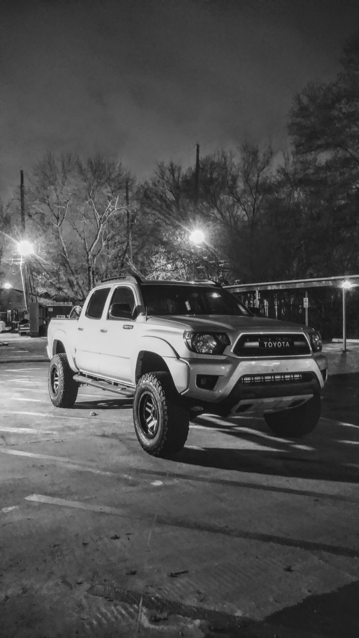

    I'm on -12 on a 9in wheel. Added a 1.25 in spacer.
    No issues. 3.5 in lift aswell

    Previous wheel setup I had a 0 offset same spacer and no issues.

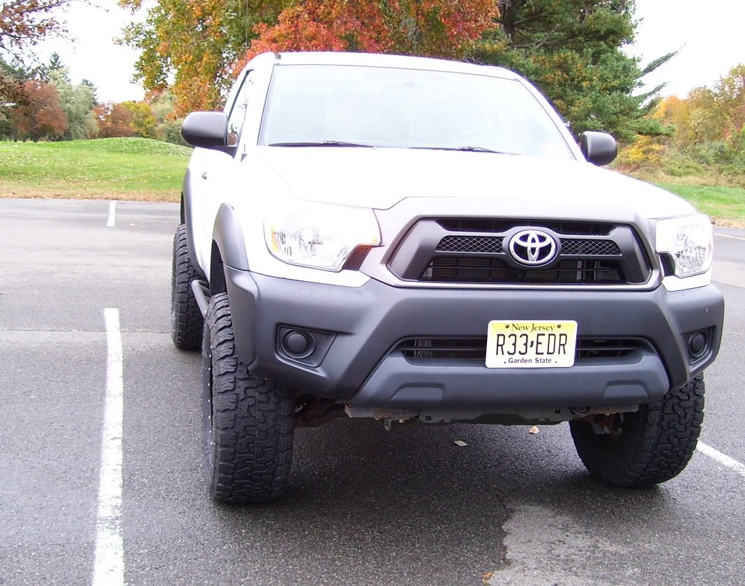

    If you go with an 8" wide wheel, 0 offset will work fine and keep it tucked in a bit. An 8.5 or 9" wheel should be -6 or -12 offset. If you want it to stick out more then go with -19 to -25 offset but that will probably rub the cab mount.
    My wheels are 17x8.5 with -10 offset and 305 tires so you can see they stick out a bit and they rub on the mount a little at full lock.

    No, I have the SPC UCA's which help push the wheel forward. Those wheels with the -25 offset really stick out pretty far which is why they rub. My truck had the 16x8 with 0 offset but also had 1.25" wheel spacers and they rubbed so I removed the spacers. I sold those wheels and got the 17x8.5 that I have now.
