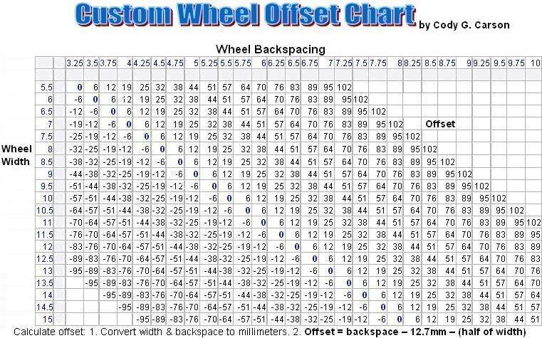

    I'm new to the backspace terminology. I've always used offset. 0 offset is a mounting surface in the exact center of the wheel width. From what I can tell backspacing is the depth the mounting surface is from the inside edge of the wheel. So wouldn't an 8" wide wheel with an offset of 0mm have a backspace of 4"?

    That's exactly what I thought at first too, it makes sense. Problem is an 8" wide wheel is 8" where the tire mounts, outside to outside is actually 9". This is why an 8" wide wheel with 0mm offset (you're also correct there, means the mounting location is dead center) is 4.5" back spacing rather than 4.0"

    Outside edge of the wheel for backspace...
    Rim width is 1" lower than wheel width.
    eccracer104 likes this.

    Industry standard is to add 1"; 1/2" for each flange.
