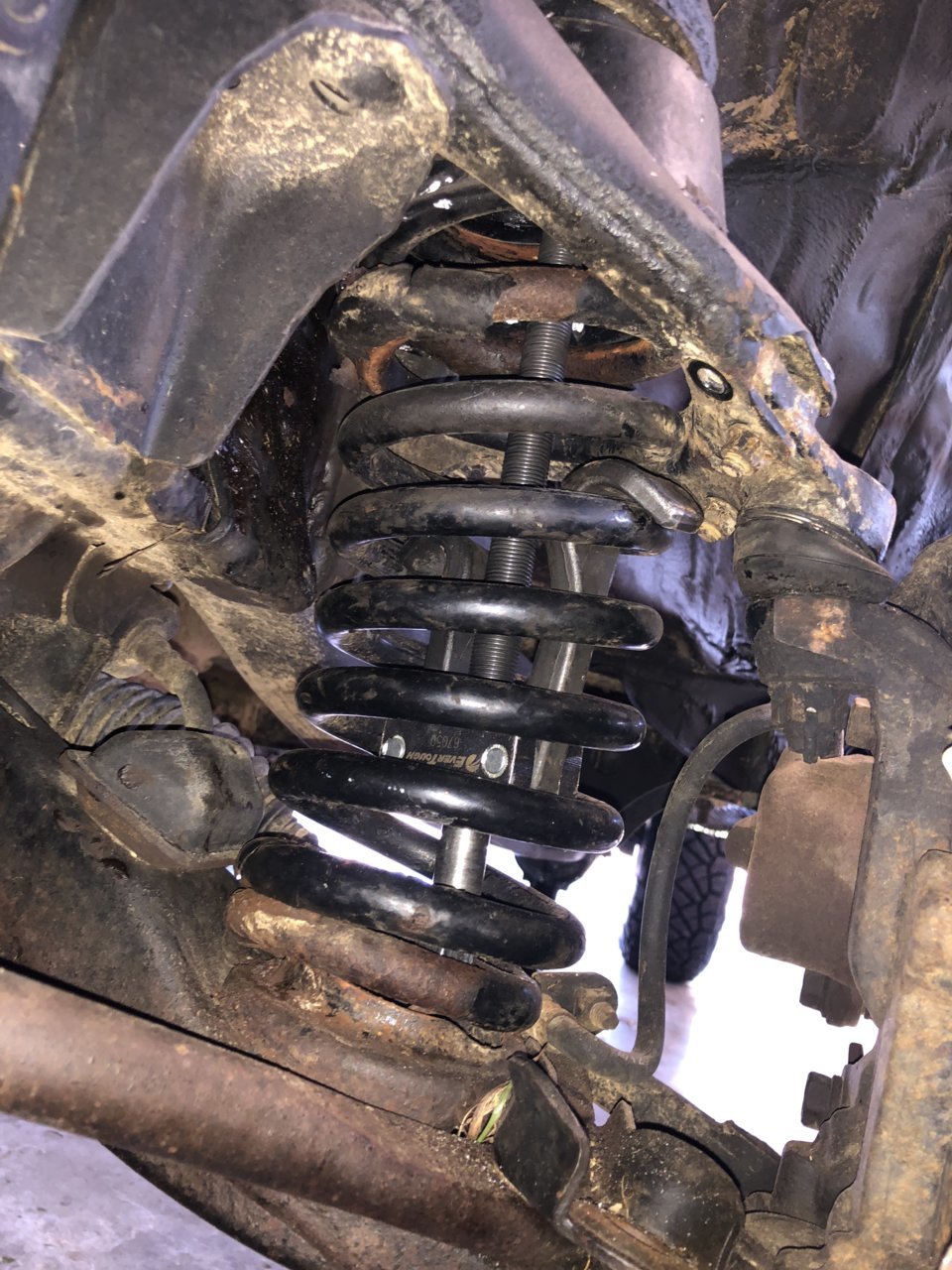

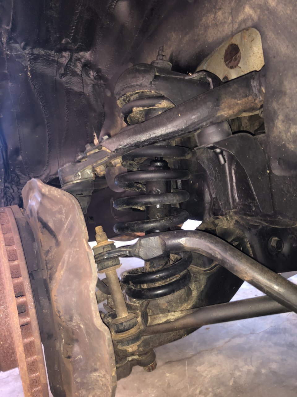

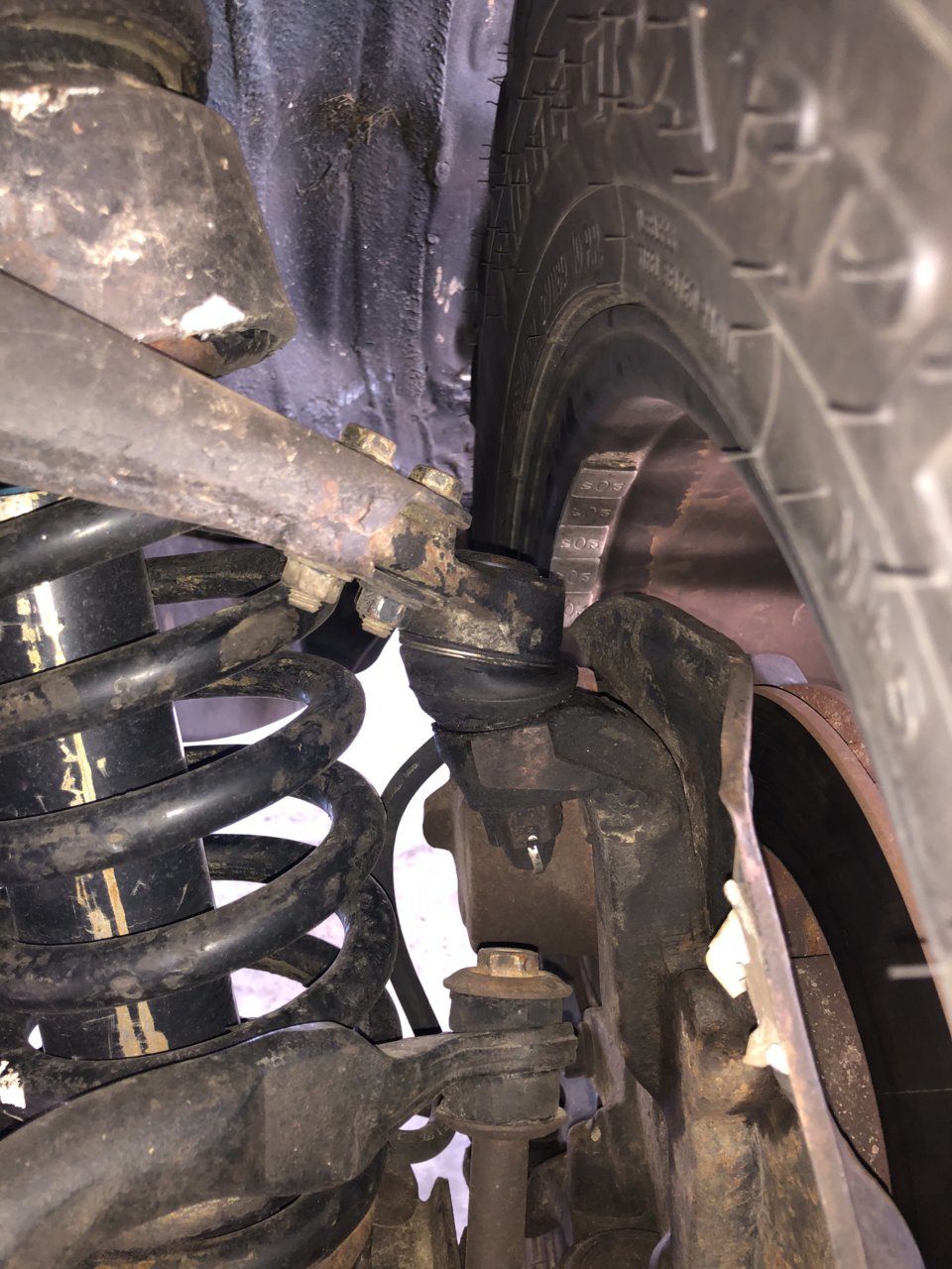

    okay so the wheels are on i can breathe. Looks good so now what? The first and main problem was rubbing, really bad rubbing. I need to purchase spacers as my tires do rub frame at full lock but that rubbing is manageable. The first few days i felt like i was driving a lowrider because every small bump my tires rubbed. I had to start researching different lifts commonly put on other trucks and couldn't find anything that seemed like a definite fix to my problem so i had to start experimenting. I bought and returned several coil spacers trying to figure out a way to get my front end to go up even a little bit but none fit or were even close to working. I am new to all of this so i really didn't know what to do i was stumped again. I painted all of the exposed area from where the fender was with undercoating and it turned out very clean (picture w lawn chairs).
    Now this is not a proud moment for me, and will most likely be the cringiest thing i could of done, but to raise the front end up ~2.5" ish i used pvc pipe adapter piece. I believe to remember it to be 3" to 4.5" and it fit perfectly on top of my spring. I rented a spring compressor from autozone and had a horrible time with that. (wasn't the tool that was bad but my coil spring was so small and had such little room to work with that it took a lot of wrestling and involved grinding the center of my LCA where the shock mounted to even fit). I needed to grind it down to fit the fabtech shocks anyways so it worked out okay but could be done a lot better. You can see the spring compressor in the second picture just all twisted and stuck inside my spring causing several headaches and lots of attempts to get out. Now The pvc piece has been in for about 9 months and i have had 0 issues. no cracking no nothing. I drive this truck hard and it has been sturdy all the way through. It even rubs on my UCA as i need to install the fabtech one that will give me more clearance but i just need to take the time to do it. (I purchased new UCA ball joints that will allow me to fit them now). This is not a permanent solution but it works. I'll attach a video of all of the pieces in motion. Also removed rubber bump stops to allow suspension to droop farther.
    Now this setup is second to none awful. Definitely need ideas and help to get more lift along with a safer more solid setup than this.

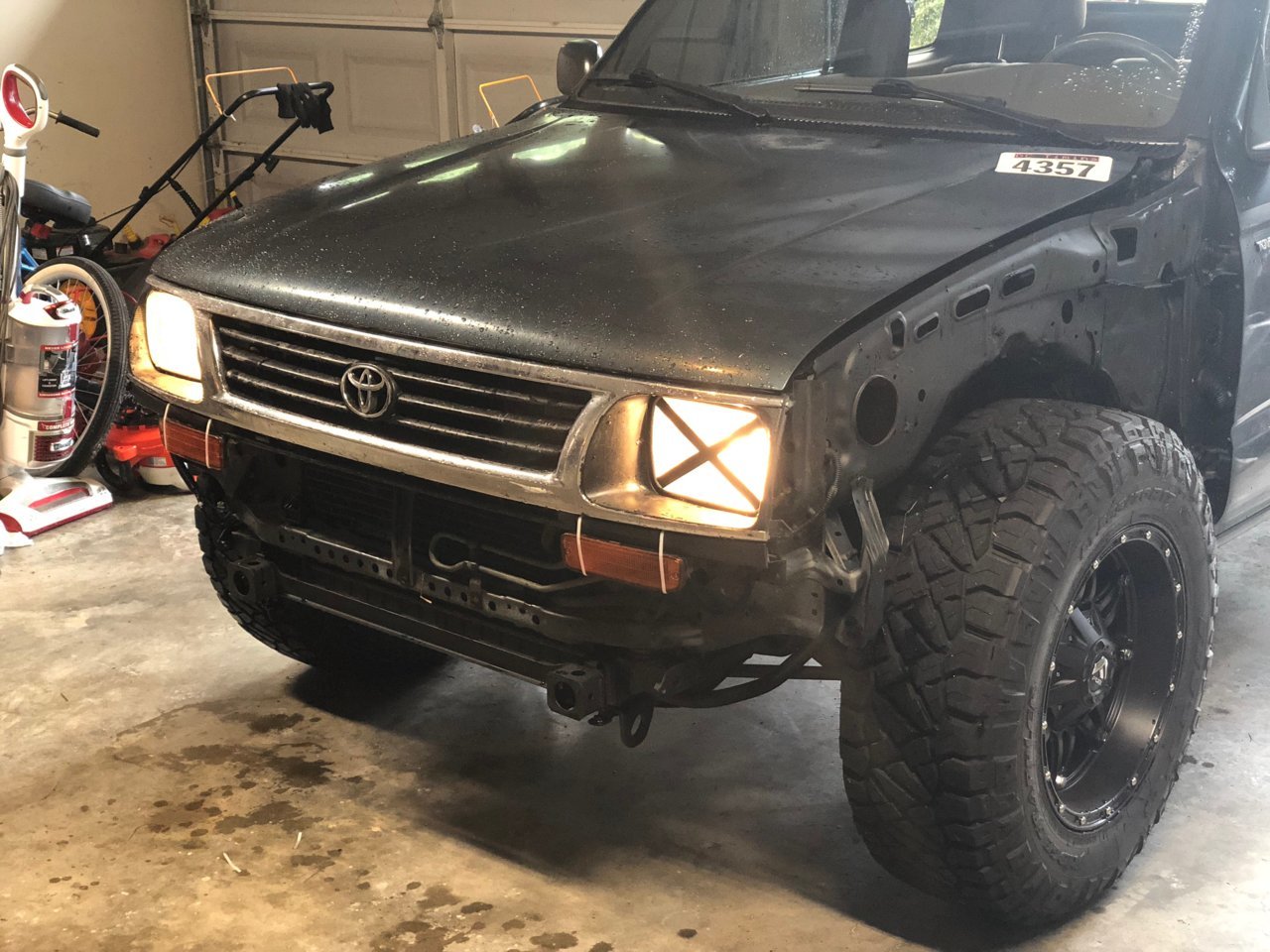

    This is the fender loosely mounted, lots of trimming

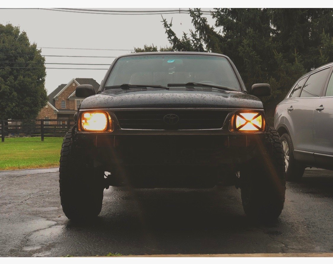

    Lights! So the original plan was to do the angry eyes on the stock headlights but i managed to drop and shatter one of the glass housings so that brought about the purchase of the LED lights. While i was waiting for the new lights i used clear packing tape to cover the housing and added an X in electrical tape for aesthetics. Didn't burn the two days i had it this way and worked for the time being. I bought the led lights off Amazon and are honestly way too bright for the road but you get use to being flashed every time you drive at night so i guess its okay. Just taped off and plasti dipped each side, turned out great from a distance
    These pics were taken before my lil spacer lift and look at how low it sat!!!!!
    housings just had two screws on the top and it was easy to unplug lights and plug in the new ones even tho the led lights i got dont really have brights or dims its either blinding or DRL's (tried rewiring them every way possible and couldn't fix)
