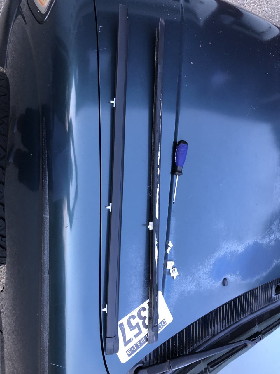

    Replaced that crappy weather stripping finally

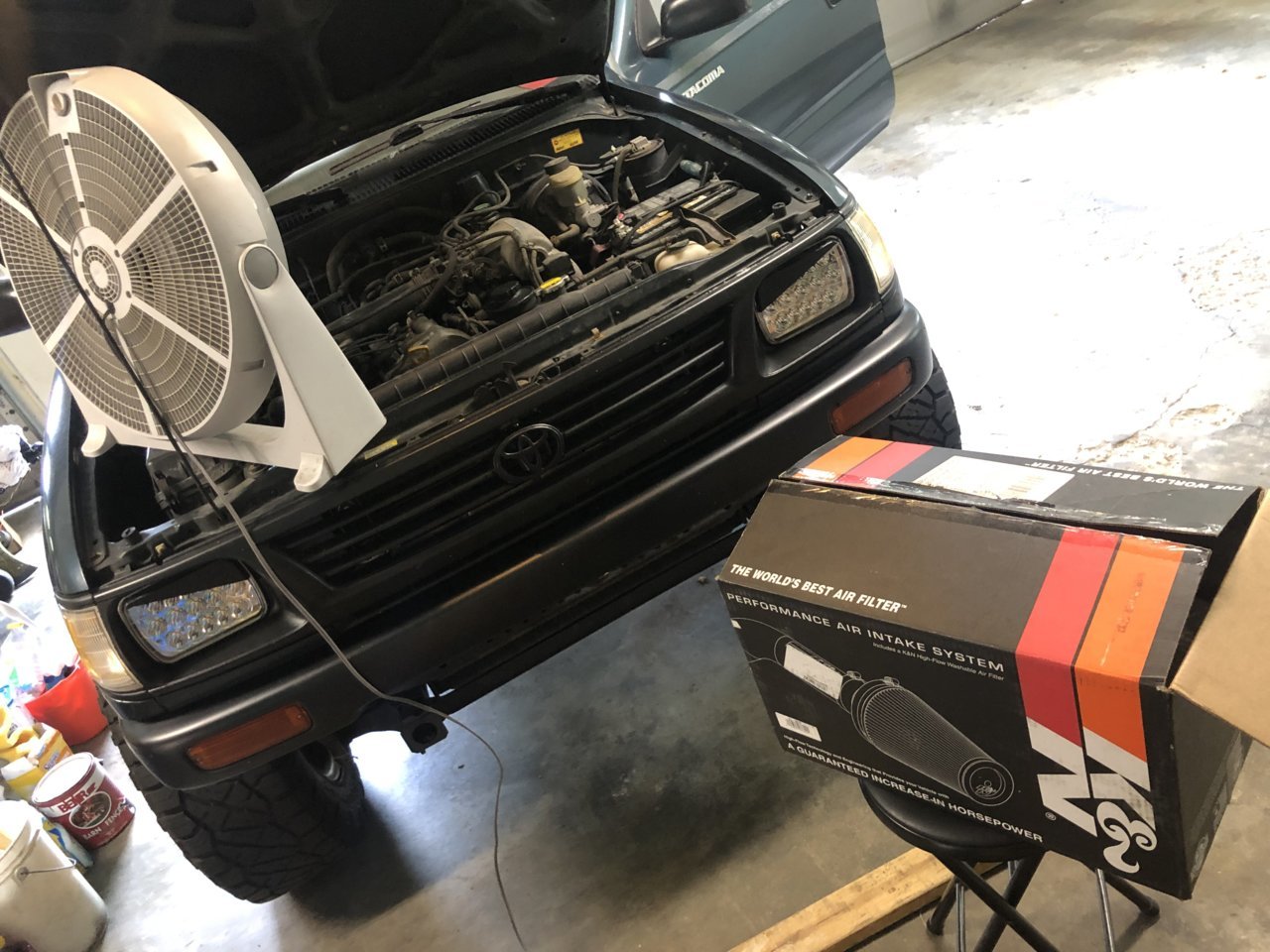

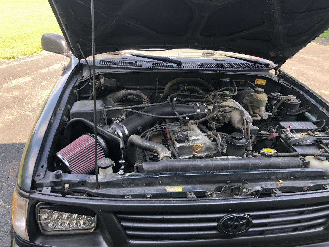

    Cold Air!!!!! Horsepowaaaa!!!!! Picked up more umph at higher rpms and looks cool, cleaned a little bit of clutter out of the engine and motivates me to do a deep clean of the engine bay sooner than later

    get er shinied up :cool:
    i use wd40 on the painted areas, nice and black
    some MrShine watermelon scented on the top of radiator after dirt removal, nice and black, also use it on fuse box cover
    most of my VC are buried so cannot do much with that unfortunately
    are you going to replace your vac hoses? I am currently changing mine with a silicone kit from TW thread

    yes i plan on stopping and spending an afternoon replacing all of my hoses in engine bay i just haven't had it as a priority and everyone on TW knows how that goes aha. It will be done one day, i am hopefully having the new headers i ordered come in this week and have the exhaust installed before i strip everything apart for paint.

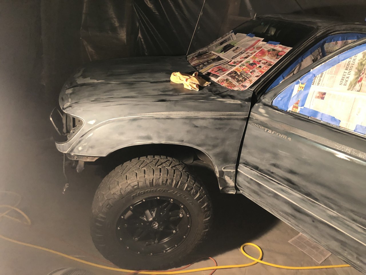

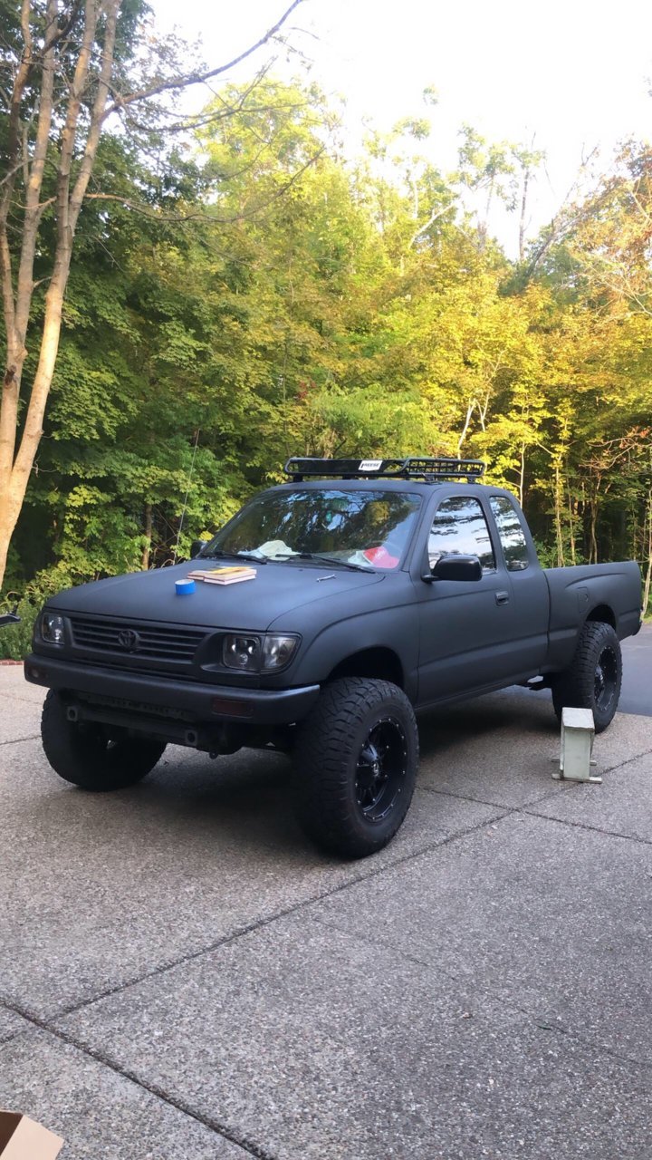

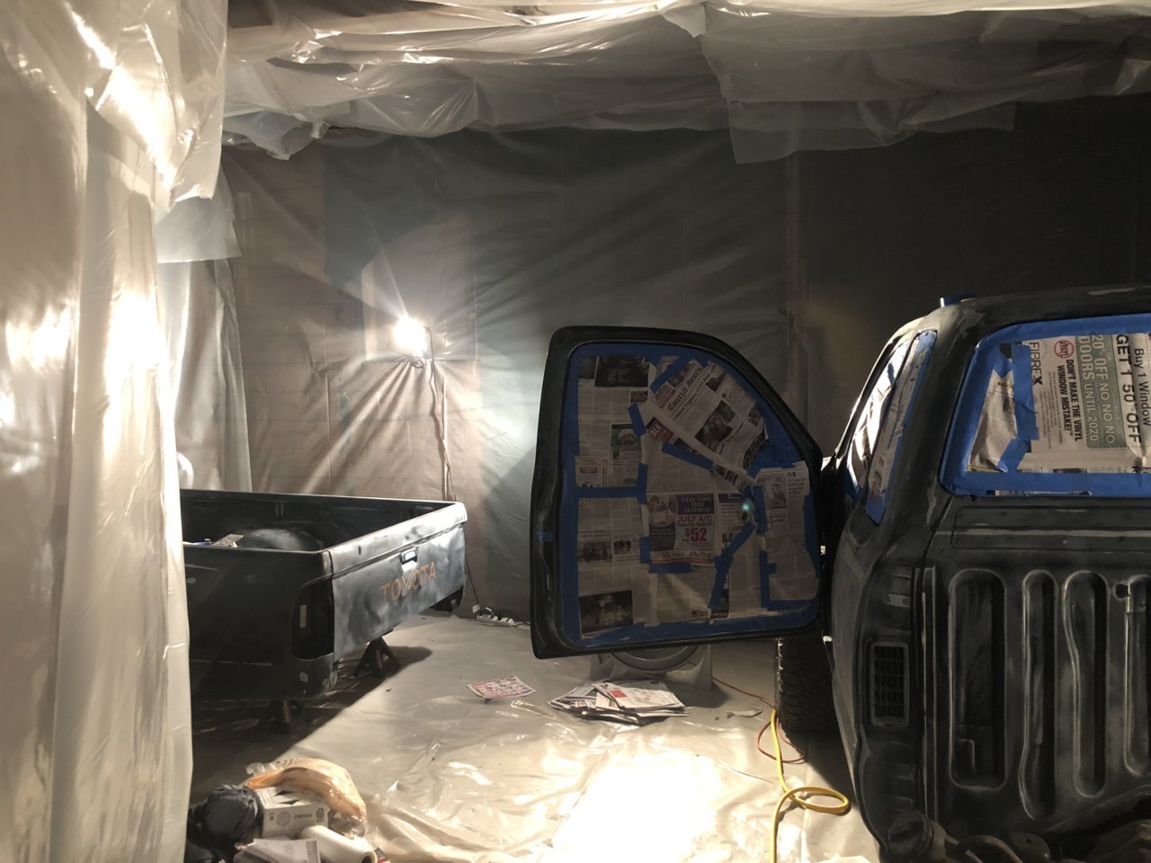

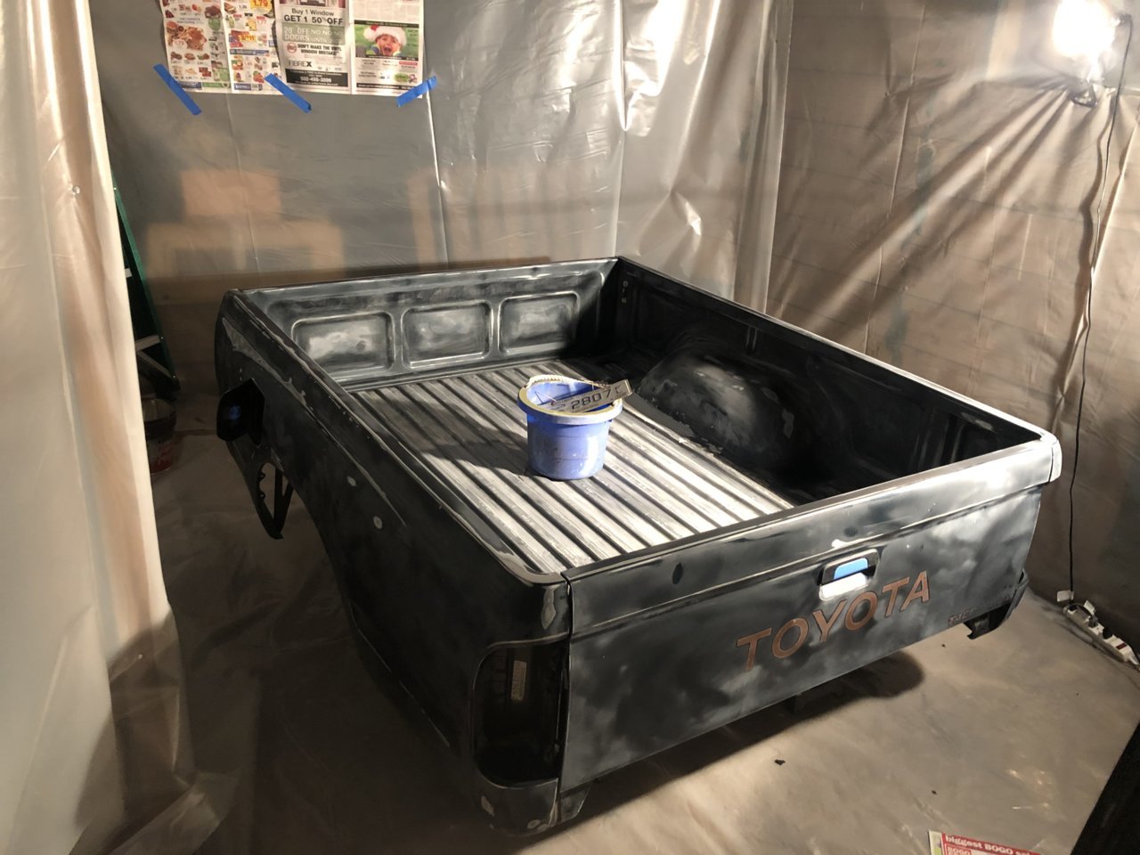

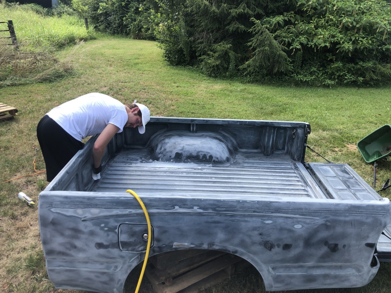

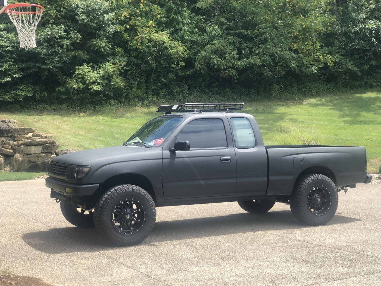

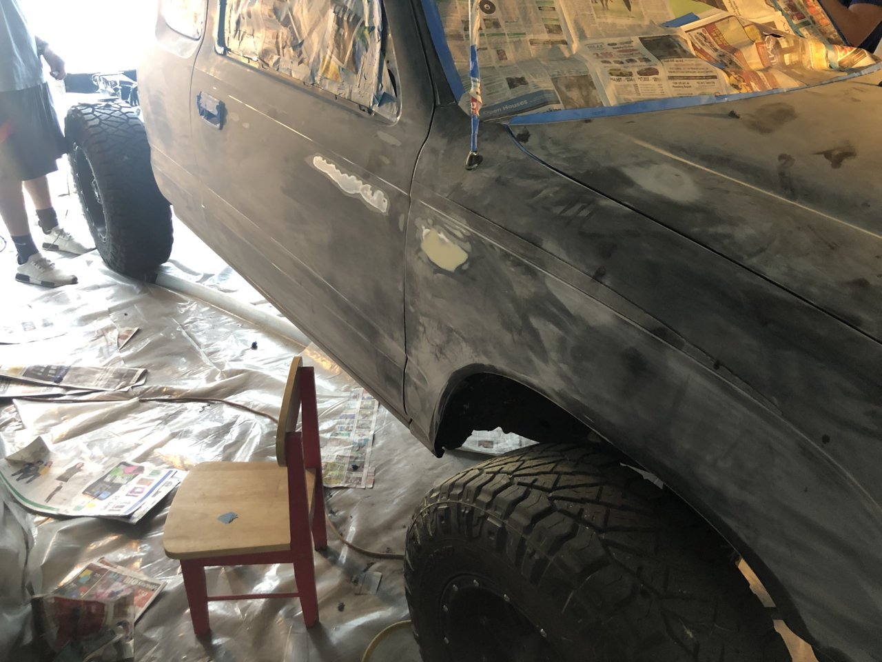

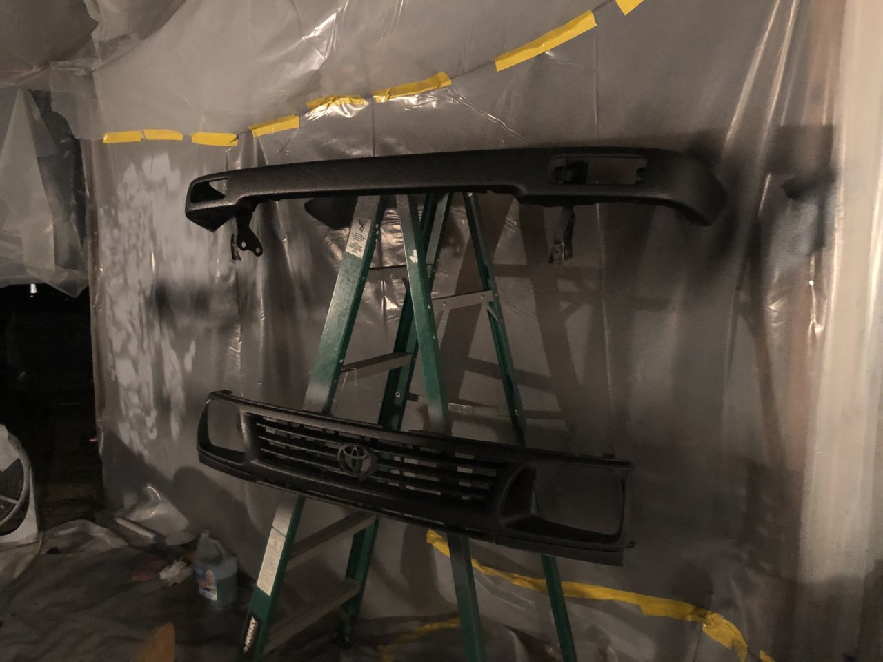

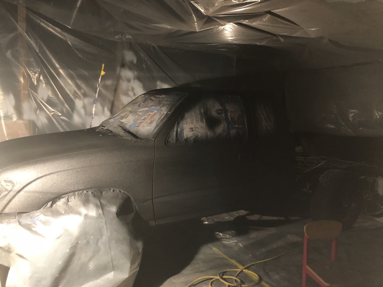

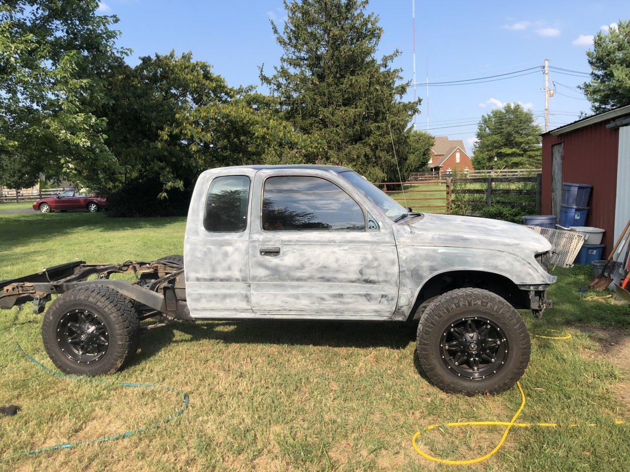

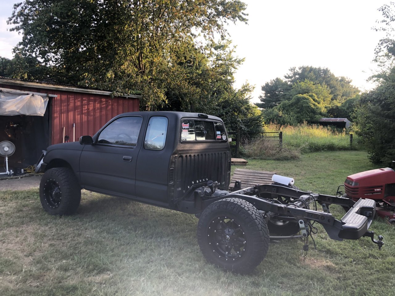

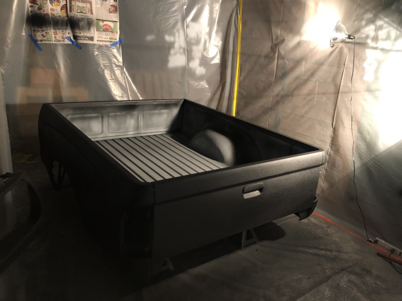

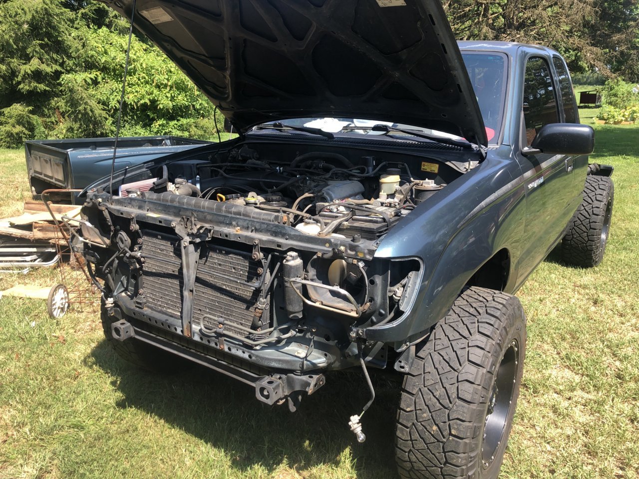

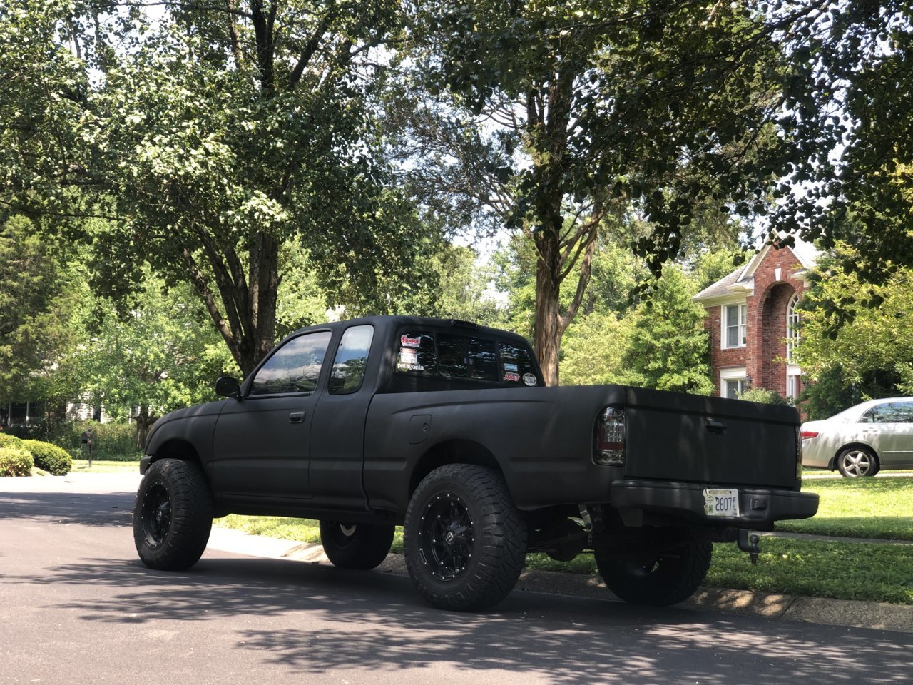

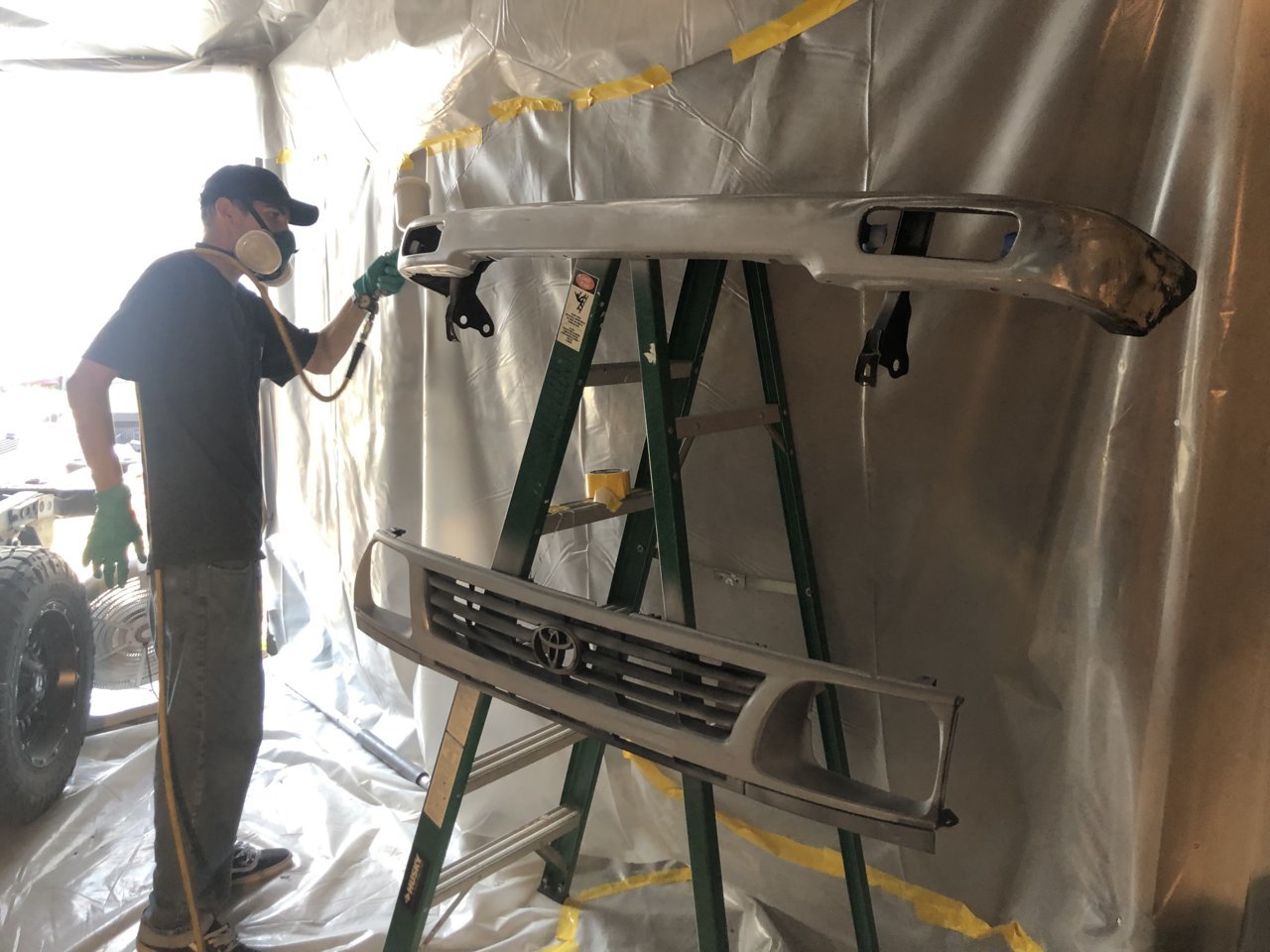

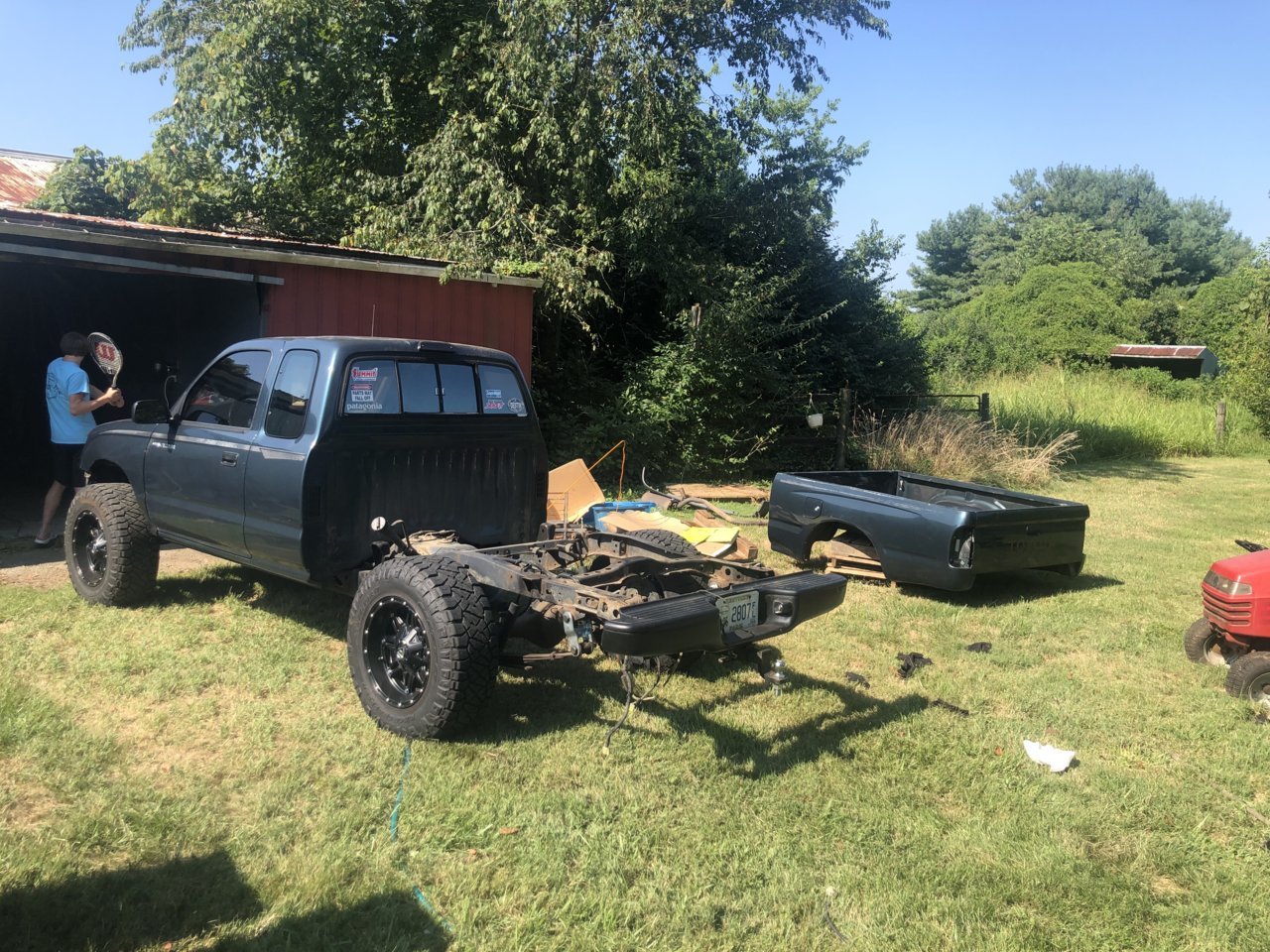

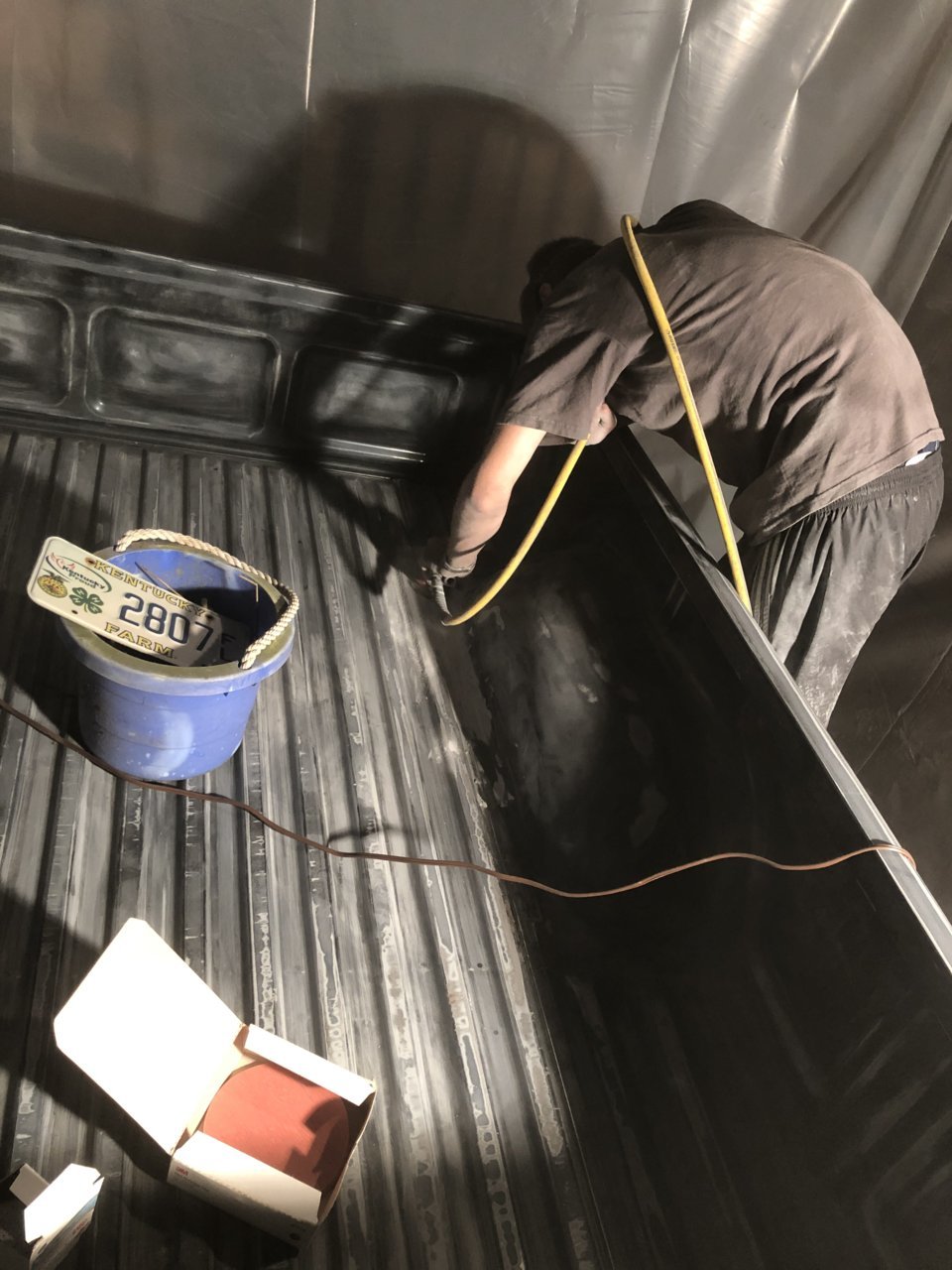

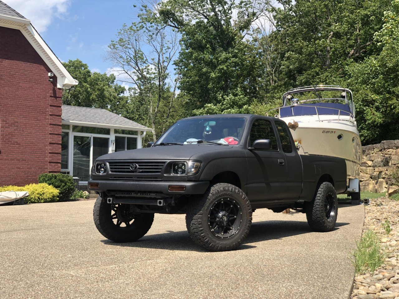

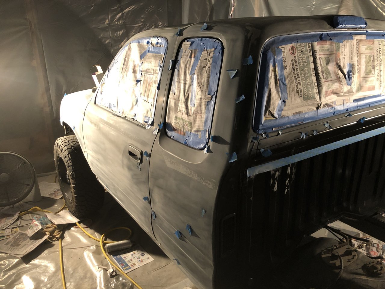

    I gathered all the remaining dollars in my bank account and i took a leap for glory... Ladies and Gentlemen i present to you the all new and improved taco. Bedlined black and oh so smooth fixing all the dents and dings scattered across this old body and with a week turnover it came out as a brand new truck. almost.

    Looks great! Can't say I'm not going to miss that green though haha.

    I am greatly going to miss that green where it all started but it was in need of a new start and i think this black will feel more at home when i get the roof rack on and experiment with replacing badges.

    The black definitely looks good and the bedliner will be easier to take care of as well. What kind of bedliner did you go with and did you spray or brush it on?

    Used the raptor bedliner, sprayed it on at 80 psi with the included gun. I purchased a kit off Amazon that was 6 liters, covered all outside of the truck but still needs 1 more coat so i purchased an individual liter for that. The bed has not been sprayed yet because i purchased another 4 liters off amazon but accidentally purchased the "tintable" version so i have to go get black paint tint to mix in it but unfortunately i busted open my knee and can't really drive the truck at the moment (pushing that clutch in is not my friend) so it will get finished 100% soon and id say i spent roughly ~$400 to cover the whole truck, and there are imperfections because, well, i've never painted a car before but i say it turned out good enough to be presentable. Learned a lot along the way and don't regret doing it yet lol.

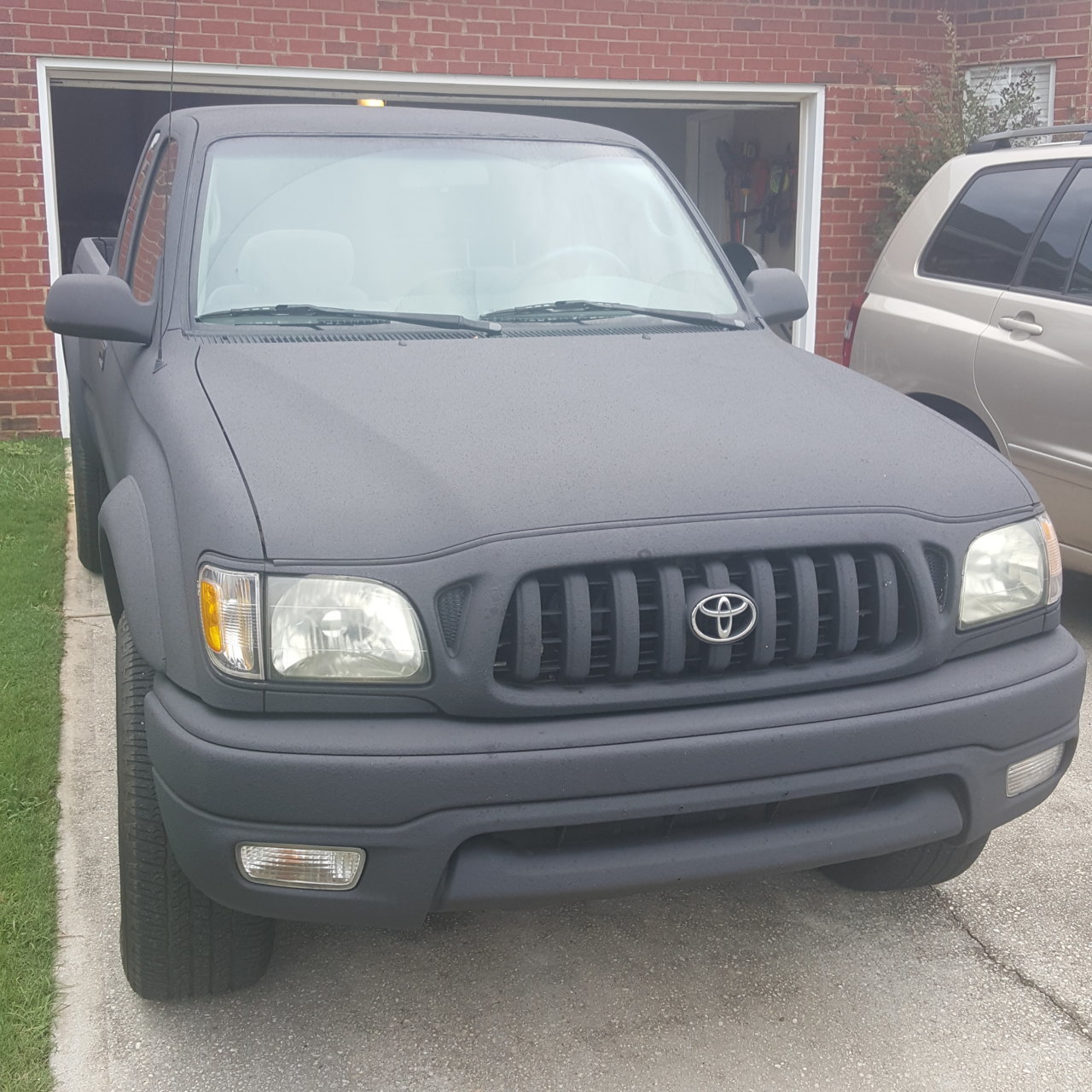

    Cool thing about bedlining is you easily spray paint it whatever color you want later and it wont look so flat and shitty

    Found that out quick doing touchup spots with black spray paint works perfect! lol

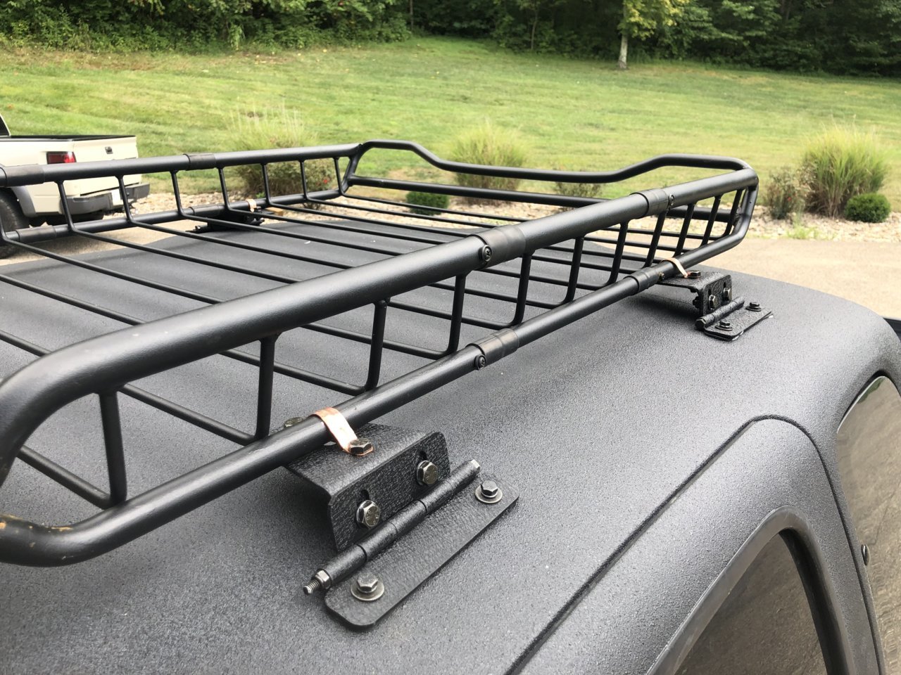

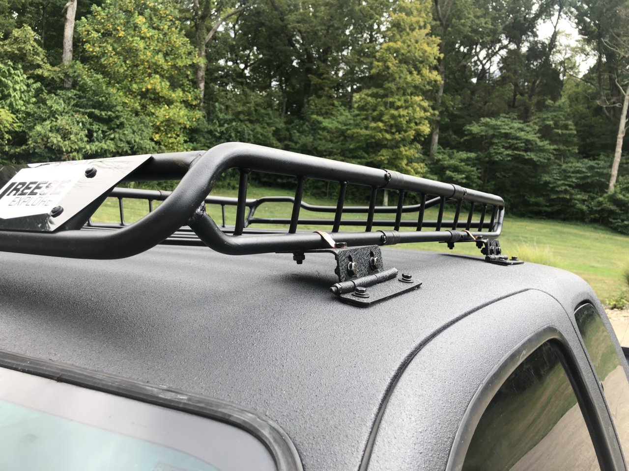

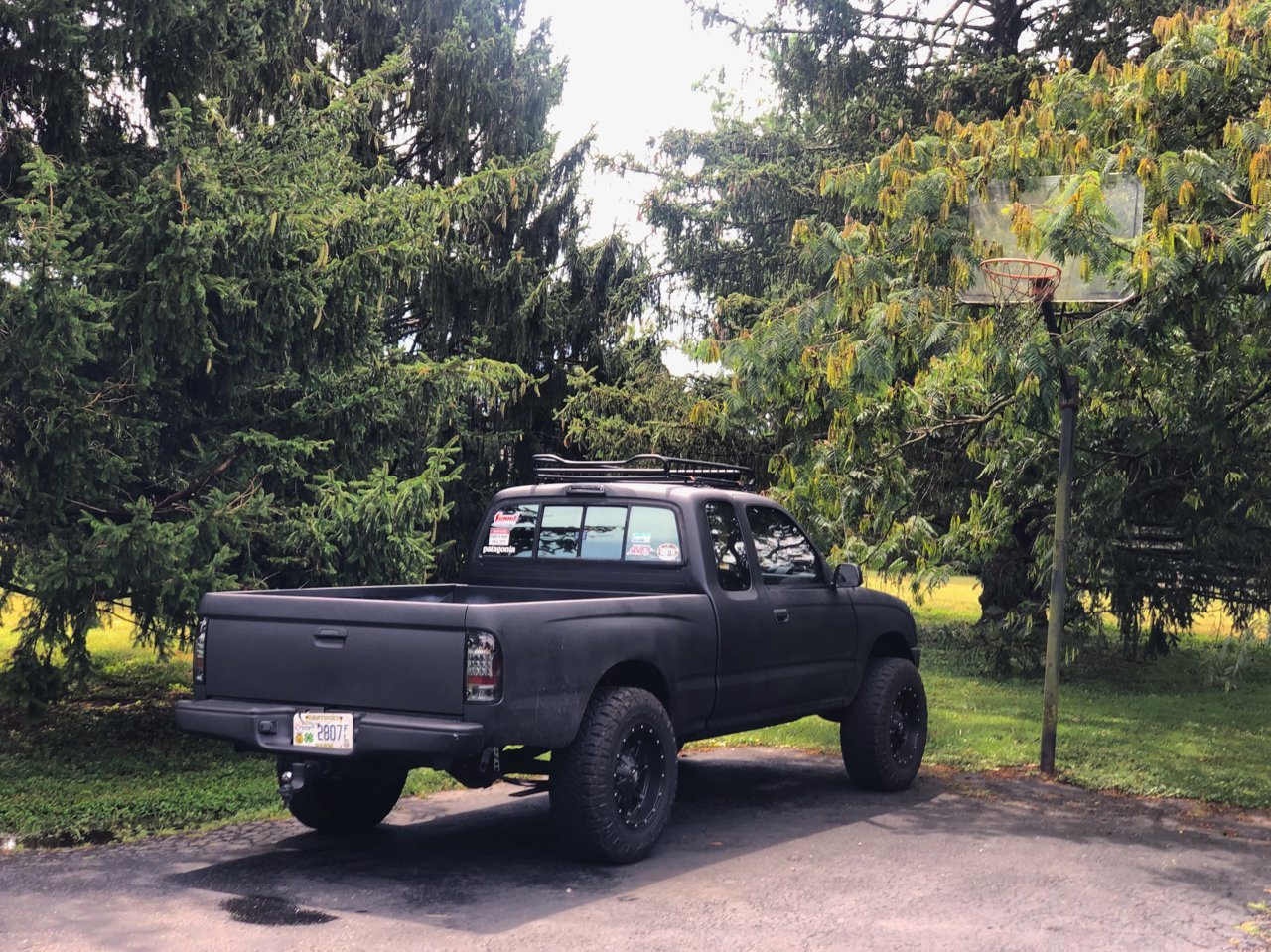

    Got my roof rack installed finally! Used smittybilt roof rack mounts and used the stock hardware although i have plans to replace them with rivnuts in the future
    I really think it brings my truck together more imo
    DA976150-F149-40B8-8461-963E1055C464.jpg E6FEBFB3-79DE-405D-814C-CA13A6D4F024.jpg EEA89C0E-D7C6-47F1-8714-A1EC2D19A7FA.jpg 8FB8662E-8076-41CD-BCA5-4AB02F8BB3A9.jpg BD03C013-1B9E-4281-B0E6-15D13D38CF10.jpg
    Current configuration is temporary. I just wanted to get it on there and it is very solid as is, but has room for improvement.

    yep:bananadead:, kit came with welnuts that i placed in the roof and then applied silicone around all the edges. It rained this morning and have no leaks so far

    Headliner stayed in and got messed up by my careless drilling but i plan on having it replaced in the future anyways so i didn't bother attempting to take it out
