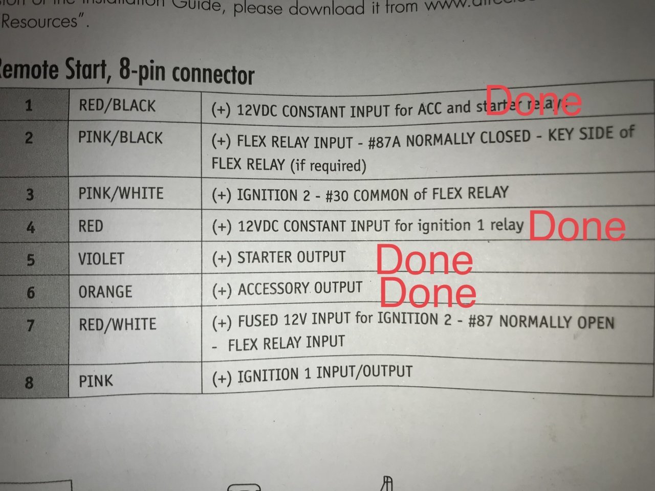

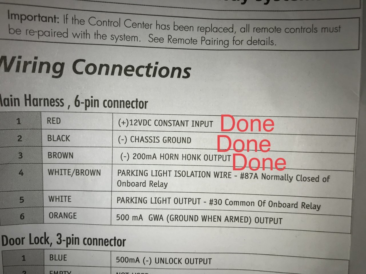

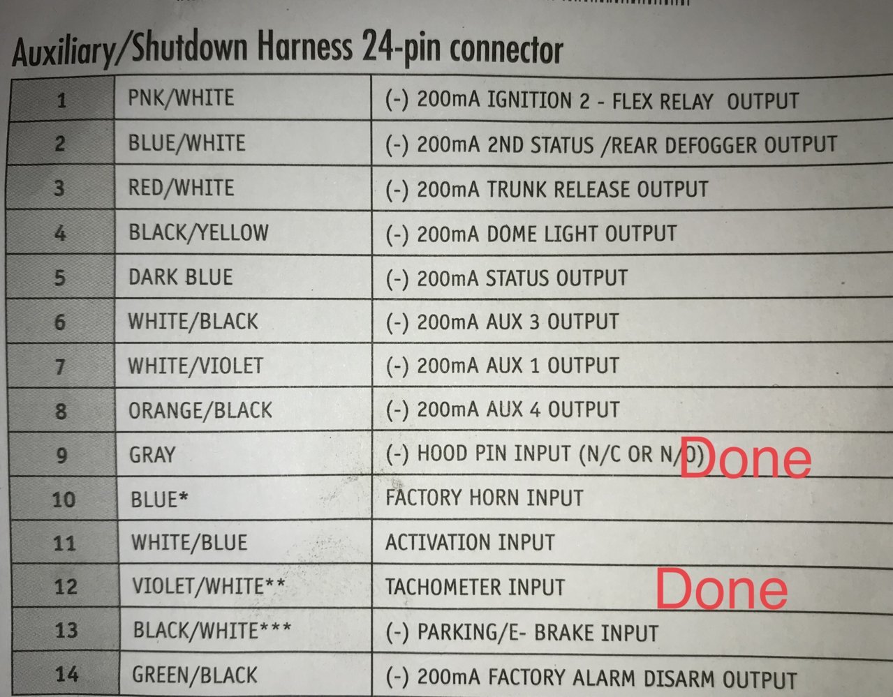

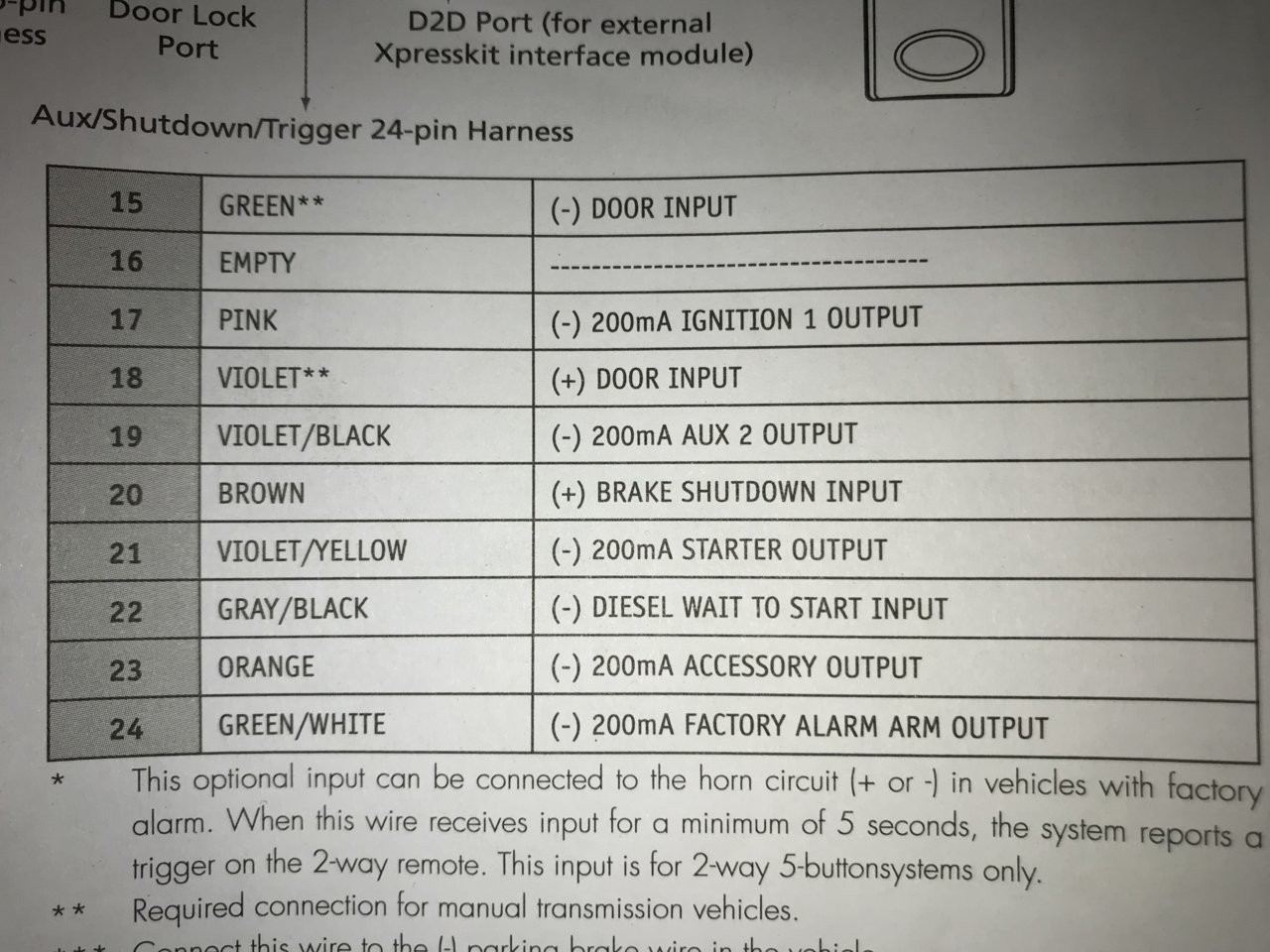

    Thought I’d be cute and try to self install Viper 4706 remote start...if I know which wire taps which, this isn’t difficult. But there’s stuff I have no clue what I’m to do with...
    2004 Taco Double Cab 4x4...
    Any help would be appreciated
