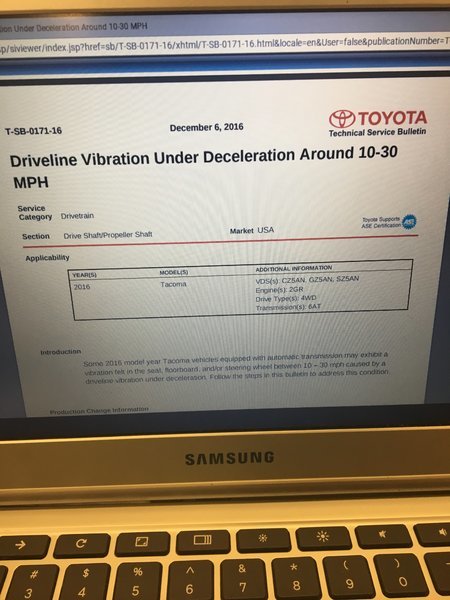

    looks like i'm going to be busy for a while with this one.
    (attached TSB)

    Why would this apply only to the trucks with automatic transmissions? Nothing about it seems to be specific to the transmission and manual transmission trucks suffer from the same problem.

    What's the proposed fix?

    TSB shows new leaf packs and a steering wheel damper.
    I agree with @fdbyrne , it's odd to exclude manuals.

    Interesting it says not applicable to any off road....did all 2016 TRDORs already have the springs?

    I've felt this for a while now, thought maybe it was the drums. But the TSB points to
    my exact issue when coming to a stop right about 30mph till I stop it shudders. Just
    made an appt @ the dealer, I'll have to ride with a master tech, he'll evaluate and decide
    if he feels what I do, then order the appropriate parts then reschedule for the repair.

    There is a note in there: "If the vehicle has an aftermarket suspension/body lift or leveling kit installed, this bulletin does NOT apply." Its possible that would make you ineligible.
