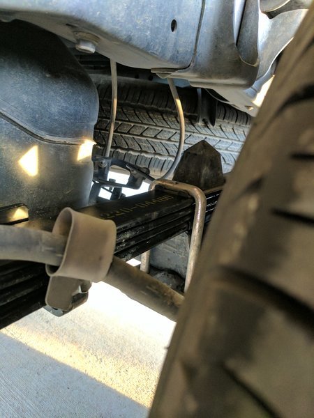

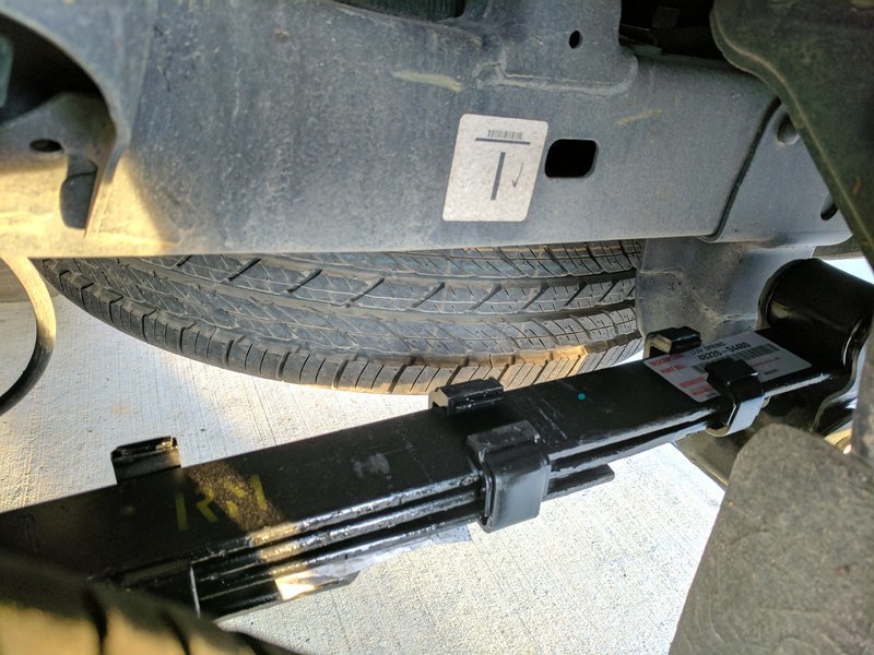

    The parts arrived for mine and it's going in Wednesday for the repair.

    2016 TRDORAC4WD
    So I had new leaf springs and the steering damper installed as part of this repair on Wednesday. The vibration that occurred between 25-15mph when slowing is nearly 100% gone. If I hadn't had the problem before and wasn't searching for it now I am sure I would not notice anything. Also feel that that the clunking that occurred during slowing and downshifting is also greatly reduced though I'll need some more drive time to quantify how reduced it is.
    Going to the service department is a patronizing circle jerk but I am happy with the results.
