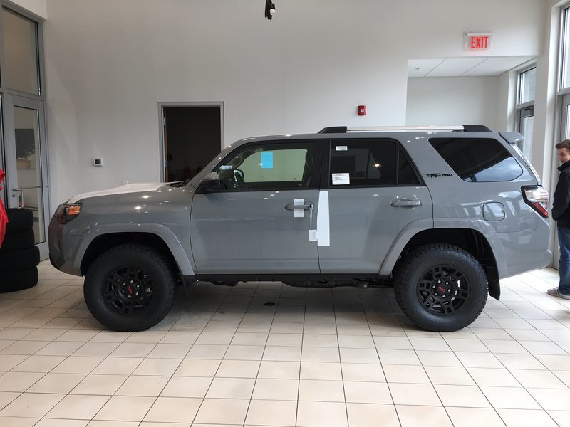

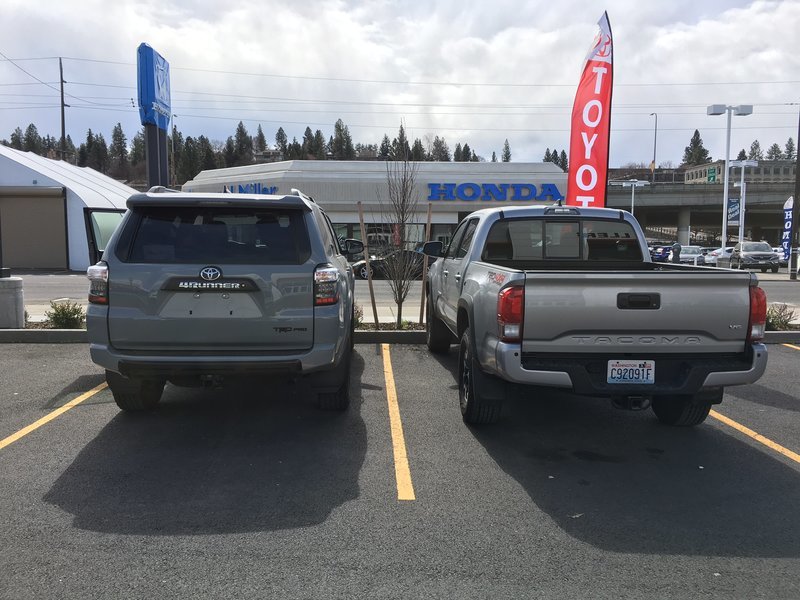

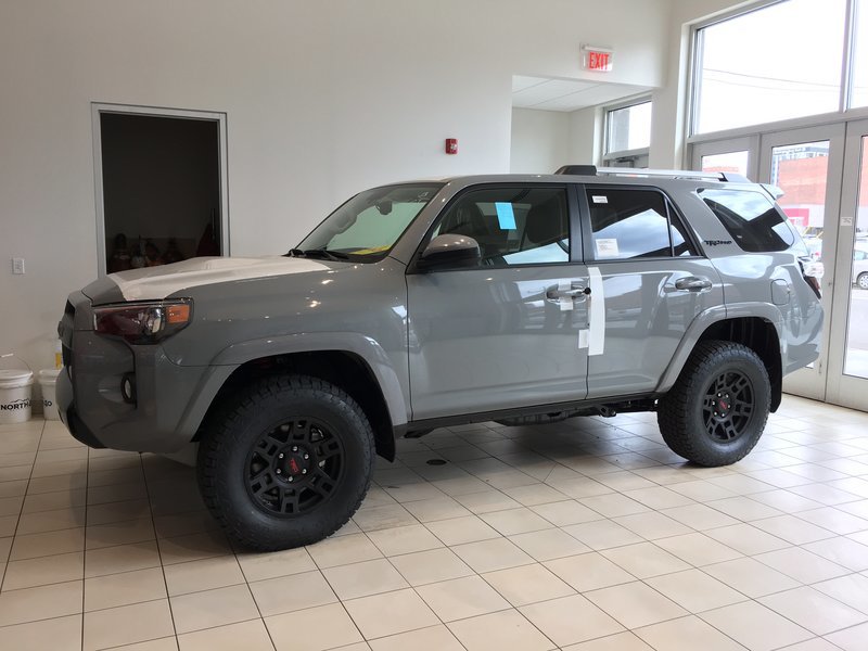

    Good Luck Guys, I had had enough... Took delivery yesterday with 2 miles on the ODO.

    Absolutely beautiful!!!! Enjoy!
