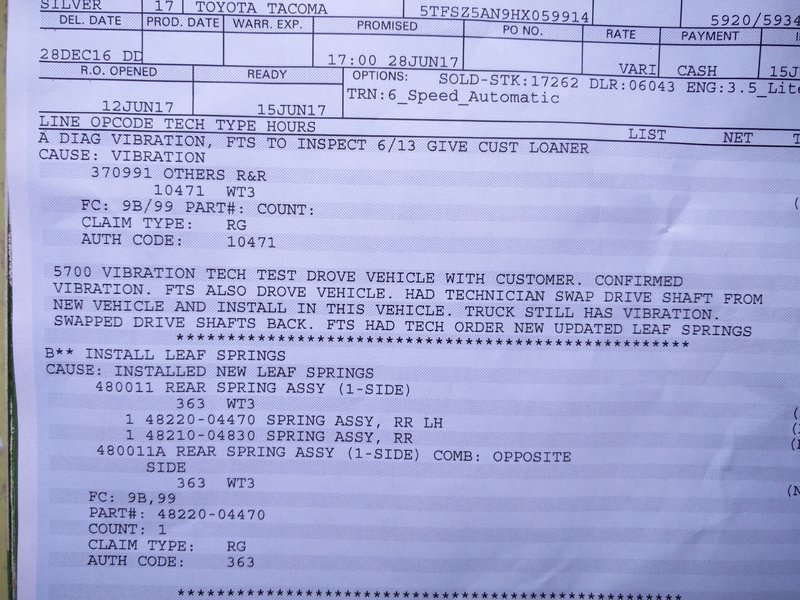

    finally got the vibration fixed. First trip to dealer, was told its normal. Called Toyota corporate and started a case file. Called them occasionally. Finally had a good teck at the dealership compare mine to another. Verified abnormal vibration. Field Service Teck visited and agreed. Swapped driveshaft but didn't work. Updated to new leaf pack with shims which changed the geometry of the drive train.driveline vibe.jpg
    It took a while but the polite complaining paid off.

    When were you experiencing the vibration?

    between 20 and 40 mph. and more pronounced when breaking within those speeds. Just like the TSB said.

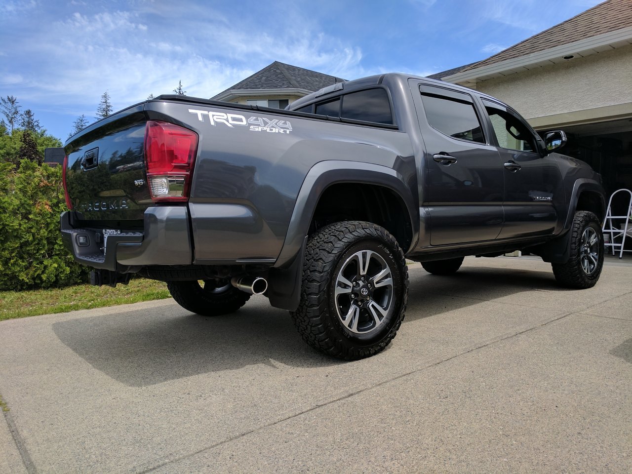

    Do yourself a favor like I did. Get some tapered blocks to tilt the pinion up a little. It got rid of my rumble strip vibs when coming to a stop. Reason I know it works as I had no tapered blocks installed when I first lifted the rear of my taco. Installed tapered blocks and my vibs are goneIMG_20170625_132321.jpg

    Thank you for the recommendation. Would you mind sharing your source for these blocks please?

    I got mine from low range offroad
