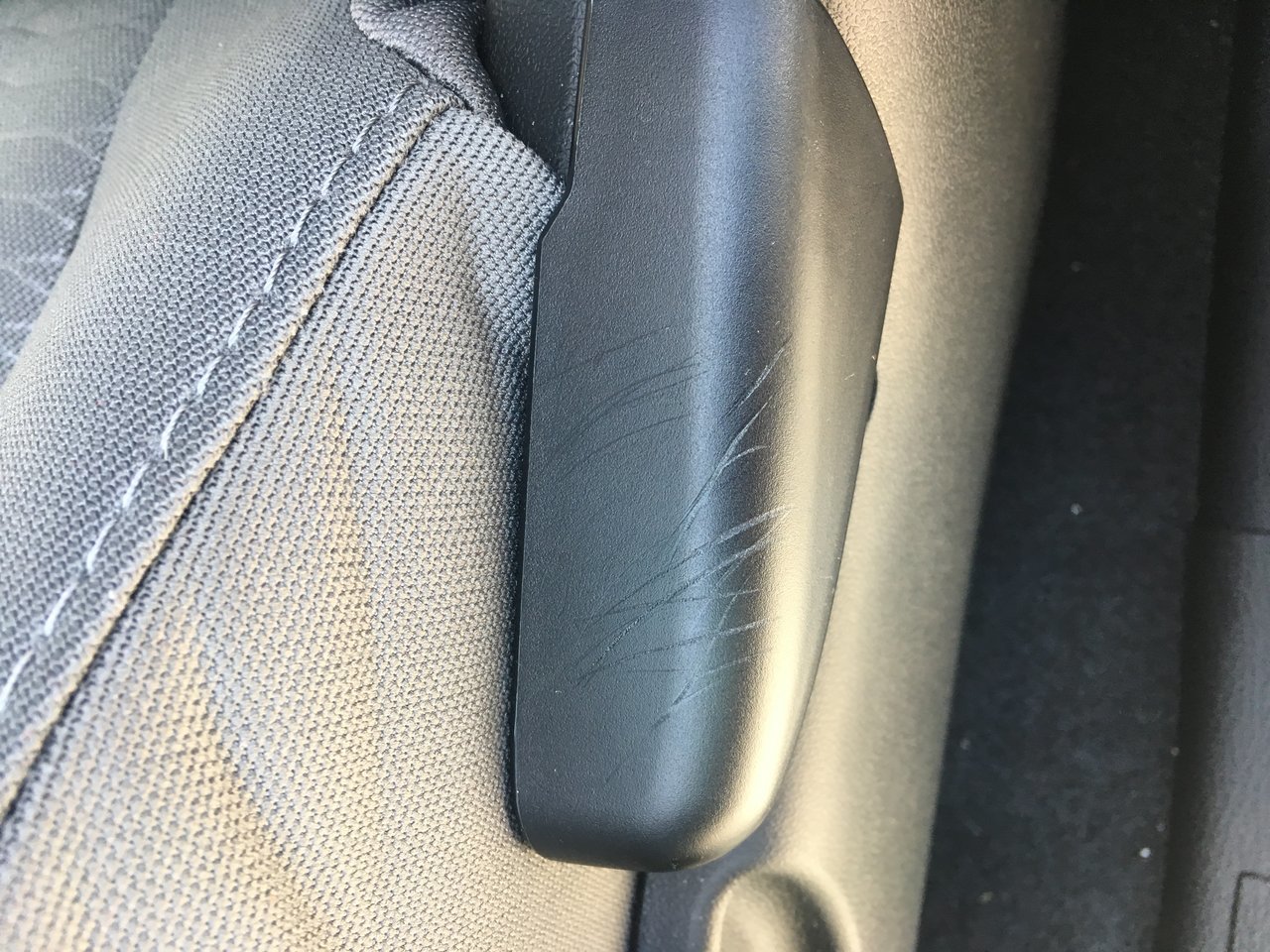

    got it done...my dealer is..ok. Got the leafs and the damper. Fixed it maybe a little, but it’s still there. AND when I got it back it had a bunch of scratches on my seat decliner level?!?

    Here’s the scratches...Zero clue on how those could get there while my car was at the dealer...
